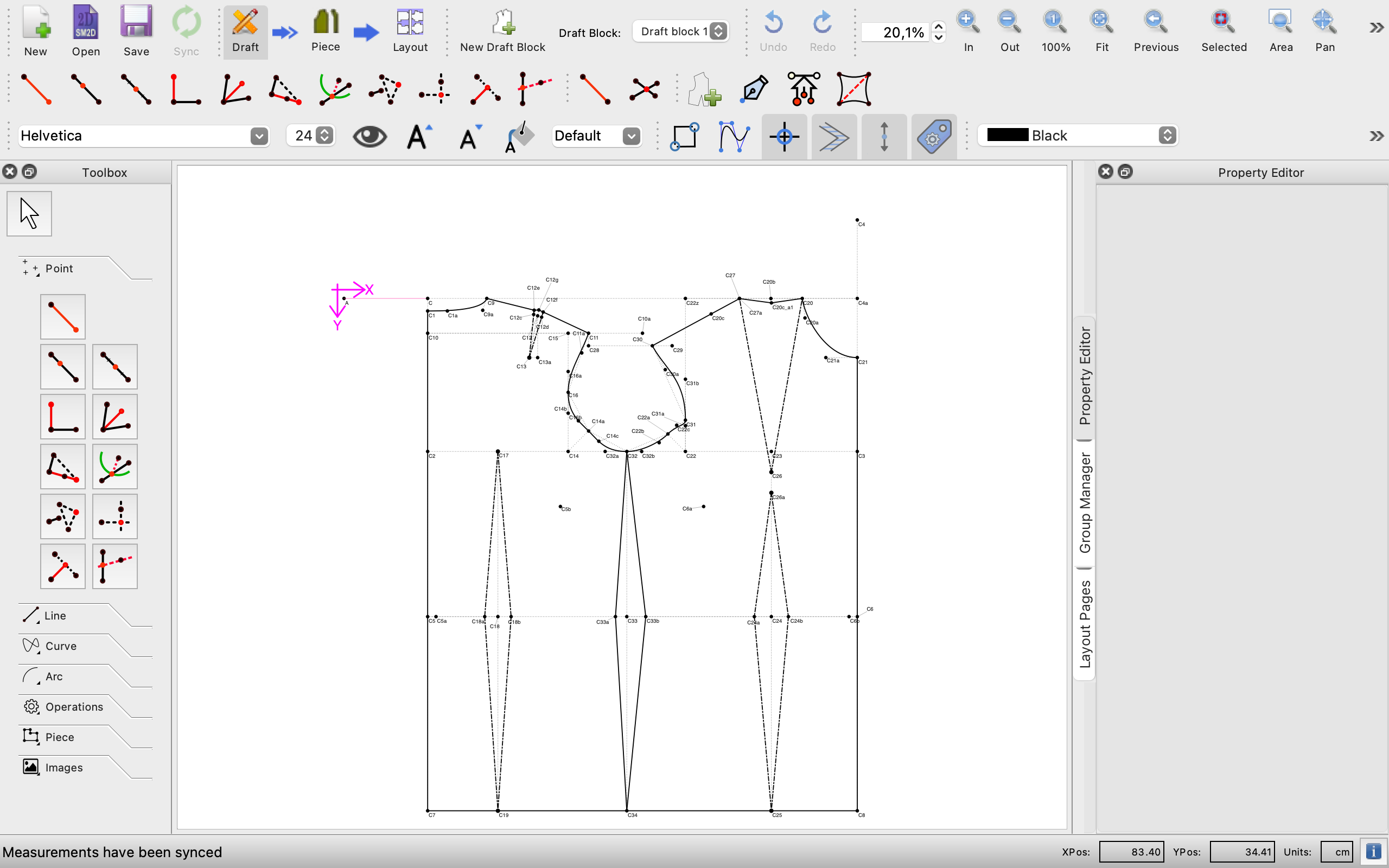

I just purchased the patterns and I tried to change the measurements. However, my bodice looks wacky. Any advice? The armscye looks strange. And based on my measurements, I normally need a hip curve overlap. Does Aldrich not do this? And is there somewhere in the program a list of all the equations used in said pattern with their relative points so I can understand what I want to change or where the error might be? Any help would be greatly appreciated!

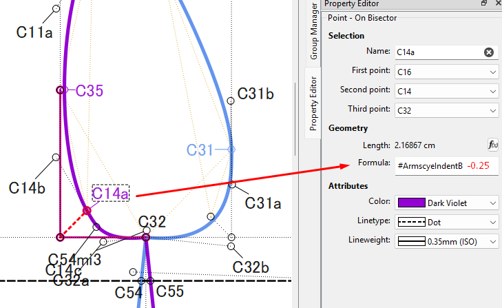

For the armhole… at Points C14a & C22a, deduct 0.25 from the formula in these until your curve looks better. It’s not the correct way to repair this, but if your measurements are correct, then it may be necessary. I won’t know until I see your file with the measurements.

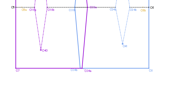

Also, my waist darts don’t extend all the way to the hem line:

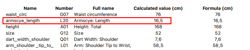

Check that this measurement is correct:
This is measured from the neck back (nape of neck) to the armhole level and is actually the Armscye Depth measurement.

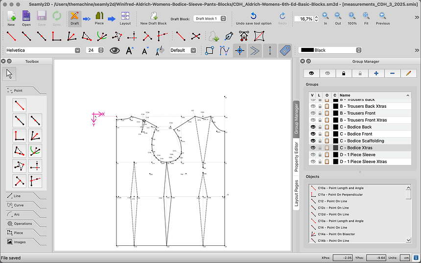

I forgot to reply to this part earlier. Everything in the pattern is dependant on the SeamlyME measurement file and the Variiables Table. It’s not advisable to actually change the formulas in the pattern, but to rather adjust the ease items in the Variables Table and to make sure that the SeamlyME measurements file is 100% correct.
Other than that, you can save the pattern to a new name and rotate sections to close darts in one place and open up other darts in another place, draw in a new neckline, add closures and plackets.
When you load different measurements, the pattern should resize accordingly and if you add your design features on top of the existing pattern, they should also resize accordingly.
You can find a list of each point created, along with the formulas in the Menu > History.

…I changed the measurement and subtracted 0,5cm from armscye indent and it seems ok!
