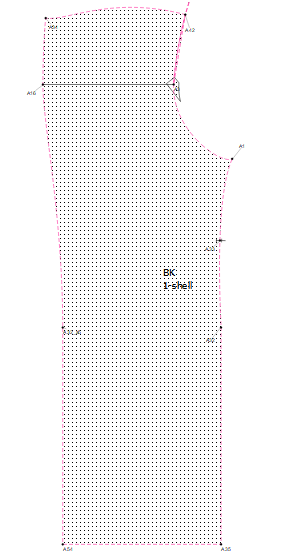

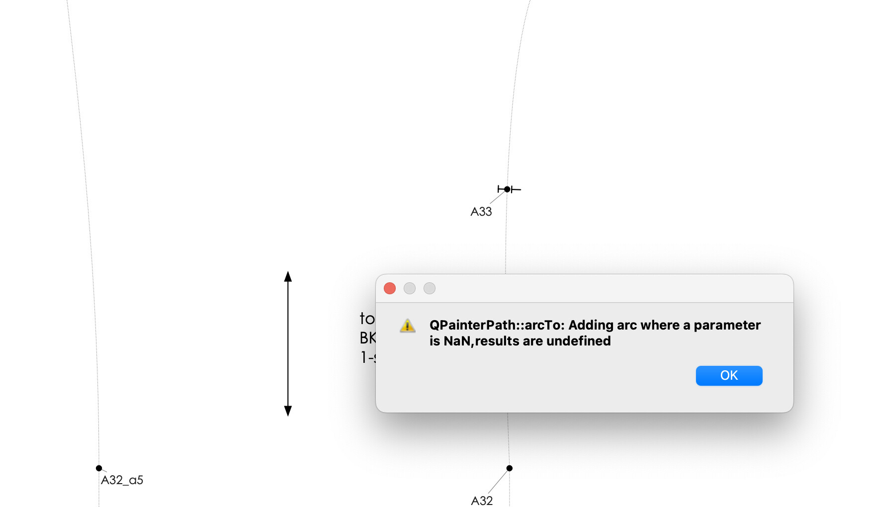

i’m encountering a new error when i add new points into a pattern piece. i now can’t use the file at all because it keeps popping up with the error.

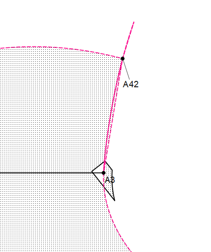

Ok… it was easy enough to figure out… points A42 and A3 were not in the correct order.
When ever you see two curves without a point in between it can usually mean an issue. Also to note… since the piece path was messed up I had to resort to using the Edit button in the Pattern Piece dock to fix the path:

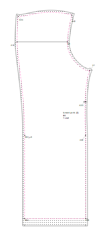

tomomi pants_fixed.sm2d (27.5 KB)
thank you so much!!!
also very helpful to realize that i can edit. I couldn’t figure out how to do that or delete the pattern piece.
