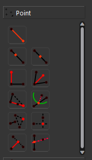

Using the xfce Desktop Environment, I think it looks pretty good:
I could see it being annoying on an off-day, but the red on the tool icons does a lovely job of indicating what they are. However, the show/hide all pointnames icon is nearly invisible, "Oh, that smudge there is probably that one eye icon that I mostly ignore anyway. :person_shrugging: "

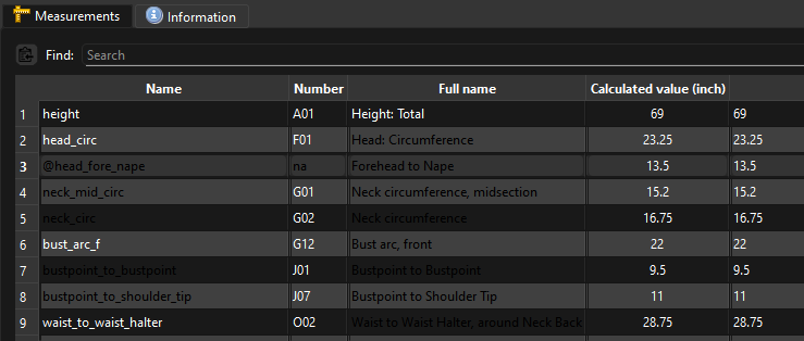

I hadn’t… Eugh! The text of search-hilighted items needs to invert to black to be visible, or the hilight needs to be dark enough for the white text to show. The section labels for adding known measurements are also a little unclear. The measurement diagram doesn’t integrate harmoniously (ETA: but it works, & that would involve doubling the number of pictures, or having a way to dynamically alter their properties.)
but other than that it looks good at a glance-over.
Ahh… good point. Agreed - looking at the Windows ver now. The search highlight color is hardcoded so I’ll have to take note of that and switch the hightligh color or the text color depending on mode.
Noted. Same issue as with the search. Not sure if that highlight is a palette coor or if it’s hardcoded.
Yeah… the diagrams are SVG’s. I could live with the white background… what we can’t live with is any white text on a light back ground or black text on a dark background.

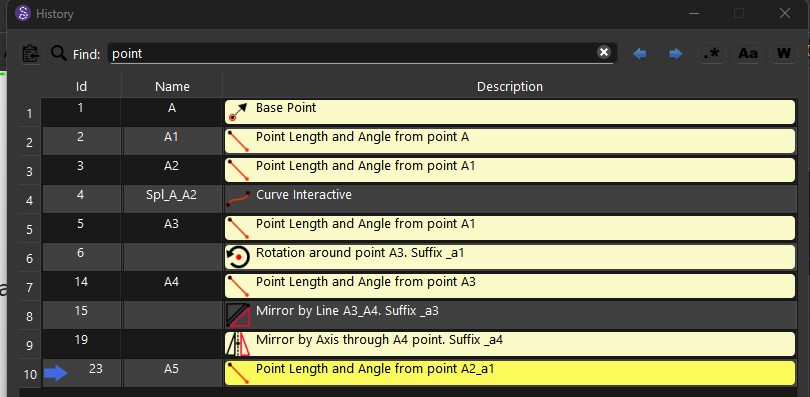

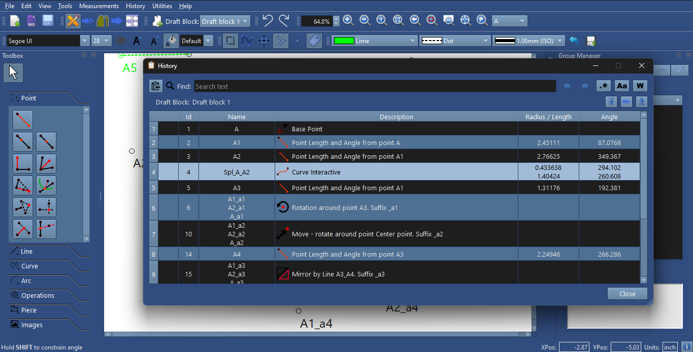

UPDATE: Fixed a bunch of palette colors for dark mode.
Found search items text is now black:
Also fixed the header items in the History dialog… now white on lightgray:
Top level text color is now black:

I found another minor issue that popped up… In ME After searching and clearing the search text, the previous search cells are left with black text, and are not reset back to white. This only happens in ME and not the History dialog which uses the same VTableSearch class for searhing.
The clue resides in the fact that the “NA” cell didn’t revert back to white, which is not part of the search results. Hmmmm
Fixed. Cells now revert back to white text when the search is changed or cleared.
Search:
Search cleared:

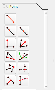

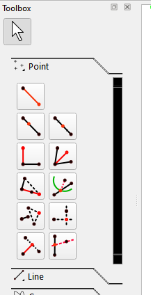

When switching from Windows 11 to Fusion Light the scroll bar in the tool box turns black:
Very odd as here’s the scroll bar in Windows 11 Dark mode:
Restarting the app fixes the issue… but don’t know why it’s changing that palette color?

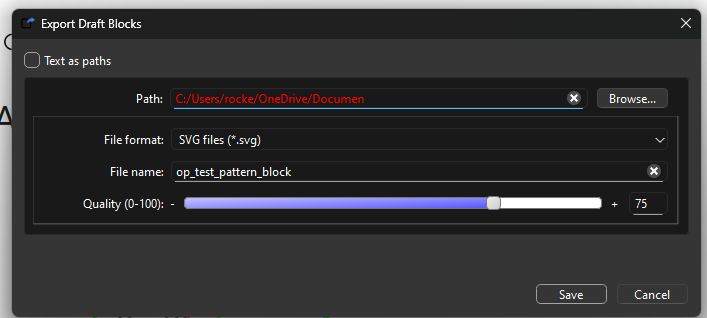

The other one I fixed… The Path for the Export dialog was black in Dark mode and stayed Red after making a valid entry after an invalid change was made:
Was tricky because I had to make a member copy of the foreground color in the constructor to be able to restore any change to red.

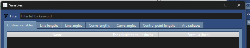

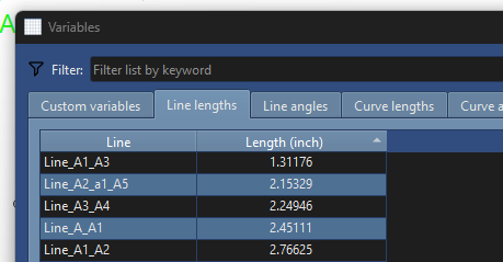

Found another background color conflct… the header for the Variables Table Custom variables tab:
The other tabs are fine:

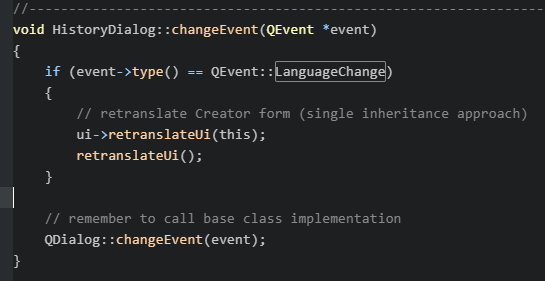

Point taken. It would require sending a signal from the Preferences and connecting it to other dialogs telling them when the theme has changed and they need to refresh. It’s the same issue when you change languages and the dialogs need to refresh. Most have a changeEvent() and they listen for a change in the language setting:
To simply things I could probably just use the built in changeEvent() handler rather than a custom signal / slot, by using QEvent::ApplicationPaletteChange signal… which will be emitted when a setPalette() is performed in the application class.
Like adding:
if (event->type() == QEvent::ApplicationPaletteChange)
    updateHistory(true);

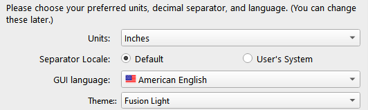

Just to recap the main “visual” change in the next release… you will be able to select a Theme (stlye / palette) in the Preferences or the Welcome dialogs.
For Windows your choice of themes will be:
  • Fusion - Light
  • Fusion - Dark
  • Fusion - Twilight
  • Classic - Light
  • Windows 11 - Dark
  • System - Fusion (Light or Dark depending on system palette)
For Mac and Linux:
  • Fusion - Light
  • Fusion - Dark
  • Fusion - Twilight
  • Fusion - System (Light or Dark depending on system palette)

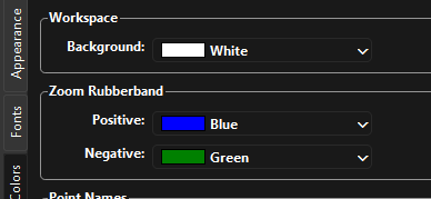

Also keep in mind to simplify the use of Dark mode we chose to keep the background color of the main “canvas” in Seamly2D a seperate option rather than the default dark grey you would normally get. This avoids the messy issue of having to flip black lines and points to white on a dark canvas… and vice versa. Choices for background colors are:
