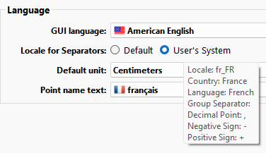

After fixing the locale issue for Qt6 I realize the text for the pref “Decimal separator: < User locale >” is a bit of a misnomer. This does not direcrly set the decimal separator, rather it determines what locale is used by the GUI for the input / ouput of numbers. The locale determines what decimal & group separators, positiveSign, negativeSign, exponent, 0-9 digits chars are used. And while the decimal separator is usually a period or comma, the group (thousands) separator can vary between the comma, space, non breaking space, and narrow non brealing space.
So currently the prefs are:
Unchecked the C Locale is used, Checked the user’s system locale is used.
IMO it should be:
And the rollover tooltip for each radio button could then display the locale options like it does in the About dialog:
And yes… to the observant: For testing purposes I figured out how to fake the app into thinking the user locale is somewhere else without actually changing my laptop’s system locale setting. :slight_smile:

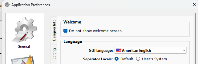

I’m not sure that “Standard C” would make sense to very many Seamly users, but I’m having trouble thinking of a better way. Maybe “Default: . - +”?

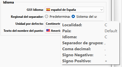

IMO semanitcally it needs to say it’s setting the locale… not the actual separators and chars. Here’s what I’m working on:
And since there are only 2 radio buttons I can treat it like a checkbox and not have to change all the settings code - which would be another PITA. I’ll also format the tooltips better, and display a name for a space, non-breaking space, or a narrow non-brealing space which otherwise does not show anything visible.
Okay, yeah, I think that does a great job of addressing my concern. Thanks!

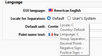

I put the tooltips in an html table, increased the font size, and did all the translations:
And with that I think the Qt6 branch will be ready to test.

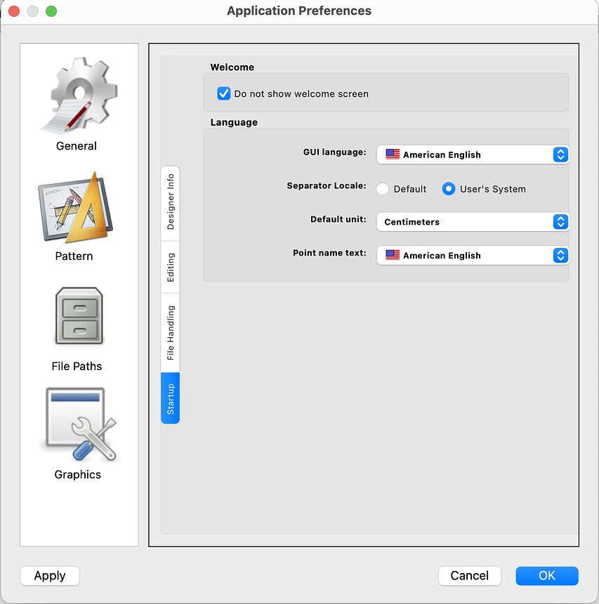

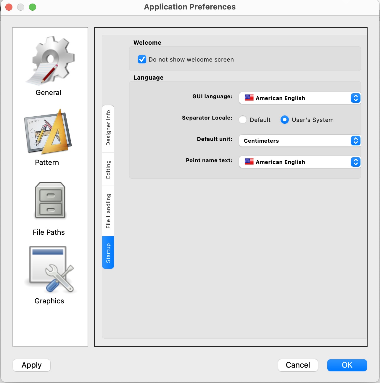

Besides testing the Mac build - if you could check the setting for the Locale separators that would be great. For you there should be no difference between Default or User’s System setting… other than we hope the QTextCursor error is fixed if you use the User’s System setting. In which case we can close the QTextCursor issue on Github.
Thanks.
For sure, ill download now and get back to you on this.
The menu is looking good, definitely clearer

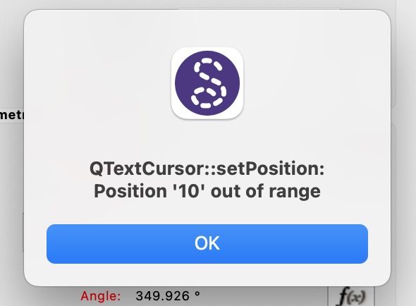

However, strangely I am getting the same Qt error message that I was experiencing.
edit: i think this
Edit: I think this issue was present in the last update too. But prior to that this had seemed to have disappeared
Ok… that answers that question. I guess for now you’ll have to stick with the Default locale.
Weirdly I’m getting that issue even when I change to default locale also.
