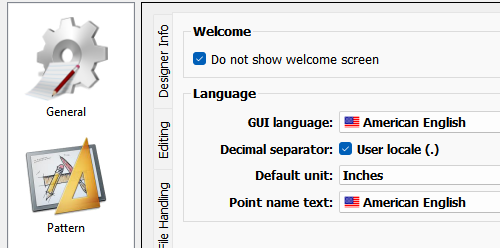

Try changing the decimal seperator settiing.
Hi,
Unchecked this setting on both Seamly2d and Seamlyme and still no luck

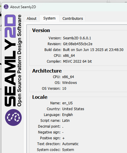

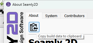

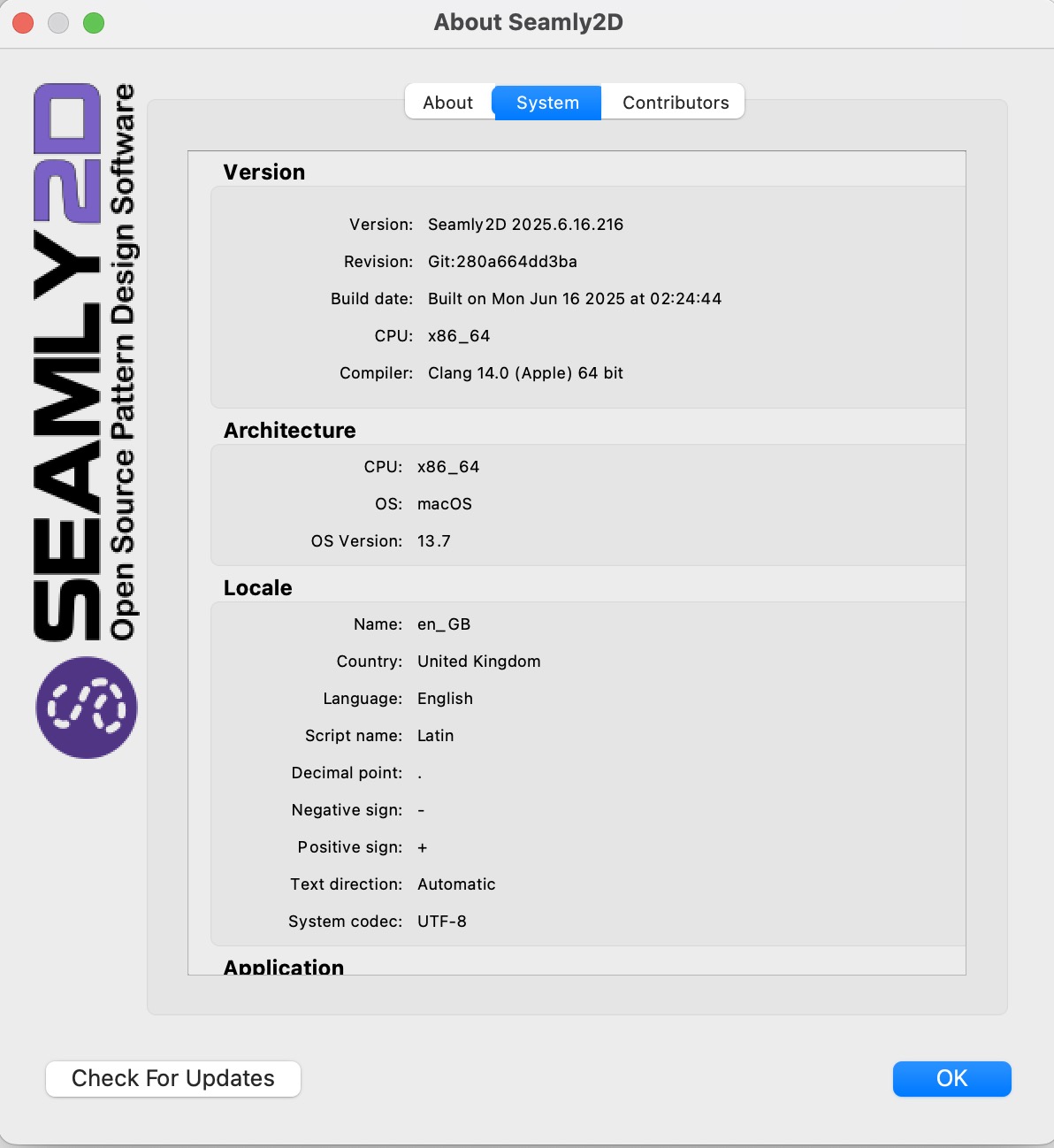

Let me ask do you know what your locale is and what language you have set in the prefs? Of better yet if you can just copy the system info from the About menu and paste it here OR Screencap the System locale info:
I’m almost sure it’s related to the locale & decimal point.
Thank you,
Of course i’ll get that posted on here now

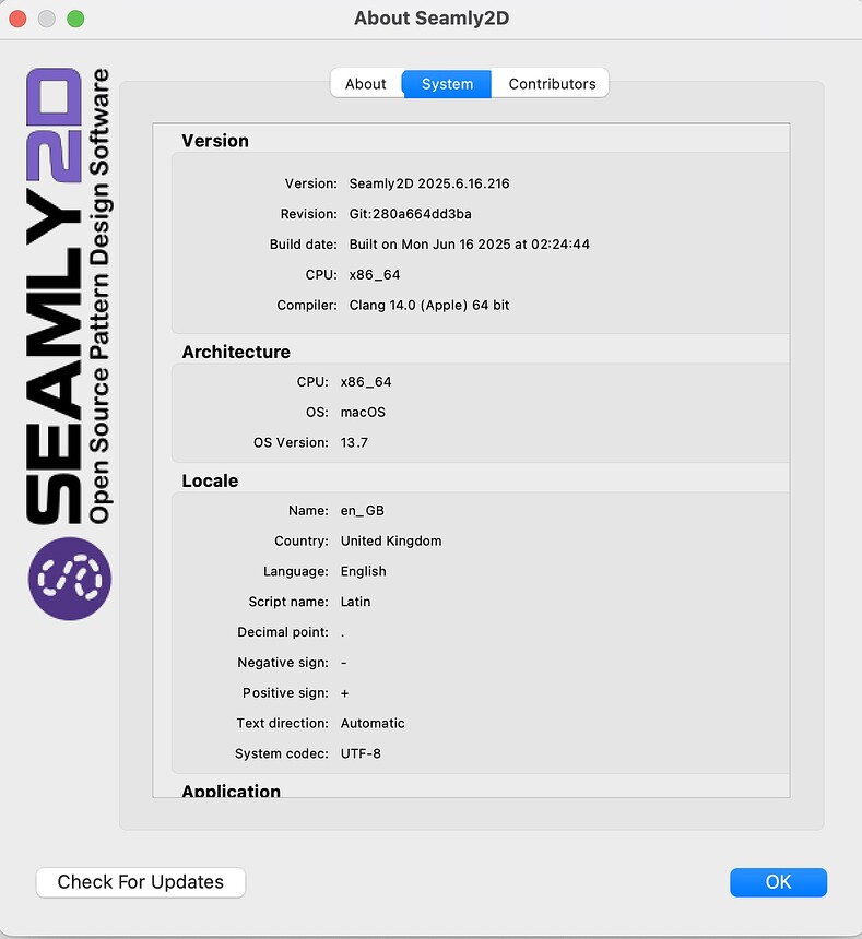

Here it is…
Seamly2D version: Seamly2D 2025.6.16.216 Build revision: Git:280a664dd3ba Build date: Built on Mon Jun 16 2025 at 02:24:44 Qt Version: 5.15.2 CPU: x86_64 Compiler: Clang 14.0 (Apple) 64 bit CPU: x86_64 OS: macOS OS Version: 13.7 Locale: en_GB Country: United Kingdom Language: English Script Name: Latin Decimal Point: . Negative Sign: - Positive Sign: + Direction: Automatic System Codec: UTF-8 Arguments: /Applications/Seamly2D.app/Contents/MacOS/Seamly2D

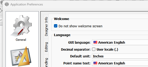

FIXED!!
Funnily enough, all I tried was unchecking the decimal point setting, and no issue now! :partying_face:
