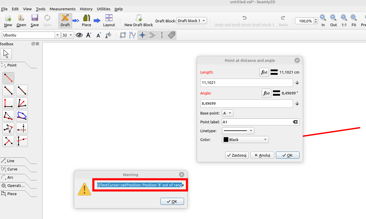

I tried to draw my my first line but I can’t. QTextCursor::setPosition: Position '8' out of range is displayed after clicking Length input. Analogous message is displayed when Angle input is clicked. There is nothing I can do about it - after clicking OK message reappears. I can only kill the program from process manager.

Because you’ve used the comma instead of the decimal point. In other words you’ve turned 11 into 11 thousand… out of range.
Have you set your prefs to account for using the comma instead?
The preference is found under the Language tab in the General panel of the Application Preferences dialog.
I am very curious about if that has an effect, since I am unable to duplicate the issue over here. If I try changing a “.” to a “,” I don’t get any errors, I’m just not allowed to press OK before I fix it.
Actually I did not enter this value. It was already there after I had drawn some random “point” with mouse.
I have unchecked Decimal separator, now this window has values with decimal point but that makes no change:
obraz
AppImage version works exactly the same.
Hmmm… on 2nd look - it appears related to line edit textbox, and for some reason it can’t set the cursor to the end of the text… 7 chars - next position is 8.

After reinstalling from scratch (flatpak uninstall --delete-data net.seamly.seamly2d) these are the default setting of application: obraz
Changing this to GUI Language=American English and Label language=American English makes no changes.
Unchecking Decimal separator makes no change according to error.
Starting with different tool - arc produces the same error: obraz
In ‘Point at distance and angle’ dialog ‘Point label’ input does not exhibit issue (I can click on this input and write whatever I want), only ‘Length’ and ‘Angle’ are affected: obraz
BUT: trying on the other computer with Mint 21.1 which I use as a multimedia computer it works fine :confused:
Now I discovered that clicking with mouse exactly on the digits does not trigger the error, while clicking somewhere on the white area of the input box triggers it immediately: obraz
Moreover if I click on the digits, the cursor shows in the input, then subsequent pressing right arrow moves the cursor to the right and eventually already known setPosition: Position ‘8’ out of range message` pops out.
