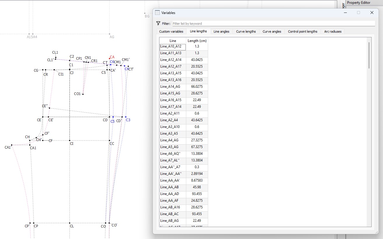

Block A (bodice) below.

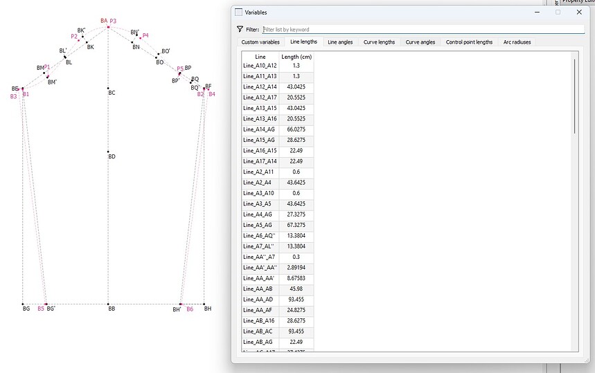

Block B (sleeve) below.

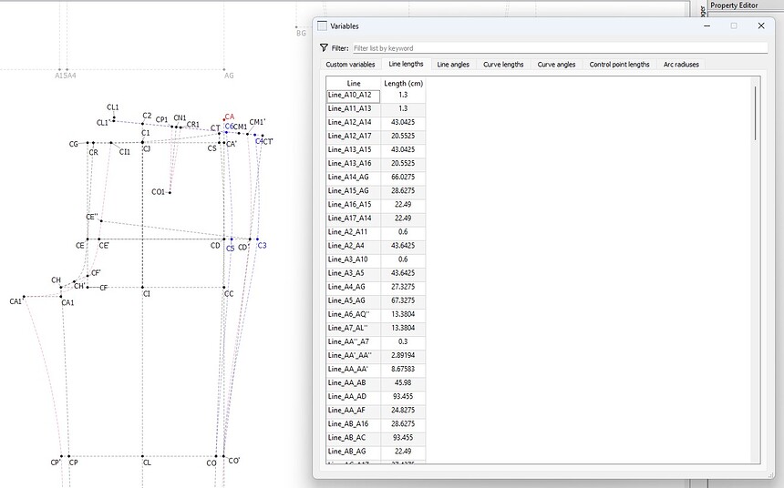

Block C (pants) below. Notice the side scroll bar is the shortest because it also includes points for block A and B.

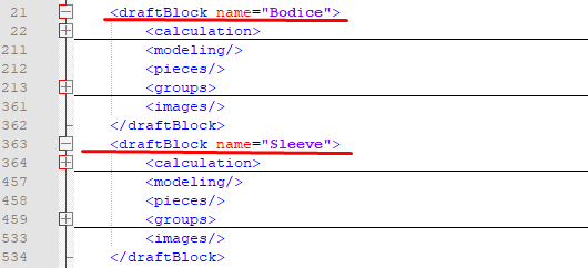

Here I’ve minimized the different sections so that you can see the order that things are saved in:
These are always read by the software in a completely linear fashion from top to bottom and this is why we have the History tool that we can use to insert an object at previous point so that it can be used at a later point, but if it’s in a different block, it will always remain in that block.
