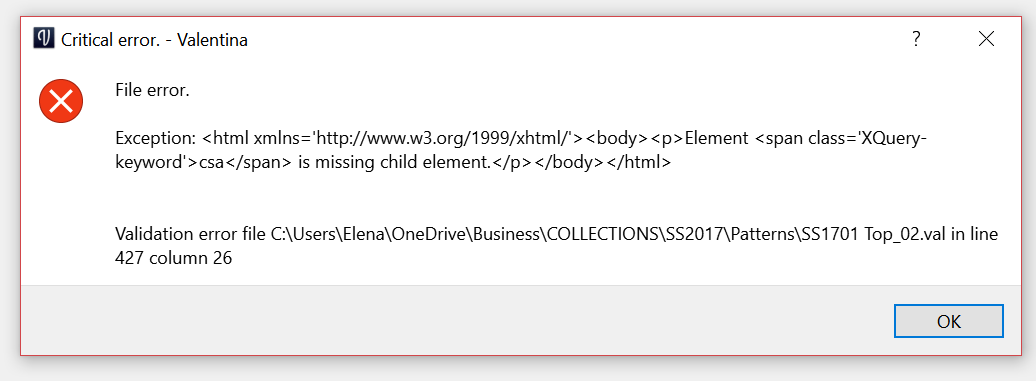

However, after successfully saving the files in this new test build, I am unable to re-open them and getting the following error:
Any idea how I could fix it?
It is such a pity, cause the new tools are wonderful, but I´m losing to this error all my work:(
@Elena, please send me the pattern and measurements if need.
Thank you very much for such fast reply! I´ve just sent you the files as a message.
Yes, i saw.:slight_smile:
@Elena, sorry, can’t publish new test build today. travis-ci.org where we build Mac OS has some troubles. When they will fix them i will publish a package.
