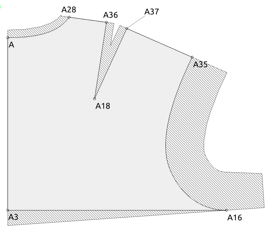

Here is how look a piece now:
Left two stages to complete a seam allowance (an angle type and manual seam allowance) and i will go to internal paths.
Known issue. Import from old pattern format still doesn’t work.
Leave your comments and questions.:slight_smile:
