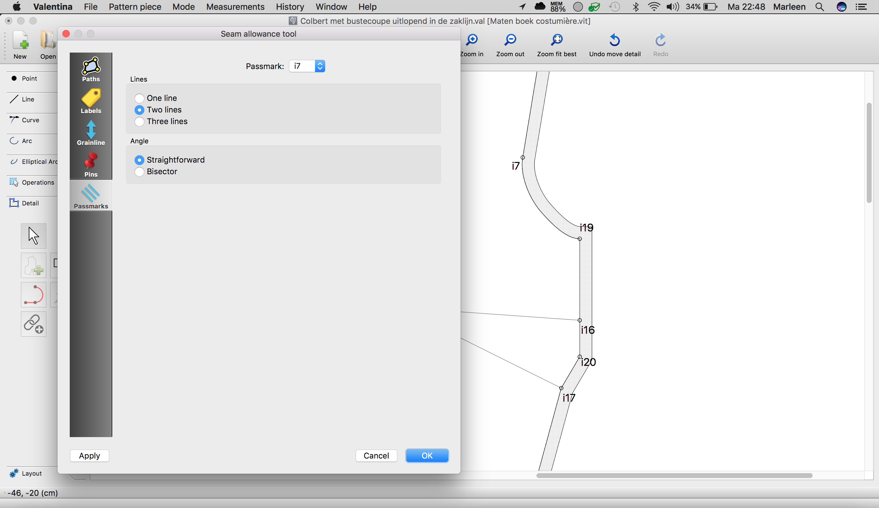

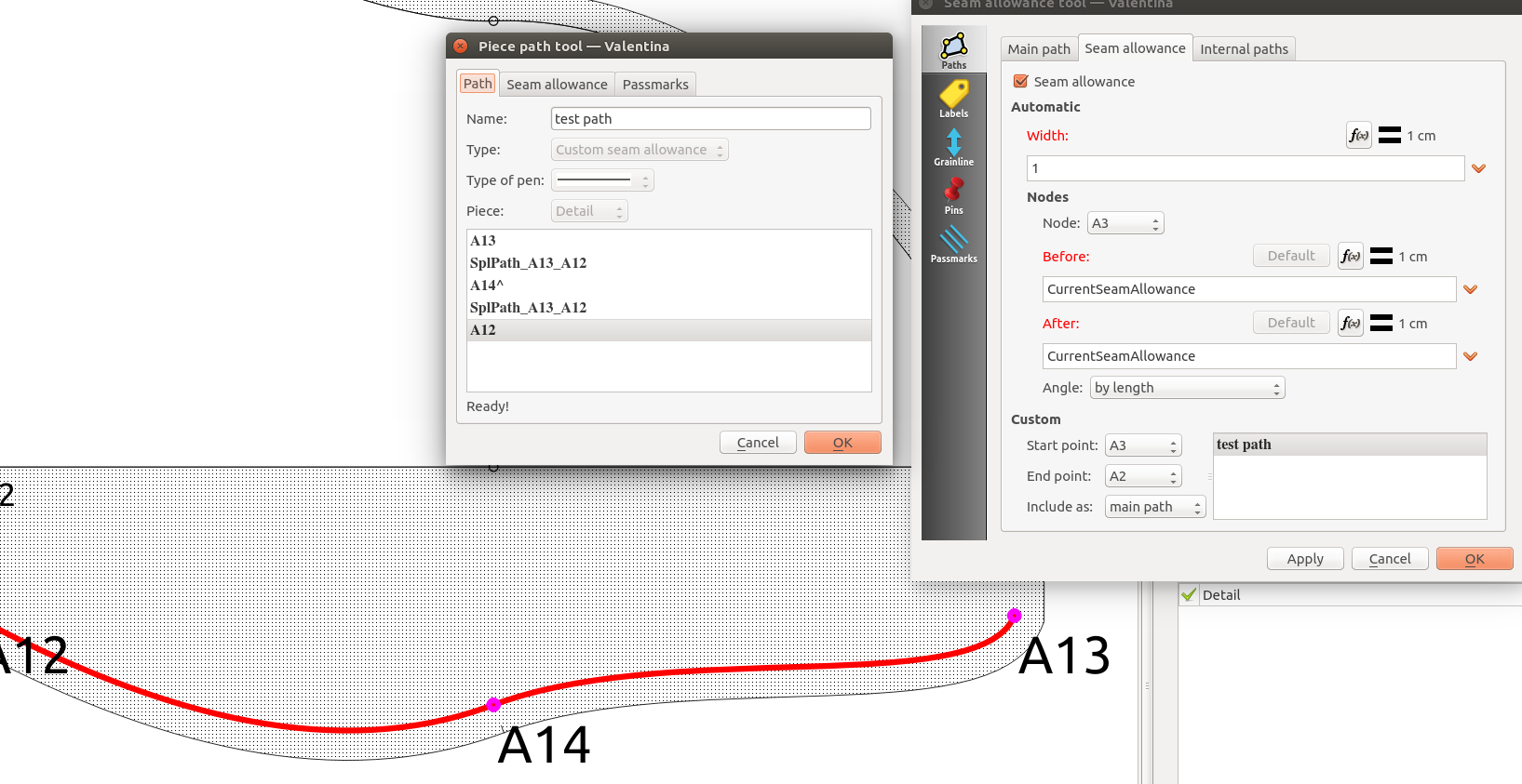

Finally. I made a passmark!
Several screenshots:
These changes will be available in next test build.

Great work. This is so good! I tested the internal paths and the passmarks. Internal paths are working great, but the passmarks don’t show unfortunately. May be I am doing something wrong.
Please, send me the file.
Here is my file. Thank you.Colbert met bustecoupe uitlopend in de zaklijn.val (89.9 KB)
You forgot to add measurements file Maten boek costumière.vit.
Maten boek costumière.vit (1.6 KB) Excuse me.

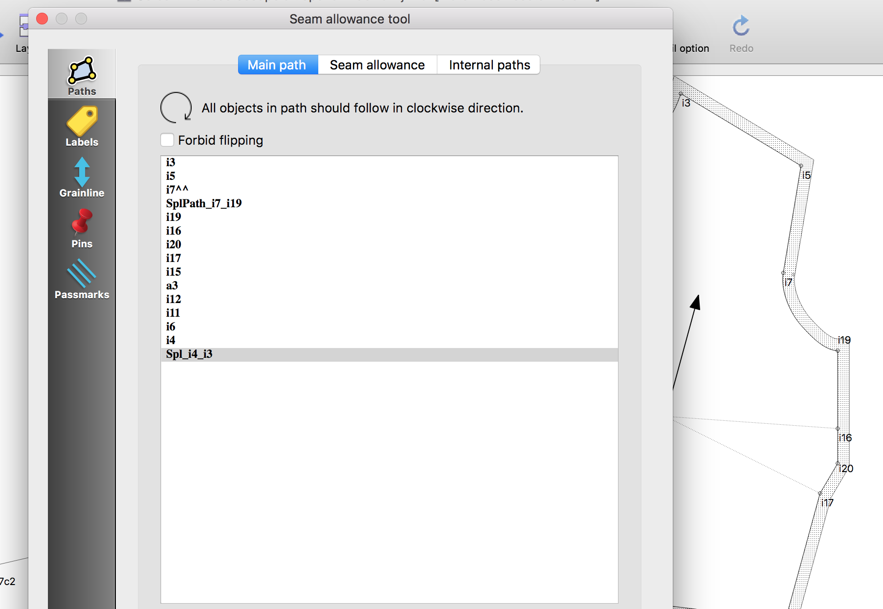

Do you know what means strikeout font?
Is it this: the point is a point mark with a double line? But on detail mode and layout mode I see no line or double line.
I think you don’t understand what’s it means.
The strikeout font means this node is excluded. Excluded node will be not shown on a detail. Find correct position for the node in a list and change status to not excluded.
Again. You don’t see a passmark because your point is excluded. And is not visible on the detail.
Oké, I changed it but is still doesn’t show.
