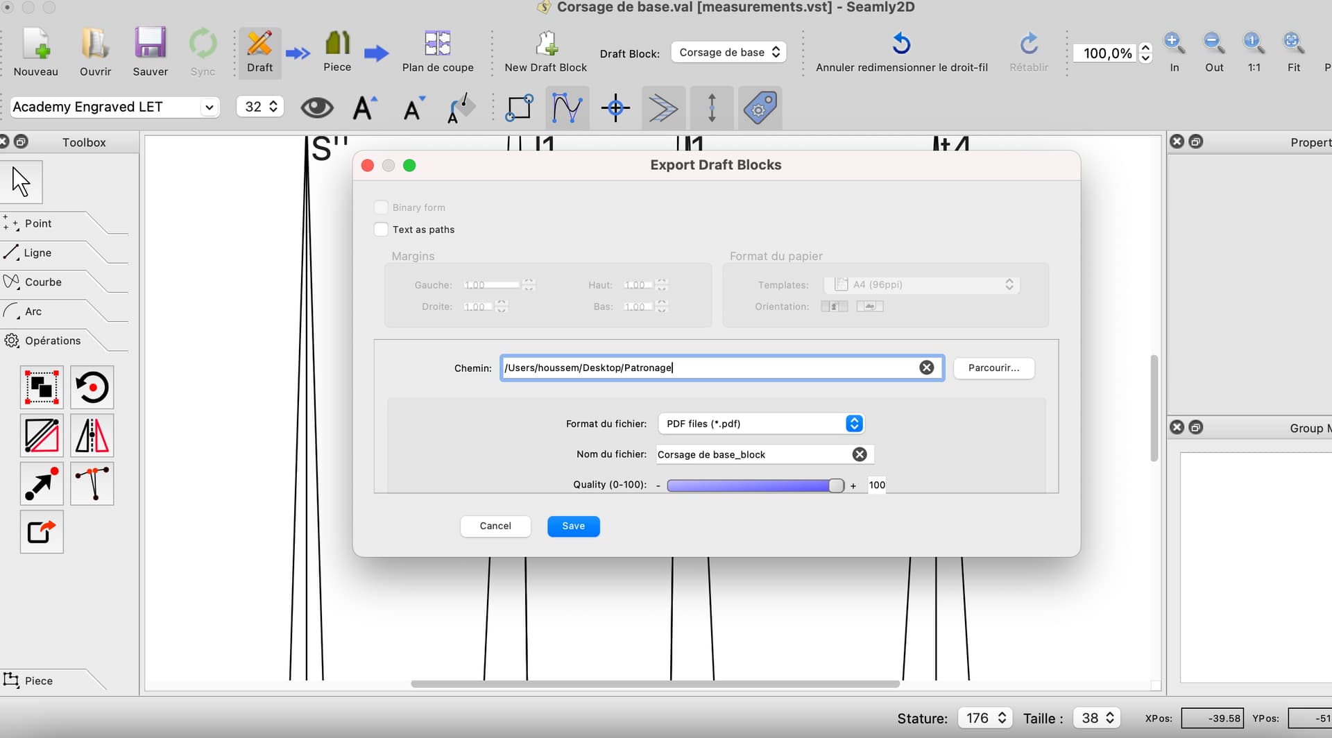

Hello, I tried to export draft blocks but I can’t change the paper format. How can I change that?
The paper format in the export only applies to PDF files. If you want a graphic format to fit on a given paper size - select fit to paper in your printer settings when you print - or use another app like Inkscape to scale the image.

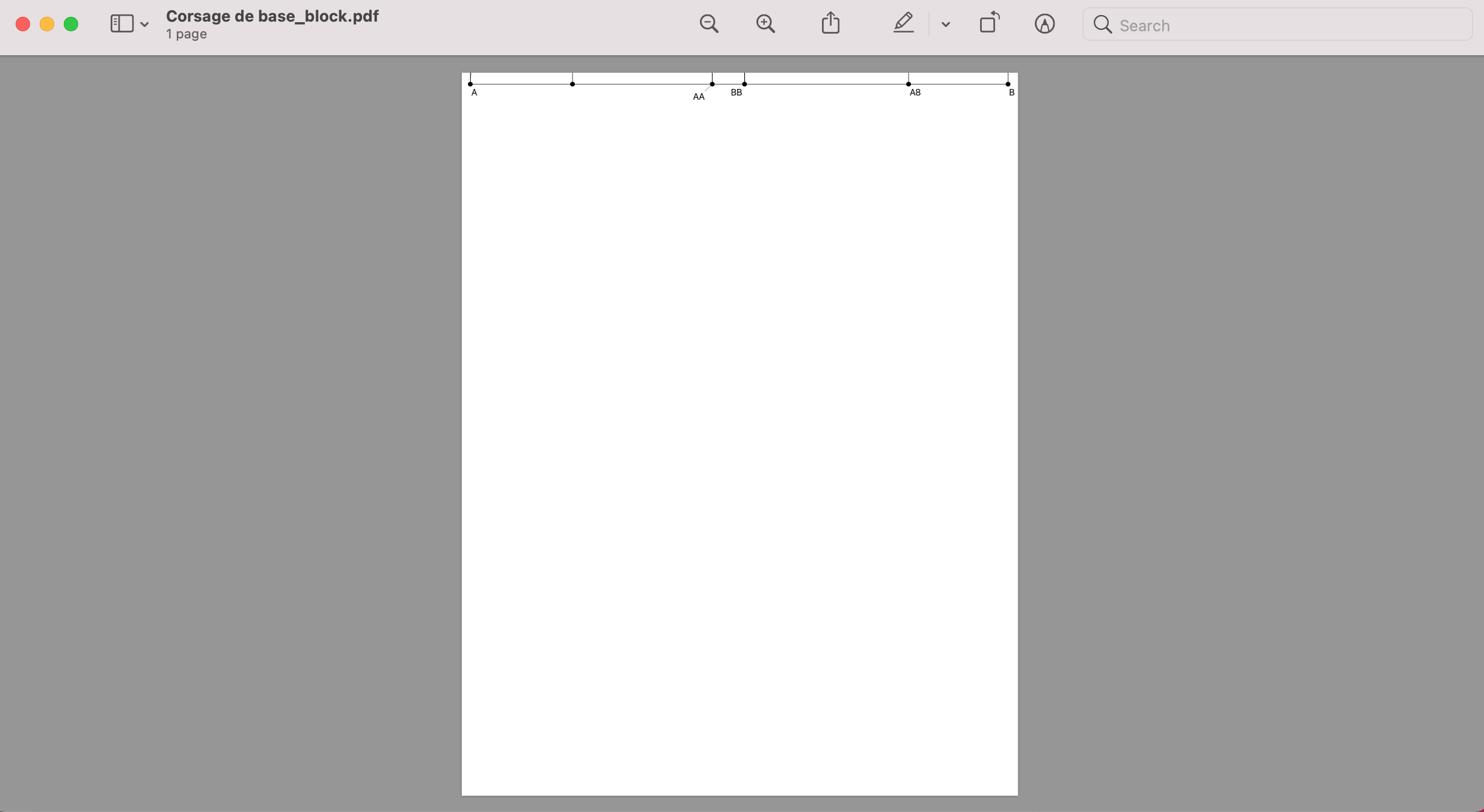

This is all I get
Ah, I see what is going on, @MCdesigns. The only part of the draft which the export shows is the part below & to the right of the “Axis Origin”. Move “A” to a location which brings the whole draft into the lower right quadrant.
It worked ! Thank you very much
