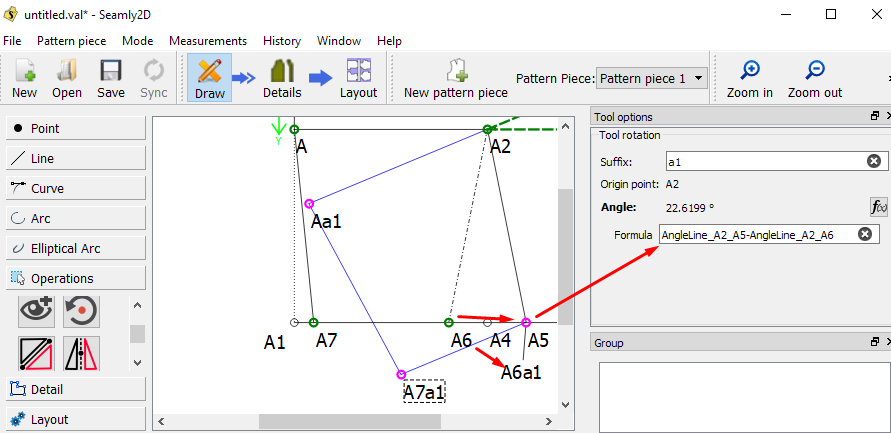

Oh, wow! So you would like to close the waist dart & open the chest dart more.
That works on exactly the same principal. Instead of moving the dart, you need to move the fabric part.
So instead of moving the points A45 & A46 to positing 180 degrees, you wish to move points A30, A48 and A45 to make A45 meet with A46 :slight_smile:
Does this make sense? I’m going to make a small sample.
Here it is:
In the example, I drew the lines from A2 to A6 and A5 so that I could use them to create the formula I used. And I made the new lines blue so that you could see them better.
Here is the small file: Test Move Tool.val (2.8 KB)
I think it would be better if you did this rotation from a node that is above A the same distance as the line between A6 and A4 so that the dart actually is centred over A.
2 « J'aime »
