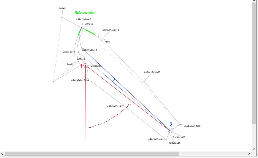

Bei der Dolman-Ärmelanlage nach dem Müller&Sohn Schnittsystem muß der Vorderärmel an einem bestimmten Punkt am Vorderteil angelegt werden und dann gedreht und aufgesperrt werden, um zwei verschiedene Referenzlinien zu berühren. Ich muß den Vorderärmel am Anlagepunkt also gleichzeitig über zwei verschiedene Drehpunkte in die gewünschte Position bringen. Hat es vielleicht schon jemand geschafft eine Formel für dieses Phänomen zu finden?

  1. First swivel the red line to the necessary angle and length - You could use the tool Point At Angle & Distance to avoid too many extra nodes.
  2. Rotate the underarm part using the rotation tool.
  3. Complete the sleeve.

Thank you for your prompt reply! I think that’s what I did. The problem is that the process is not transferred analogously to other sizes.
Sorry, I think a bit was lost in the translation.
It should do, if you used formulas relating to the sizes in the other parts of the pattern.
For instance, the red line from armhole going down at 270 degrees, would have the measurement of the length of arm from underarm to wrist in the formula, OR the one on the right should have this length in the formula.
And the underarm curve should also be adjusted automatically if the size goes up or down, so the curve should be attached to nodes that are measurement based formulas. The curve itself is base on the nodes that it is attached to and should curve very nicely between the nodes, regardless of size, and the rotated curve will always replicate the original curve.

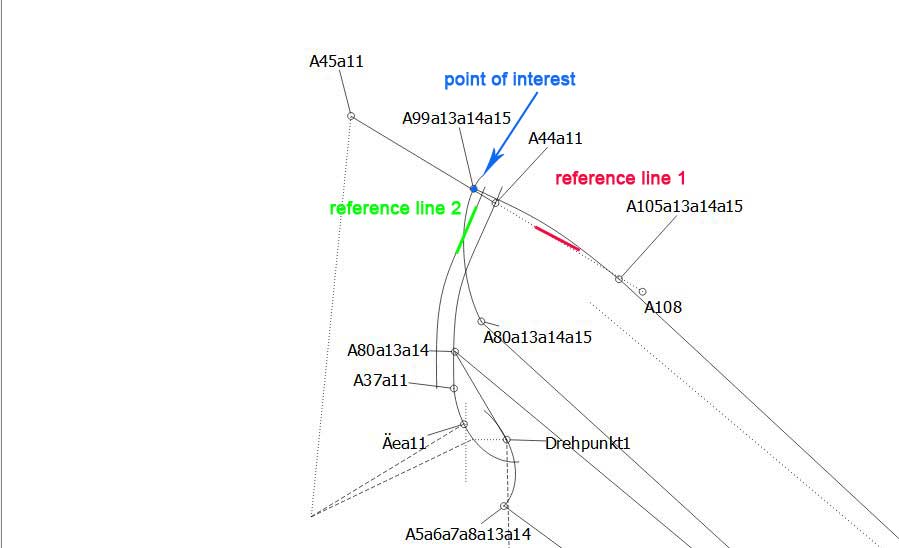

Too bad, unfortunately that does not help me. I probably did not explain well what has to happen.
In file 42 I fixed the 2 angels by eye so that:
  1. the point of interest matches the reference line2
  2. the curve A99a13a14a15_A105a13a13a15 matches the reference line1.
I think the 2 angel formulars I’m searching for to match this in all sizes have to do with the angel of the bust dart.

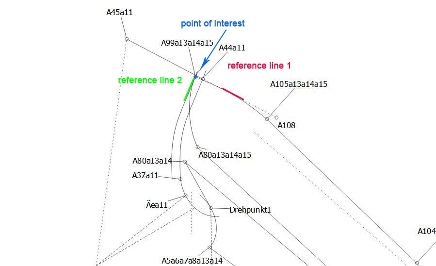

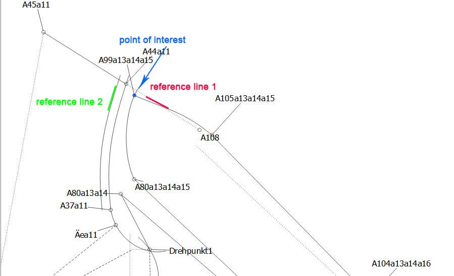

Gr42, fixed by eye:
Gr54, doesn’t match the references Gr34, doesn’t match the references
Ok, am I correct in saying that parts of the sleeve that you created to the right, you need moved and rotated to meet the top and bottom reference points that you created at the armhole of the bodice on the left?
I think @Scholli is German and also uses the Muller & Sohn methods. Perhaps she will be able to explain how she does this for us. I’m getting very confused by all the markings already there but what I think is that there needs to be a common point on the shoulder and on the sleeve where the 2 points need to meet when moved and draw in a line from common point on the shoulder to the Drehpunkt1 in a different colour so that you can see it.
With the rotation, the angle A45a11_A44a11 can be used as the formula .
And I’d do the top part of the sleeve separately and the bottom part separately. First rotate the parts on the sleeve on the right and then move them to meet the bodice on the left.
That should keep the lines minimal on the bodice side because so much is happening there already.
