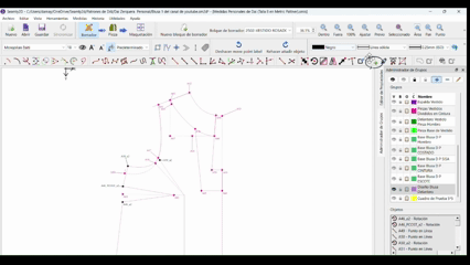

Al seleccionar esta herramienta 2025-09-29 222506. Se redimenciona la ventana de seamly2D, cuando doy un click en el primer punto de mi seleccion. Y aunque lo trato de ajustar manualmente, como se puede ver en el video, no se ajusta a la medida de la ventana completa. Esto no pasa con ninguna otra herramienta. Como unico se resuelve el problema es cuando dejo de seleccionar la herramienta dando click en la herramienta de selección o tocando la tecla ESC.
Tengo que aclarar que la herramienta funciona bien aunque haga esto con la ventana de Windows.
Aca les dejo un Clip, para que vean cual es el problema.

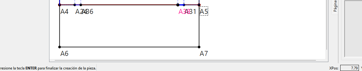

Ok… you’re not crazy… I was creating a piece to answer another user, and just found out how to reproduce the issue. It seems to happen when using a language other than English. And it does seem to only happen with the Create Pattern Piece tool. ???
Now that I know how to reproduce the issue, I know what I might need to look for.
Oh how stupid of me… After trying a bunch of different languages and noticing the width of the screen would vary depending on language… I looked at the status bar:
Doh… long translations of the Piece tool’s tooltip is making the screen expand. :roll_eyes:

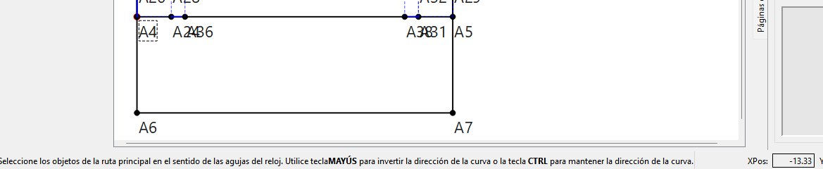

That’s what had me confused, as I could not see why only the Piece tool is affected. It didn’t dawn on me until I kept changing languages and noticed the different screen width with some of them. Now that I know what the issue is, it’s an easy fix. I just have to make the translations fit a given length or make the tooltip adapt to the length somehow.
Actually what I might do is have the “Press ENTER to finish piece creation” part display after the 1st object is selected. That way it will reduce the length of the initial tooltip, and any translations should fit. :slight_smile:
And while I’m at it I better check all the operations tools in each language as those tooltips can also get quite long.
