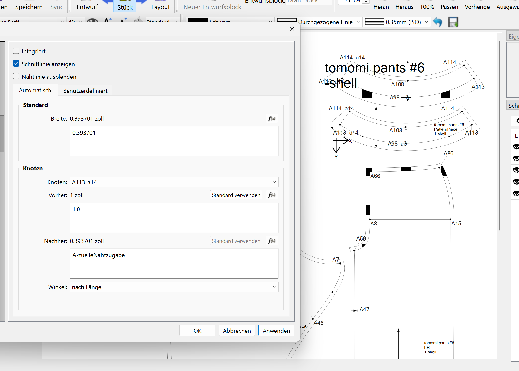

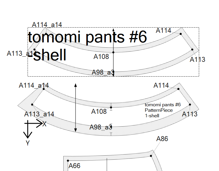

For some reason the seam allowance angle is not right on the left side of my waistband.

Check the After seam allowance at point A113_a14. The before seam allowance is wider and the after seam allowance needs to be narrower to match up with the A114_a14 seam allowance.

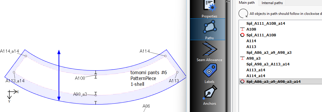

I tried to fix that, but the patten kept crashing on me. I receated the piece with the correct SA’s, but it ended up doing the same thing. There’s something it doesn’t like about the mainpath… like maybe that A113 and A114 are not the endpoints of the curve which is not mirrroing correctly.

Habe ich jedoch versucht die Nahtzugaben zu verändern, hat das Programm nicht richtig gemacht. Siehe zweites Bild

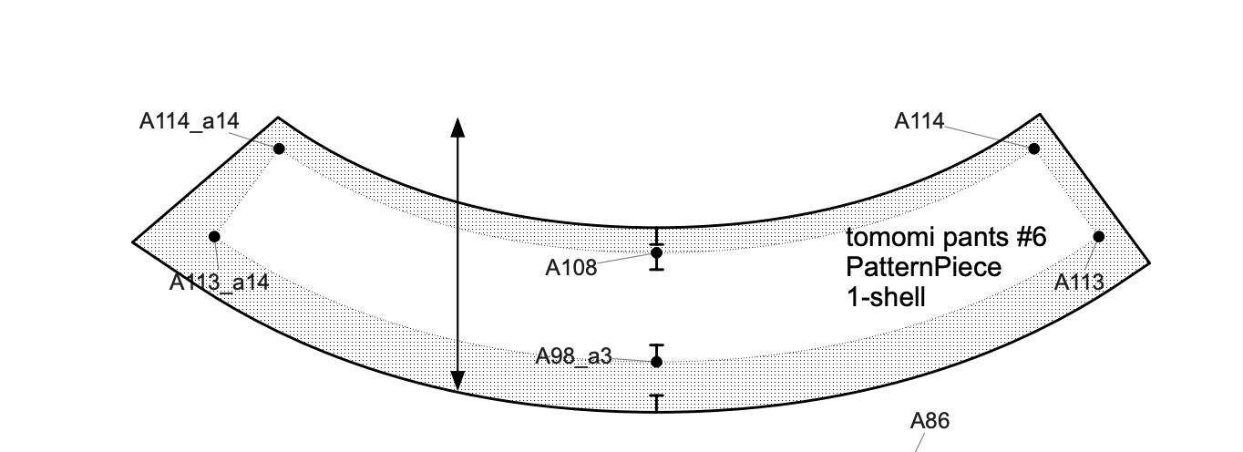

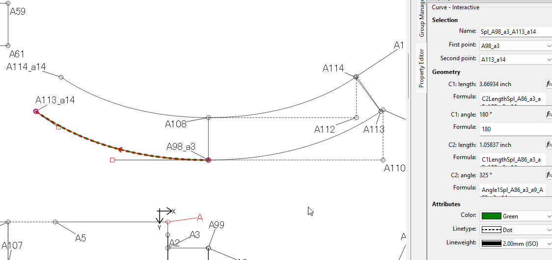

I redrew the curve A98_a3_A113_a14
And included it into the pattern piece. Moved it into place & made it Included and moved the original curve to the bottom & made it Excluded.
Now the pattern piece seam allowance works:

was it because it was mirrored?
Yes I suspect there’s a issue when mirroring and then reversing the curve segmnt, where you’re using a Point on the Curve as the end point rather than the actual endpoint of the curve.
That’s why @Grace just redrew that curve segment.
