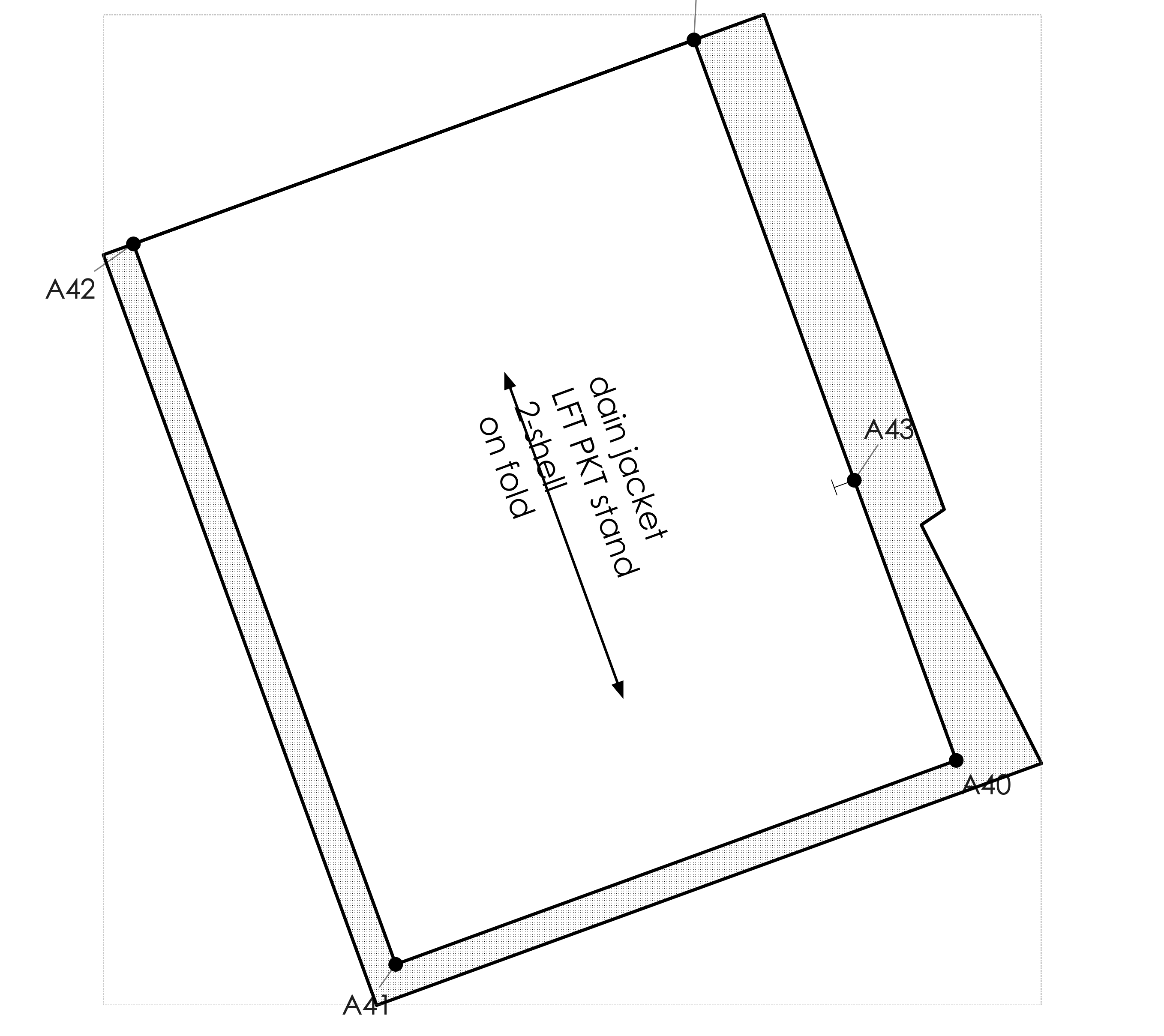

Seam allowance jogs at notch
how do i fix this jog in the seam allowance at the notch?
dain jacket.sm2d (270.3 KB) dain 031224.smis (2.1 KB)
Set the same seam allowance in the Before and the After for A43. The Before has been set to larger than the default SA, so now you just need to set the After in the same place
thank you! i realized that i had extra points in there that changed the order and shifted the default. i had checked that before i deleted them!
