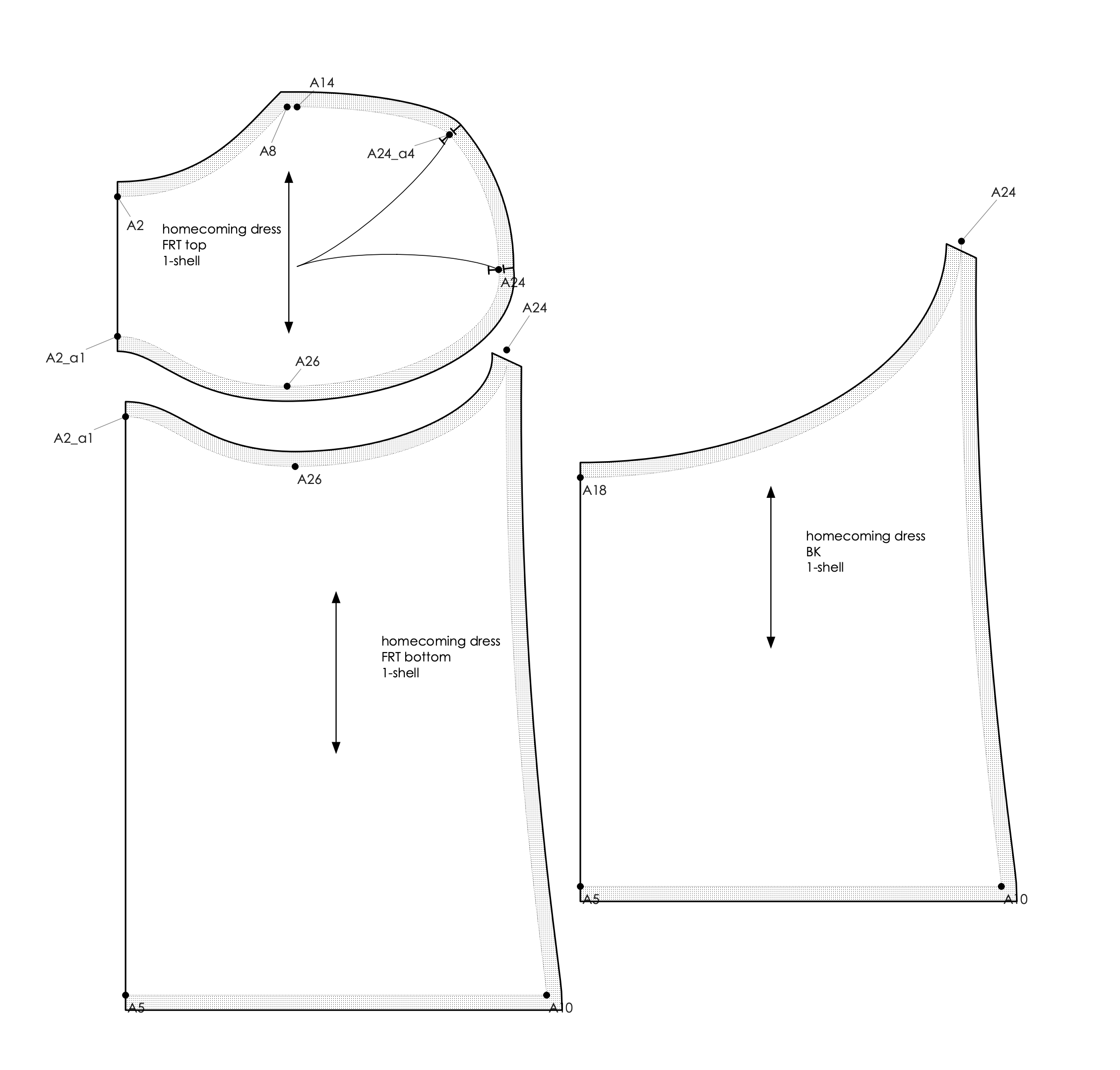

not sure how to fix the seam allowance at the point A24.
changed angles and that didn’t do anything.

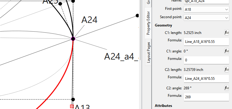

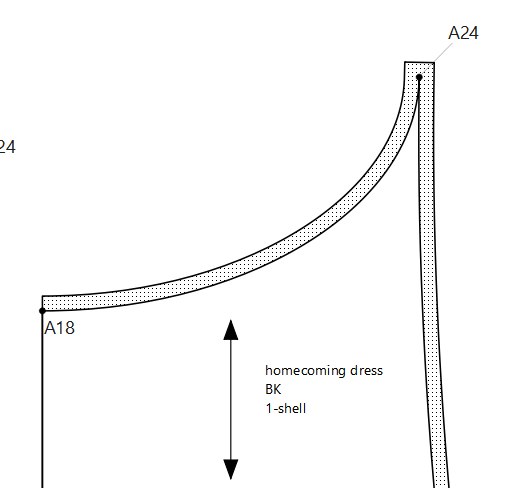

It’s the fact that the angle of CP 2 = the angle of the vettical line. I changed the angle of CP 2 to 269 deg and it works:
thank you so much!!!
