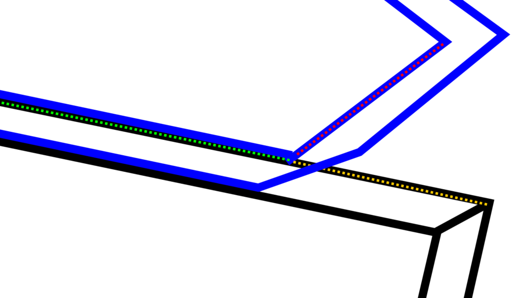

I was wondering is someone had tips on how to sew a solid and clean notched collar. My main question is the way seam allowances should be clipped so that it’s not bulky at the notch point and so that there’s no risk of creating a hole where the seam allowances are clipped.
I usually clip my seam allowances like that, with 3 seams meeting at the notch (in purple, green and orange in the image):

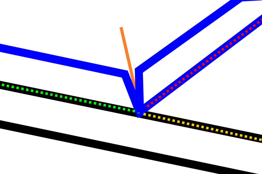

I’m worried the collar could rip at the orange line, where the seam allowance is clipped:
I’m wondering if cutting my collar seam allowance like that, as we usually do for simple right angles, could be a solution (the seam allowance is unfolded in the picture below) :
I fear it would make too much fabric at the notch point, thus a not-so-clean result…
What do you think? Do you have some tips to sew those collars?

Well, normally, the upper collar pattern piece is ever so slightly larger than the lower collar pattern piece (this is so that the stitch line is at the bottom of the completed collar and not at the exact edge) and the seam allowance is, as you show in your image, about 1mm away from the stitch line at the corner and slanted at more than 90° angle so that it sits snug in the corner after turning.
And then there’s the interfacing of the collar where the seam allowance would be very narrow and perhaps even not be included at the corners (but will come really close) to get the clean points.
All of this information should, in actual fact, be included on the paper pattern and be described in the pattern instructions that accompany the paper pattern.
I normally cut the upper, lower and interlining from the same collar pattern piece and trim the seam allowances after I’ve stitched it up and before turning it. The under collar, I normally trim off 1mm on the 3 outer edges, and ease the upper collar to fit the lower while keeping the inner edge matching.

So you think that my 3rd image (the corner of the seam allowance is cut) is better than the fist one (the seam allowance is cut all the way through from the notch point) ?
Would it be possible for to to share a screenshot of only this particular part of a pattern that shows this seam allowance, please? :blush:
Thank you very much for those tips :blush:
2 « J'aime »
Yes, you need to leave a tiny bit after the stitching so that the fabric doesn’t make a little tuft of threads after you’ve turned it.
