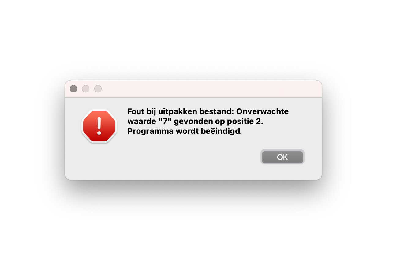

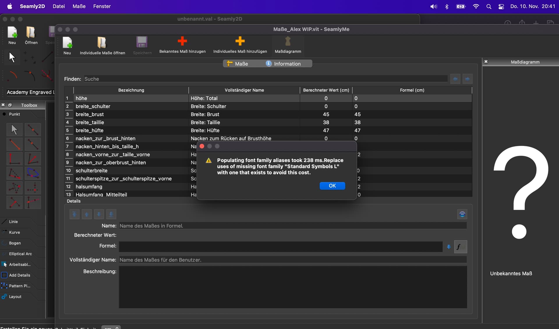

When I imported my individual measurements and seamlyme already showed this error message (see picture below)seamly2D crashes as soon as I want to ad a formula for the length of a line. Then it crashes without a message.

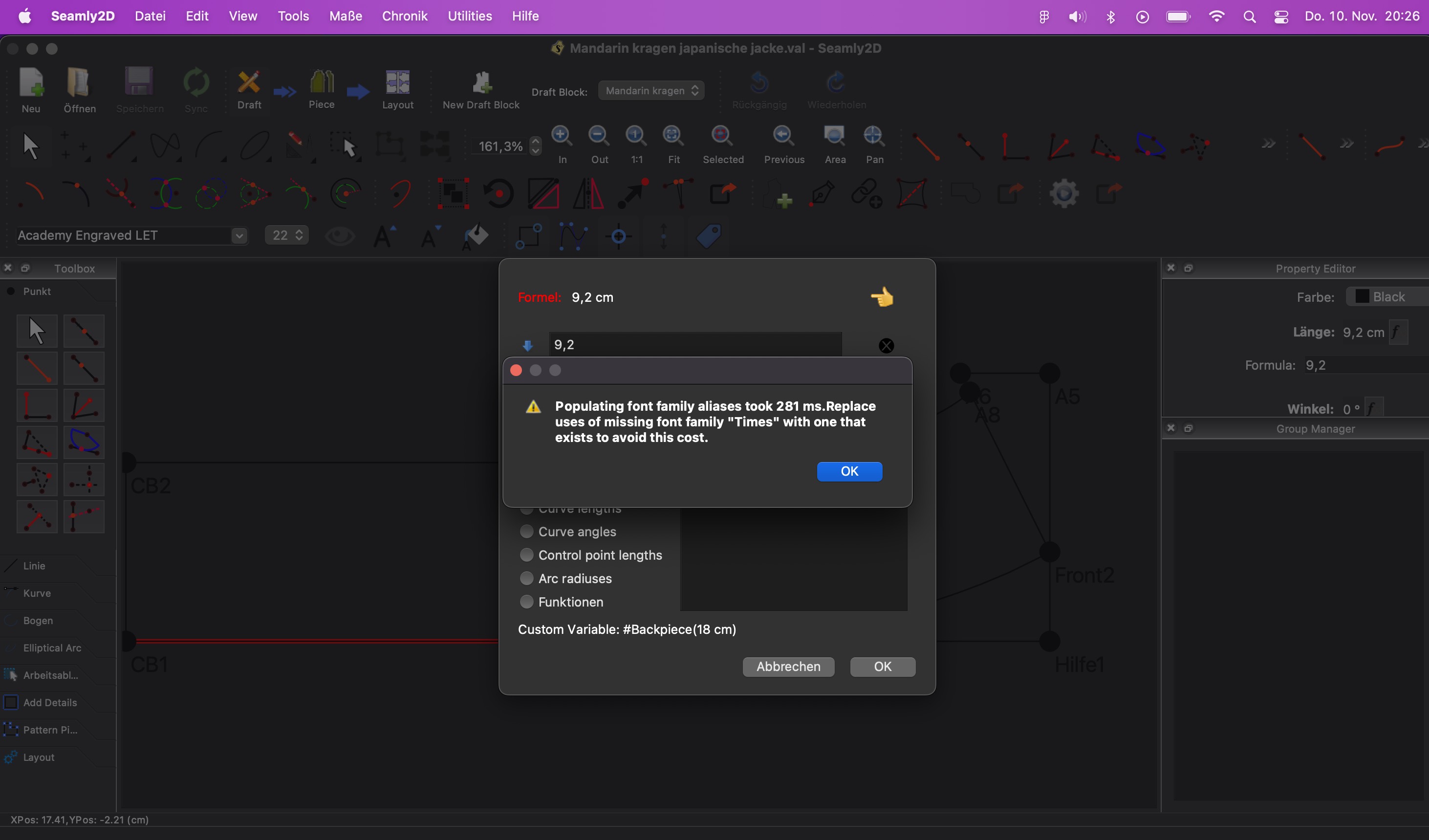

What I’ve done:
  1. open pattern in seemly 2.Right click on a point → choose properties
  2. length–> formula icon
  3. → Custom variables
  4. error message appeared, software died

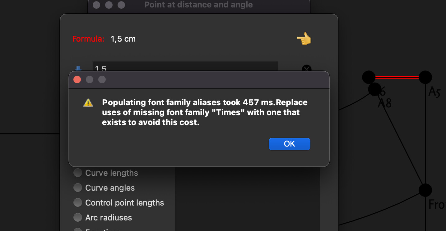

I had some more issues with fonts that are not available on my computer. I just searched for them in the whole project and found where they are used. I am wondering: Is there a style guide or variable in which the fonts are stored? If yes I guess it makes sense to use them here, too. A fix would also be to use the standard system font but this is not the most beautiful solution I guess, and as I am not familiar with the tool (and not that good in coding) I didn’t want to change the code. Also don’t know if this would fix all the problems with the fonts etc. Times is not available on Mac, that there is a problem with this symbol font and I think another one, but I can’t recreate it now.

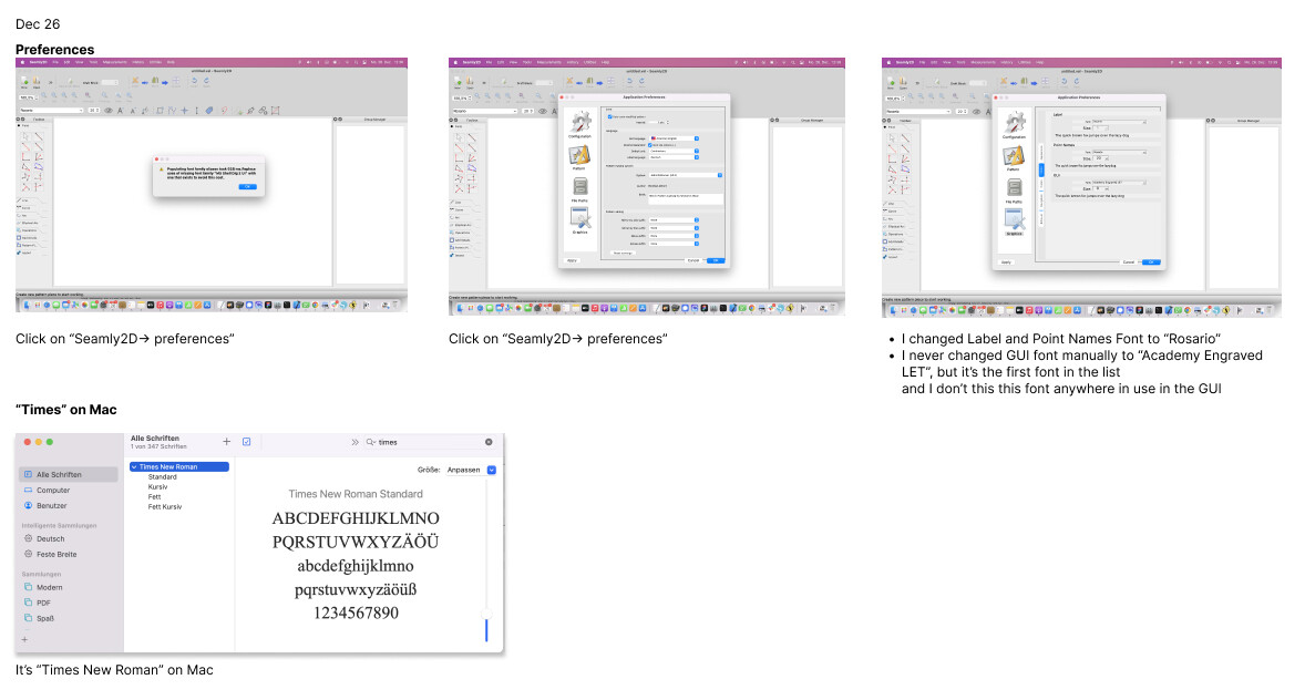

Hello Douglas, thank you for your answer! I checked the preferences again, I never changed the GUI font but the fonts for labels. And “Times” is not available on Mac, It’s “Times New Roman”. BTW if I click on “Preferences” there’s another font missing.

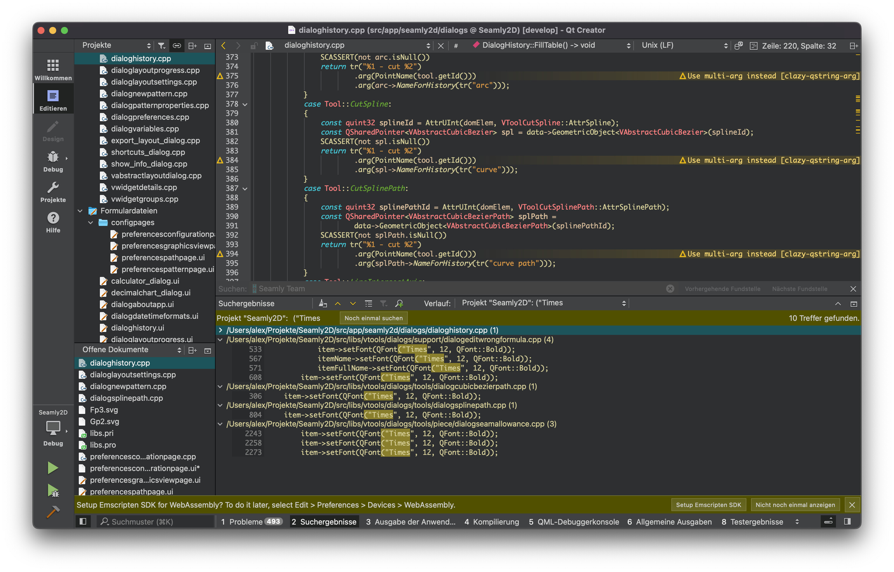

Interestingly as I’m working on updating the Pattern Piece dialog, there are several other list widgets that were hardcoded with 12pt Bold Times… besides the fact the font doesn’t match the main path list font, and I want them all to match, I did a search for Tiimes, and lo and behold it shows up in all the dialogs that seem to cause issues with some macs … the fx Edit Formula, History, Variables, etc.
I think what we can quickly test is if I change the Times font in the fx Edit Formula dialog to what the tool dialog’s are using, and if that solves the problem, I can remove Times everwhere else… either by changing the font or making it the user set gui font.
