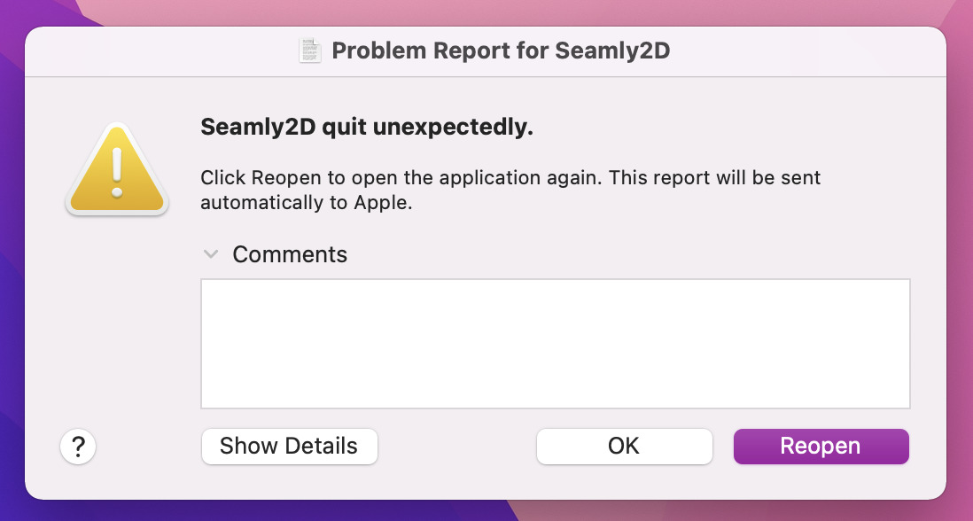

My Seamly 2D keeps crashing when I try to add the loaded measurements when starting my pattern. So I cannot load any measurements when on the principal pattern page. It shows the error code window

Can you post a screen capture of the error? Also if you can look in the help menu and tell us what build date.

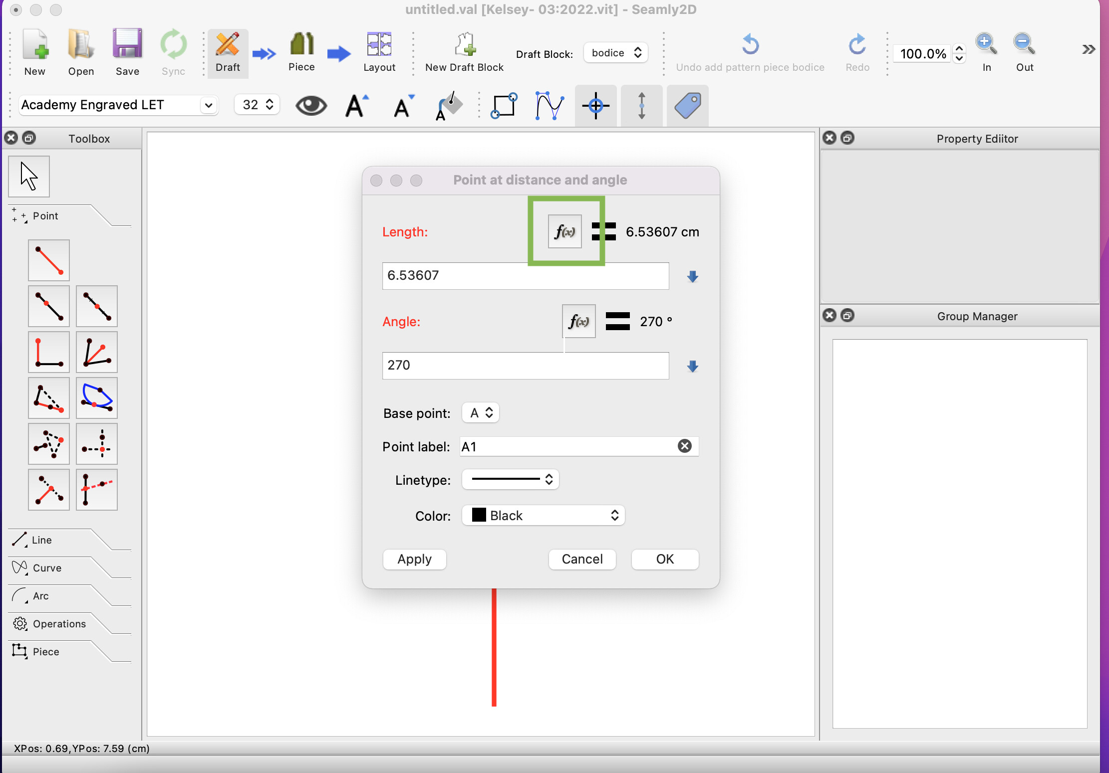

Hello, new user here. I am also experiencing the same issue, as soon as I clock the button (in the green square) the whole seemly 2D system shuts down and a message pops up
