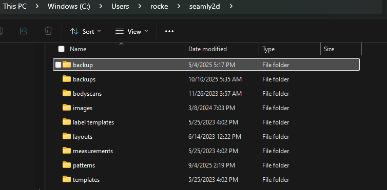

In other words in the “home” dir (in Windows it’s the users’s folder) you are getting these folders created - with the folder names translated if using a language other than English?

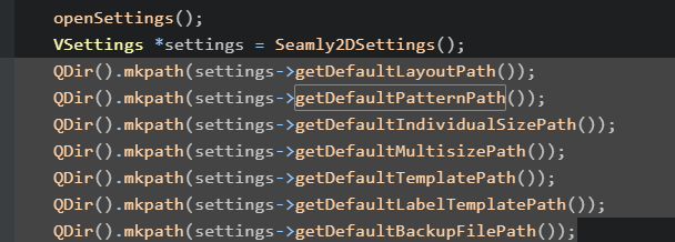

Where these come from is when the application starts:
which for ex: the default patten folder is:

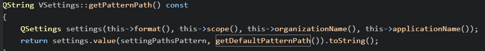

Then in normal use the app would call this when loading a pattern:
Which basically says… get the pattern folder from the settings. If there is no existing folder by that name - create it.
SO… the solution here is rather than calling for example:
QDir().mkpath(settings->getDefaultPatternPath());
we call:
QDir().mkpath(settings->getPatternPath());
Repeat for all the other folders.
That way when the app starts it will try to get the pattern folder from the settings… if the folder doesn’t exist it will then create the “default” folder in the user’s HOME folder.
Don’t feel bad… my seamly2d folder had a set of subfolders for every other language because I’m always testing the app with different languages.
