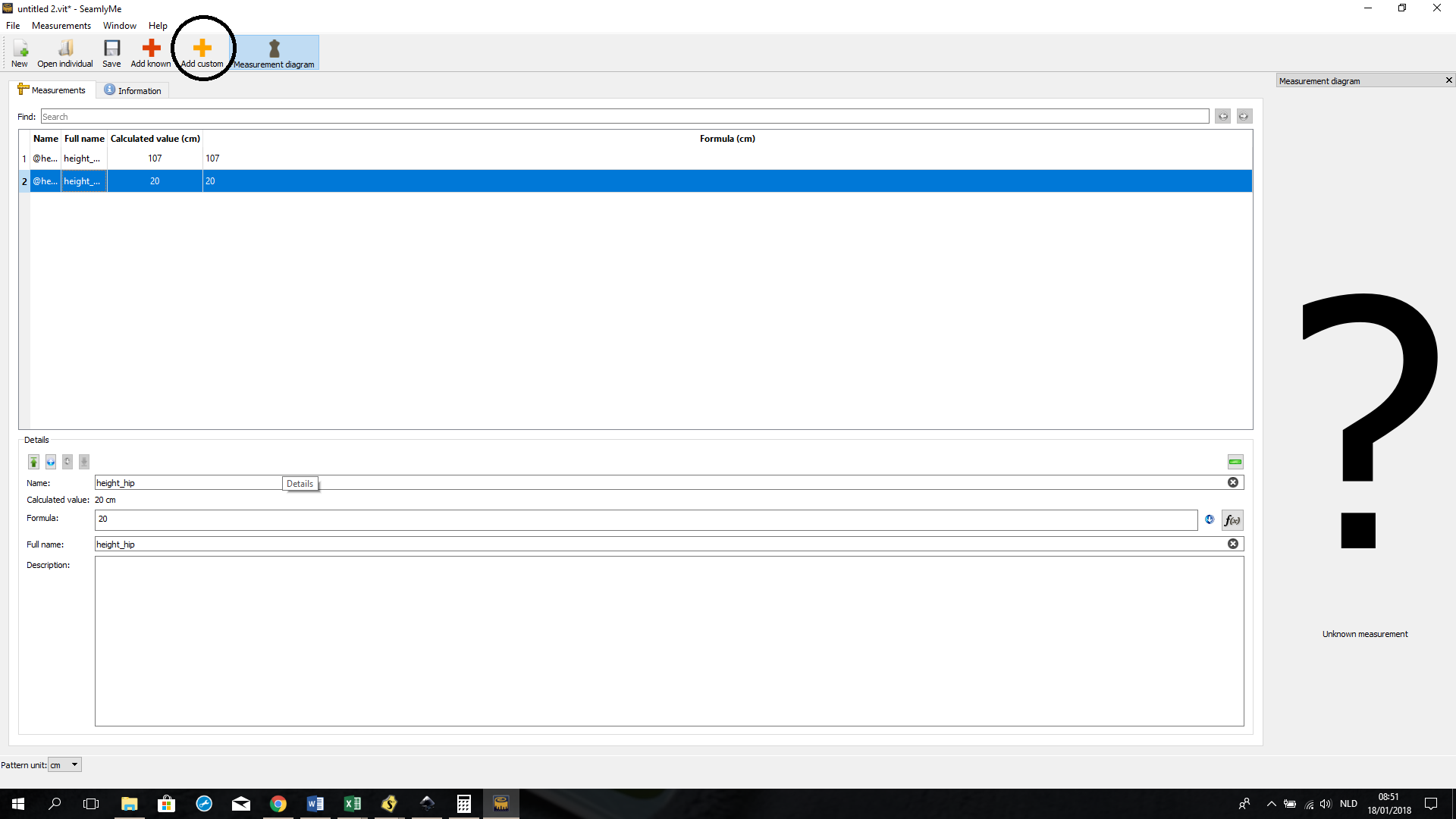

I am a complete newbie here on the forum, and I have only just begun using Seamly2D and SeamlyMe (although I have known about the Valentina project for quite a while), so please bear with me if the answer to my question should be obvious. After trying to understand the programs and the whole workflow, I was under the impression that I could choose whether I wanted to assign either constants or formulas to the values of the measurements in SeamlyMe. The constants work as expected, but I was surprised when I could not have something like (height_waist_side - height_hip) as a formula. The formula wizard does not show height_waist_side or height_hip as available either. My intention was to have a measurements file that I use as a template for every new person, where I use approximations calculated by formulas for some measurements, and I replace the formula by the actually measured value if and only if I have it for a particular person. This way I could use the measurement in my pattern pieces whether it has been measured or ‘only’ calculated. So why is there a limitation on which measurements I can use in a formula?
I am using SeamlyMe 0.6.0.1 built 2018-01-13 at 13:08:54.
Thank you, Elke
Hi Elke,
You can make a measurement table for every different person, load this table and use those measurements in formulas. It will not be visible if it is not loaded.
load individual
If you cannot find the measurement you need in the ‘known measurement’ of SeamlyMe, you can always make custom measurements. In formulas these will automatically have an @ symbol at the front.

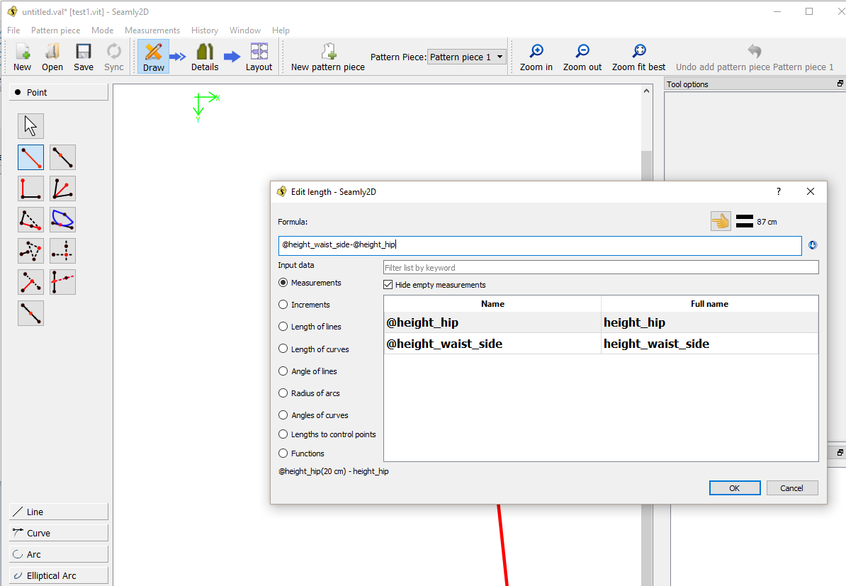

Hi Elke,
welcome here :slight_smile: I understand you want to do formuals related to persons in the measurements-file; those formulas are not related to patterns? Formulas should work, I just tried it on my build (the same version on Ubuntu; I guess you have Windows or so?) and it works fine: Screenshot_2018-01-18_08-59-54
The read formula here only happened with printscreen, must be something with grafics. But it works. You
  • press the orange button - add individuel measurement
  • press the little f(x)-button over the right edge of the input-field “formula”
  • make sure that there is no value in the field “Formula” of the pop-up-window that appears
  • double-click on the desired measurement
  • write in your operator (±*/)
  • double-click the next measurement or write in a constant
  • click on ok. If there is any error in the formula, the word will become read and the ok will be lighter in color, the ok-button not working. Check the formula in this case.

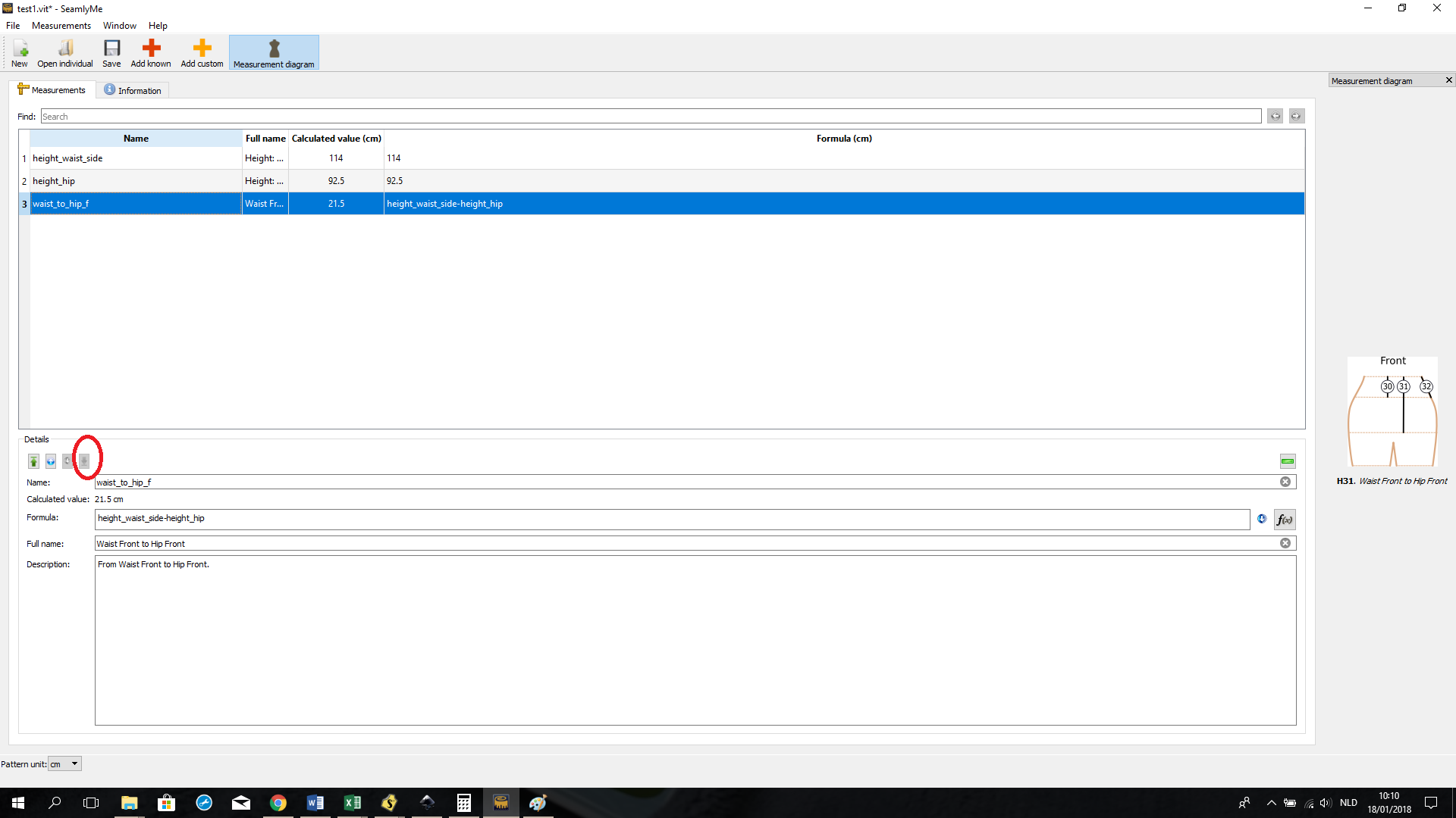

Hi AVI,
I just tried using a custom measurement, and it works perfectly! But why can’t I use the same formula that works in a custom measurement in a certain known measurements?
Screenshot from 2018-01-18 09-38-37
The waist_to_hip_f measurement does not accept the formula (height_waist_side - height_hip), whereas my @CustomMeasurement1 does. Is this some kind of bug, or am I for some reason not supposed to do what I am trying to do?
Thanks for your help!
It is not you :slight_smile: It is the kind of calculating Seamly does.
Put waist_to_hip_f under the other measurements. Seamly doesn’t know height_waist_side and height_hip at the time you want to calculate with those constants.
If you put waist_to_hip_f for example at place 8, it will work. You can use the arrow; mark waist_to_hip_f and take the green arrow to get it all the way down, the blue to get it step for step down.

Hi Elke, moniaqua already answered your question, the program needs the information before doing something. Your waist to hip f is at the top, so it will look into this first and not find the other measurements. Place it at the bottom and it will.
I see! :smiley: This is an easy way to avoid circular dependencies, so it makes sense. The two of you are posting so fast that I can’t keep up… Thank you so much! Am I supposed to update the documentation after such a ‘discovery’?
Yes, Elke, I can calculate :wink: Still Seamly needs to know a constant before it can calculate with it. And if waist_to_hip_f is in the first place, Seamly doesn’t know the other constants, like @AVI also said. It is as easy as that.
Put your formula all way down and the wizard will know the other measurements, no matter if custom or known. It is the place where your custom measurement stands, not the fact that it is a custom measurement.
