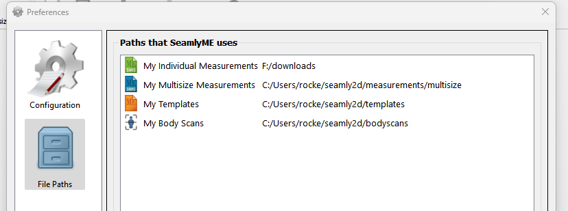

Once youāve established where you would like to save everything, you can set the File > Application Preferences > File Paths in Seamly2D:
Then both Seamly2D & SeamlyME should find the folders without you needing to navigate to them every time.
Did you set the file path prefs as @Grace suggested above?
Since I donāt have a Mac I canāt check if the default file paths are being created on install - which are normally going to be ā¦/seamly2d/measurements/individual and ā¦/seamly2d/measurements/multisize. In any case you can set the path for each type of measurement. You can change measurement paths either in the Seamly2D or the SeamlyMe preferences.
