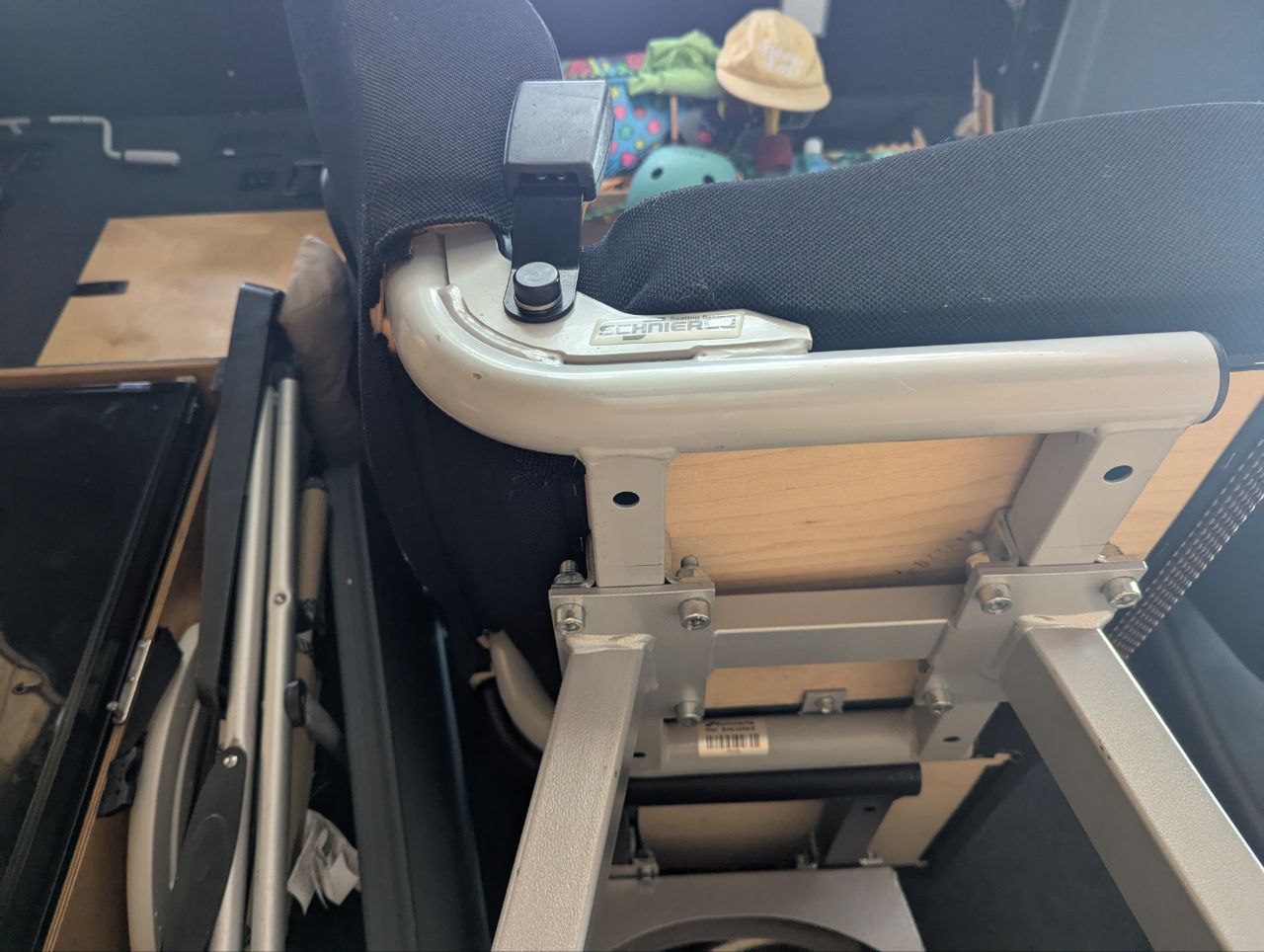

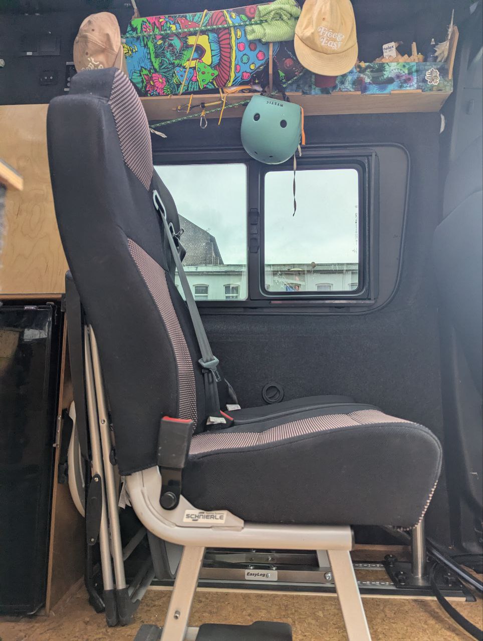

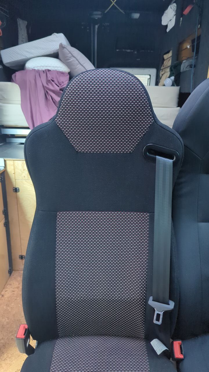

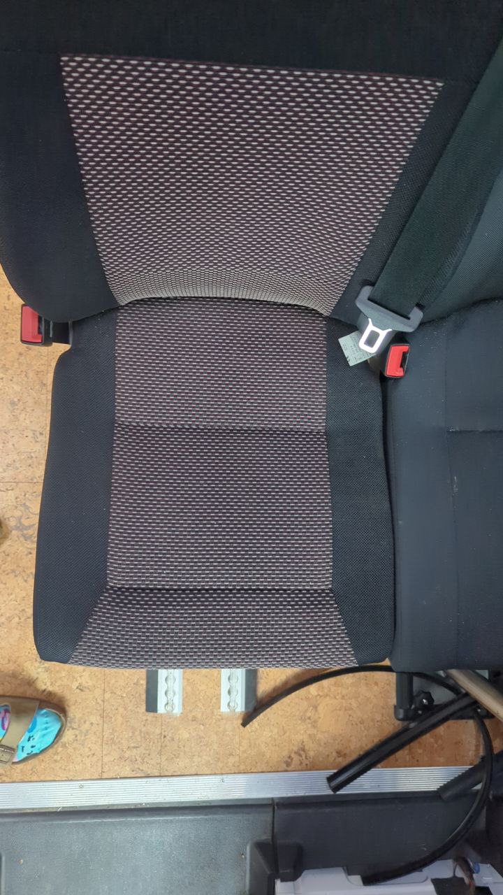

Thank you. Below you can see the seats of the camper. I have to clarify that the seats need to be covered for protection. My toddler nephew will soon start to run around and wreck havoc, when going on a camping trip. For that purpose all seats should have a removable cover.
Can I use image import directly from those pictures, or do I have to include some calibration grid by default? That would bea genius solution. I am still gatehring information. Still not sure how to proceed.

Once you have all your pieces draped and seamlines drawn, you can add the seam allowance. For your purposes this pattern should suffice, but if I was to actually transfer it to Seamly I would take pictures of the draped pattern pieces rather tham pictures of the seat it self. There will be less distortion. Easiest way is to tape the pieces to a wall and take pictures, making sure the camera is perpendicular to the wall to limit the distortion. That said, I don’t think the fit is that crucial given the fact that it’s just for car seats. :slightly_smiling_face:
