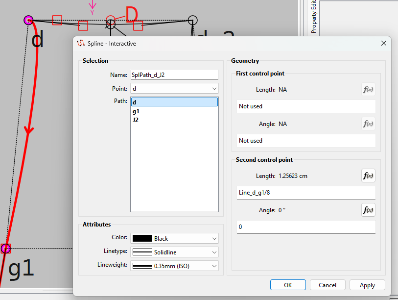

banenrok_glad_tot_eerste_heupwijdte_bug.sm2d (6.0 KB) I have a segmentation fault that happens consistently with this file. I’m trying to edit the spline that runs from SplPath_d_J2, wanting to mirror it to SplPath_d_2_J2_2.
Here’s the steps that lead to the crash:
  1. Open the properties of SplPath_d_J2
  2. Select path d
  3. Enter “Line_d_g1/8” in the Length field of the Second control point.
This crashes Seamly2d every time.

I was able to progress a bit further, somehow, but then it crashed when I tried to put (Angle1Spl_d_d_2 - 90) in the Angle field of path d :grimacing:

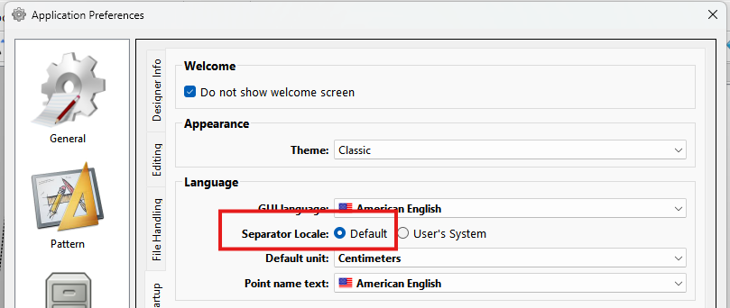

BTW… the angle needs to be fixed.
That said though… I’m not sure why your decimal point appears to be a comma?
Check your prefs and see what the separator is set at… for en_US it should be a period… setting the separtor to default forces the app to use the “c” locale using the period.
Hmm, I was afraid of that. Well, no idea then… Yes, I was trying to fix the angle, but it kept crashing :sweat_smile:
In the Netherlands, we use a comma instead of a period, so this is expected behaviour!
Understood… I just saw that your locale is
Which does not use the comma thus my confusion.
