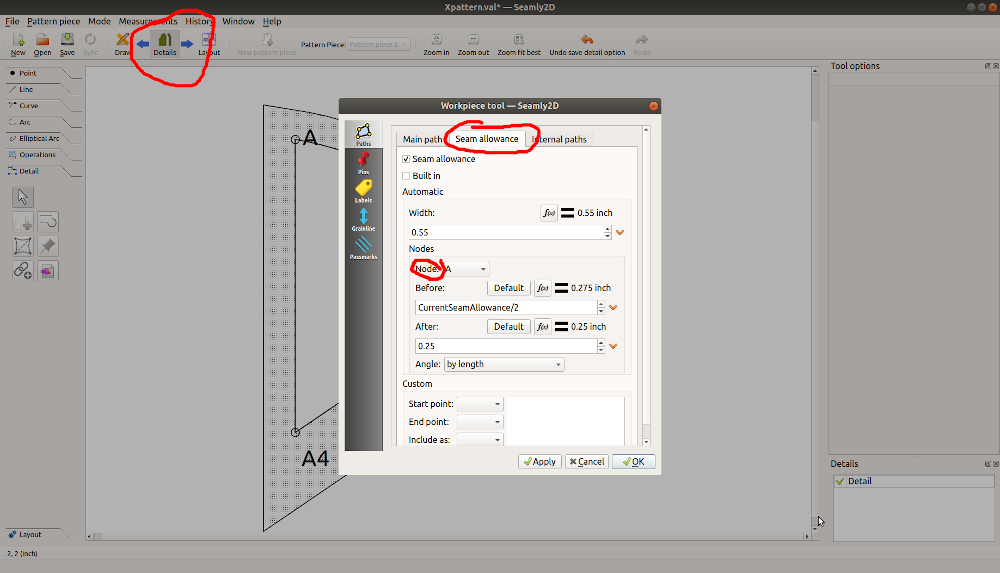

Yes, there is! Sorry I don’t have a screenshot for you, (a picture’s worth a thousand words,) but I will attempt to describe it to you.
  • In the “Details” view, right-click the pattern piece you want to work with, click “Options.”
  • Now that you have the options screen up, click on the “Seam Allowance” tab at the top. I assume you already have seam allowances on.
  • Under “Nodes” use the drop-list to choose the first point of the side you want to have a different seam allowance, (you did select the points while making the detail, right?)
  • change the measurement from CurrentSeamAllowance to what you prefer the seam allowance to be in the “After” section.
  • Then choose the ending point of that side of the pattern piece, & in the “Before” section do the same thing.
That should do the trick!
Here’s a .val with the random experimental piece I gave a variable seam allowance: Xpattern.val (4.4 KB)
5 curtidas
Here’s a screenshot now, with the key points highlighted with a red circle:
ETA: & now I’ve made a page in the wiki regarding Seam Allowances. I probably ought to go back & delete a few of the less focused paragraphs, but I’d rather someone else make the judgement on what is unwanted.

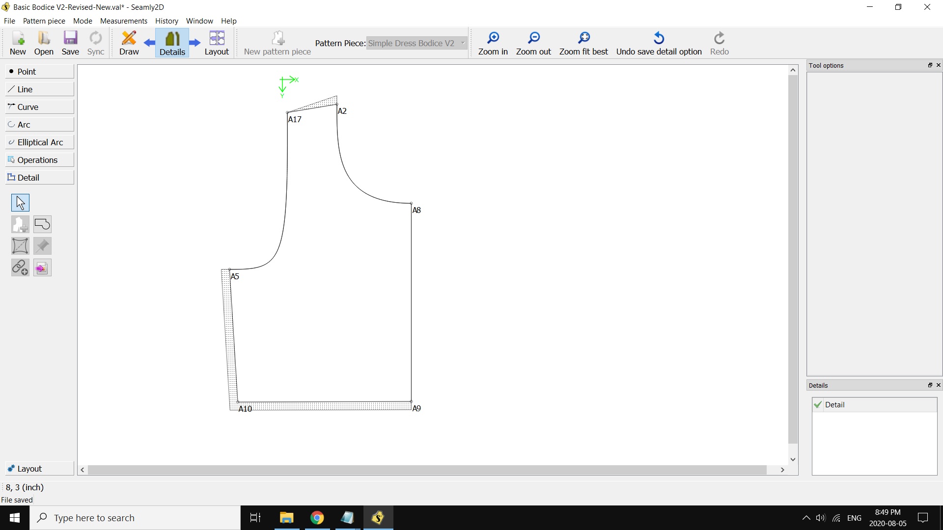

I am having a problem with selective Seam Allowance!
I set A5 to 0.5 allowance before and 0 after and it works but when I set A17 to 0 before and 0.5 after it makes a mess and it looks like this:
Not sure what I am doing wrong…
2 curtidas

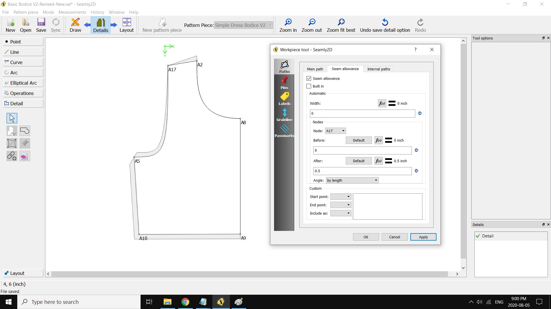

Hi @Vy87
Please send me your Pattern and Measurement files (.val & .vit) so that I can have a look. I don’t see, from your pictures, that you are doing anything wrong, so I would just like to check, please.
1 curtida
Basic-Bodice-New.val (5.5 KB)
Here is the file. I tried checking other settings but still can’t figure it out.
2 curtidas
For starters, I had to mover the armhole curve to between the armhole point and the shoulder point :slight_smile:
And now the pattern looks like this:
Basic-Bodice-New 2.val (5.5 KB)
Here is your pattern back with the changes that I made. :slight_smile:
1 curtida
Thank you. I feel kinda dumb that’s literally the only thing I did not check XD.
2 curtidas
LOL, you’re very welcome, @Vy87. As you can see by the reply, I was expecting more because of another issure and was totally surprised, myself. :crazy_face:
