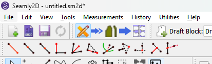

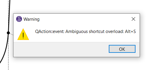

I’m getting this error message when I press Alt+S for the spline tool
Thanks
I’m getting it on mine, too. Perhaps @Douglas can have a look, please?
On it. Should be an easy fix.
Ok… I’m baffled. There is only 1 instance of Alt +S… I have no clue where this coming from. ![]()

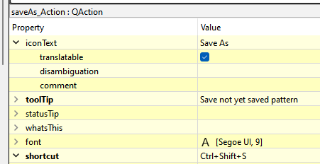

Well this is really bizzare. The Alt+S is opening the Save As dialog, even though the short cut is set to Ctrl+Shift+S.
And yes…Ctrl+Shift+S also opens the Save As dialog. ![]()

Can anyone confirm… you have to press Alt+S+S… and then the Warning pops up?

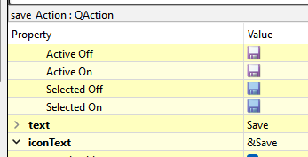

OMG… how stupid of me. I put 3 and 4 together and figured it out.
Here’s a clue… look at the Icon text and what do you see?
This is the action for the Save menu item… and it’s text is &Save… guess what the “&” means? It means Qt assigns that action with the shortcut Alt plus the char that immediatlely follows it… in this case “S”. i.e Alt+S. It doesn’t show up in the ui source code as the compiler replaces the “&” with “Alt+”. Which is why a search of the code only showed the shortcut for the Spline tool. Oy vey. ![]()
And of course I was getting the Save As… as with a new unsaved pattern it defaults to Save As.

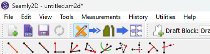

In case anyone is wondering why the &Save… it’s a legacy from DOS days when you would be able to activate the tool bar & select menu items via the alt key.
Pressing Alt activates the toolbar and the items that are underlined char have a shortcut.
It’s also a way for blind users to navigate menus. For example if you press Alt+H+A… you will get the About Dialog.
