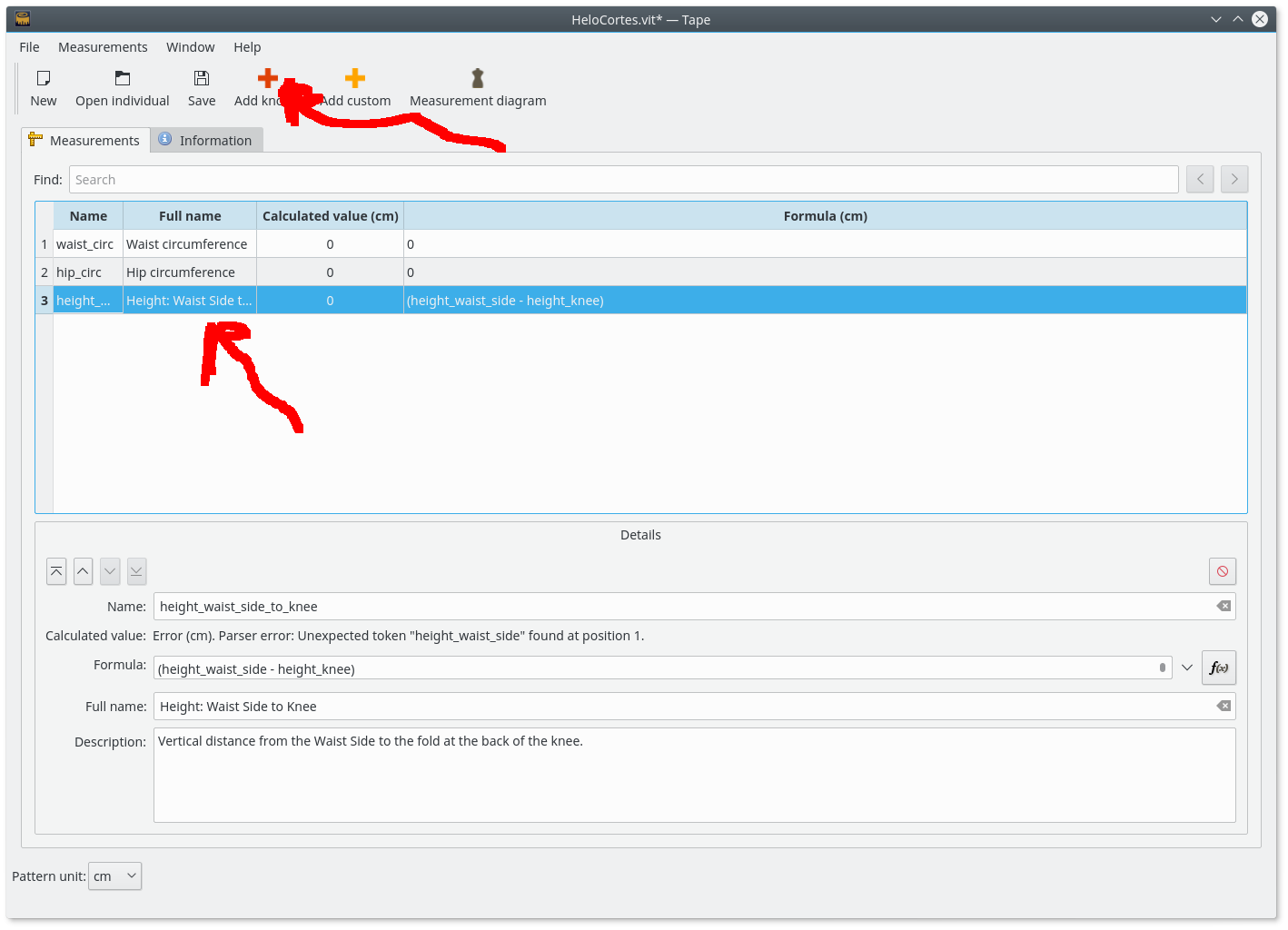

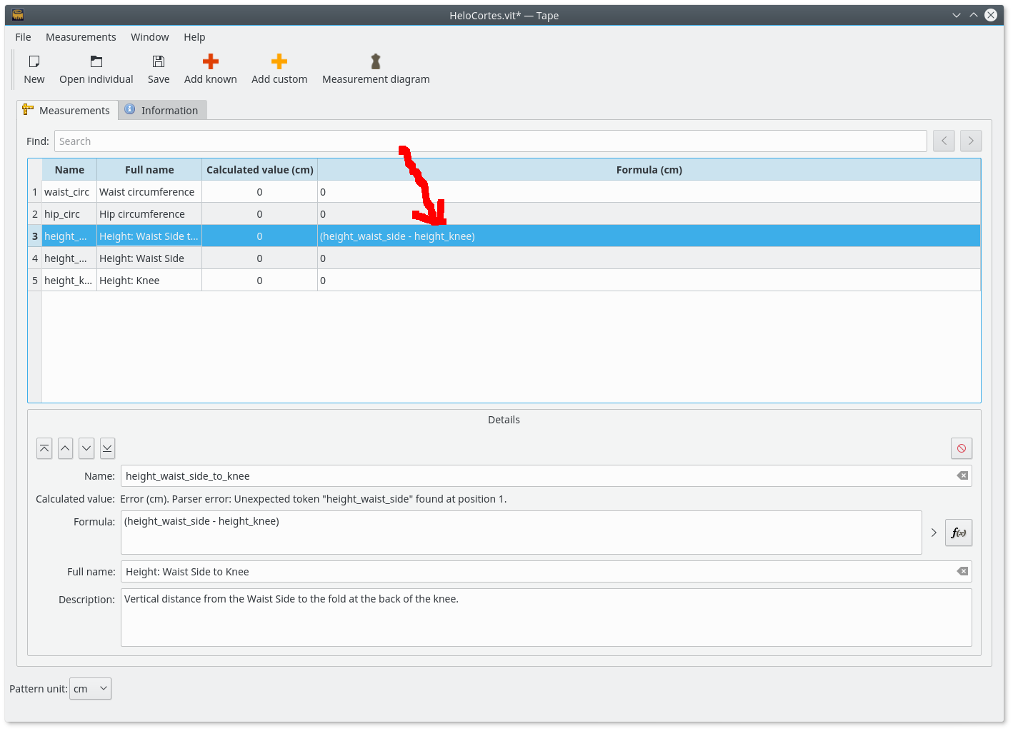

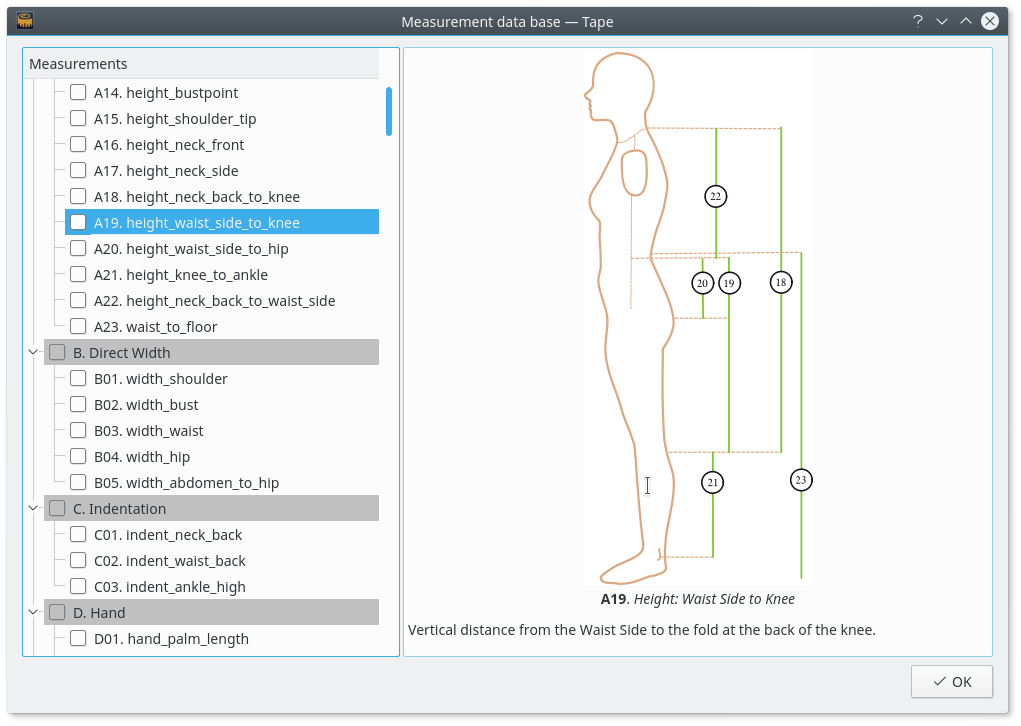

STEP 1 write down your measurements. The TAPE program supports many “known measurement”, which represent the distance between body points described in many different pattern making systems and illustrated in drawings available in the program. Instead of specifying the skirt length, we will measure the height of the knee from the floor and measure the height of the waist from the floor. These are easier to measure on oneself using a yardstick or rigid tape measure. For this example, I will define two imaginary people “Jane” and “Mary” the three sizes S M and L with the following measurements:
size-table
STEP 2 This step is important because it will allow you to make a skirt to fit multiple size persons. Start the TAPE program. Depending on your type of computer, you might need to go to the program menu or click on the TAPE Icon on your desktop. You might also start the valentina program, click “measurements” at the top of the window, and click “Open Tape” from the drop down menu. Create the measurements for each entry in the above size table. I have provided an example here of the finished file for “Jane’s” measurements. jane.vit (759 Bytes)
I have created a file called jane.vit and show here two screenshots as I add the final measurement, which is the valentina known measurement of “A19. height_waist_side_to_knee”
