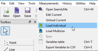

Hello and welcome to the Seamly forum, @RachaelShaw7
I’d suggest that you create a new Individual measurements file and (after closing the pattern file) import the measurement areas used in the pattern into the new measurements file: Menu > Measurements > Import from a Pattern. Point to the pattern and hit OK.
Then enter your measurements into the areas listed.
After that, you may open your pattern and load your individual measurements: Menu > Measurements > Load Individual.
The pattern should adjust to your individual measurements and you’ll be able to start designing your patterns from the basic basic patterns in the file.
If you have any problems, please don’t hesitate to let me know.
