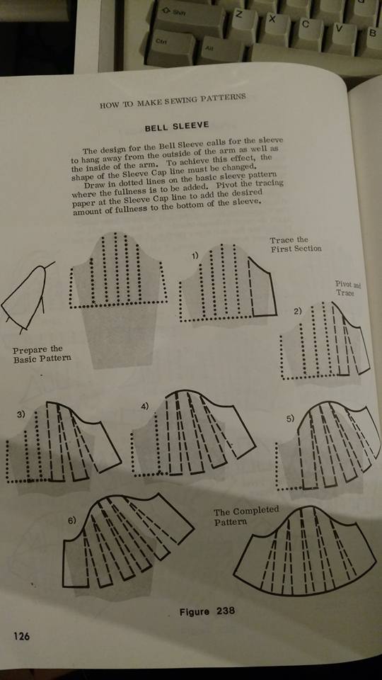

I was about to create a new topic but I just found this one. I am working on bell sleeves and cape sleeves as an example of sleeve variations. I will look at what @slpencer told @Barbara
The Rotate tool can implement the slash and spread technique. Have you seen this video? This example shows the slash and spread method to rotate upper corner of the bodice, using the Rotate tool.
because that is probably the way to go at least for the bell sleeve. I will give some thought to the cape sleeve because my current approach has been to find a way to ā€œmirror imageā€ the sleeve curve and make it convex before building a new sleeve to hang from it. (yes, I see that mirror image is an instance of pivot and I am not convinced yet that is the way for me to go)

@grace could you write up the names of the points you used in the first rotation? I am sure I can figure it out from there. I have been gone on a cruise so not thought about this in 2 weeks, but I was having difficulty selecting anything other than a single line or single point and seeing how the automatically generated extra point can be used to draw the rotated section. (I am assuming that the example here is a progression of -10 degree rotations). the use of different color lines is also helpful.
thank you very much for your help
I’ve created a pdf with the instructions for the Bell Sleeve: Bell Sleeve.pdf (725.1 KB)
Here are my training files :slight_smile: Learning pattern - Bell Sleeve.val (45.0 KB) Women 12 measurements.vit (1.1 KB)

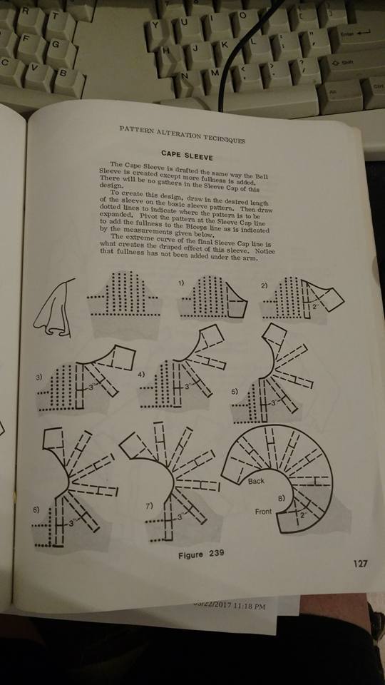

The Cape Sleeve, I did in the same manner, just with more slashes and more degrees between the sections. In my option, it wasn’t very successful but that is perhaps because I have no use for it at this point. I just wanted to see how it works. It uses the same measurement file above.
Learning pattern - Cape Sleeve.val (71.8 KB)
Oh, I also made a mistake in it. There is a solid section from ShoulderTip to Elbow. I made a slash there.

Yes, the Bell Sleeve pdf is the only one that I made and the technique that I used is the same, only the degrees are more in the Cape Sleeve. I gave my learning files and measurement files so that anyone interested can open them & see for themselves. Please tell me if I’ve made a mistake and where so I can fix it, because I don’t see where.
