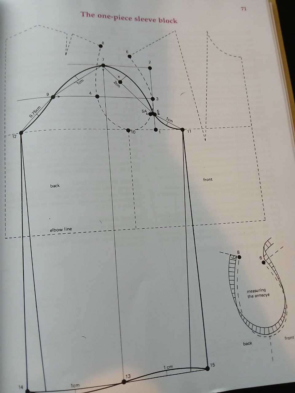

The Aldrich book that I’m slowly but surely working through instructs me to construct the sleeve pattern based on the bodice pattern. I’m wondering what the best way to achieve this in Seamly would be. When I create a new draft in Seamly, I still have access to the same measurements I used for the bodice pattern, but I lose the ability to interact with the points from the original bodice draft. As far as I can tell, this interaction is necessary when following the Aldrich method precisely. For example, point 5a needs to be constructed by finding the intersection between the armscye and point 5. Additionally, points 6 and 8 are referenced, but they are part of my bodice draft rather than the sleeve draft. Doing both in one draft seems uhhh… messy. Any tips or workarounds?

I would suggest that you put the bodice into a group so that you can close the eye whenever you want to.
Change the Default label lettering to “B”
And save it:
(You will have to set the lettering again every time you open the pattern because the 1st drawing board reverts to A when you close the pattern.)
You may go ahead and rename the labels at the shoulder tips and the armpit to B6, B8 & B10 to make things easier for you, but then you will need to change any formulas that you used the points in. You till be prompted to change them, so remember the original label and just type in the change in the formula, replacing the old label to the new label.
Once you’ve done this, you’ll be good to go. :grinning:
Go ahead & draft the sleeve on top of the bodice. When you’re finished, you can close the eye on the bodice objects, create a new group for the sleeve & put all the visible objects that are sleeve-related into the new group.
Everything will be nice & tidy and you can open whichever group you want to view, individually.
If you get stuck, please don’t hesitate to ask. I’ve just completed the same sleeve, from the same book, for a project that I’m working on.
