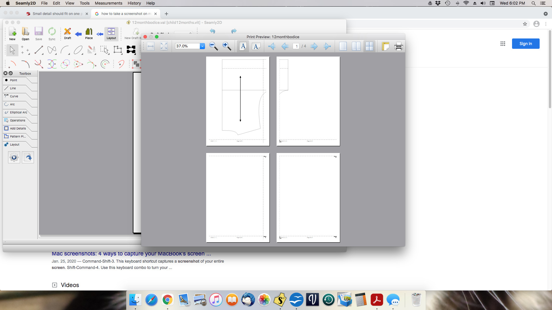

I have a question about why a small detail that will physically fit on one page of A4 paper gets split over two pages when I preview as a tiled pdf? Is it a margin adjustment that I should make? If I could shift the piece over a small amount it would not need two pieces of paper.
I have tried all the paper sizes in layout and I can’t figure it out why. In the larger paper sizes it tends to place the piece horizontally and still takes up two to three pages of paper. I have tried unchecking the rotate work piece but nothing seems to work.
It of course doesn’t need to be tiled, but I cannot seem to get it to just print directly to a page of A4 either. time to walk away for a bit I guess.

If you click on this icon, you can change the PDF settings. You can change all the margins to 0.25cm (this is the minimum that Adobe Reader needs). You can also check that the paper size is correct to what you are using.
If it still goes over 2 pages, then go back to the Layouts and change the margins to 0.25cm there. I always checkmark the option to Ignore Margins:

Normally, in the Layout board, those settings remain the same as your last settings (which is really handy, since I can never remember them), however, in the Preview PDF, it always reverts to the norms set in the program. This part doesn’t bother me, as I always have a bit of a fiddle around to see how I can get this to print the least pages possible, but it would be nice if the margins were set a bit narrower.
Is this something that appears to be hard coded for a minimum value?.. like the .25 cm you mentioned? If so that seems like an easy fix… or even make it a pref.

That said… In the Tiled Preview Page Setup… The paper size is taken from your OS printer settings. I have no idea where the 10mm margin settings comes from, but I do think that it’s hard-coded into the Seamly2D program, because I don’t get it in other programs.

Yes… When I got home I checked, and the paper size is taken from the printer default paper size. And yes… the 10mm is hardcoded - I researched that awhile ago. What the app doesn’t - (or can’t?) save is printer specific settings - like my Canon’s “borderless” setting - which basically disables the margins.
At any rate… I find all the “margins” to be rather confusing… as there are 3 margin settings… the layout, the PDF, and the printer itself. Not even sure what the layout margins are for, for they don’t seem to apply if you’re going to use a tiled PDF on a printer VS plotting on roll paper… thus the “ignore” margins. Basically the layout margins would only add more margin area to the “outside” tiles of a tiled PDF.
