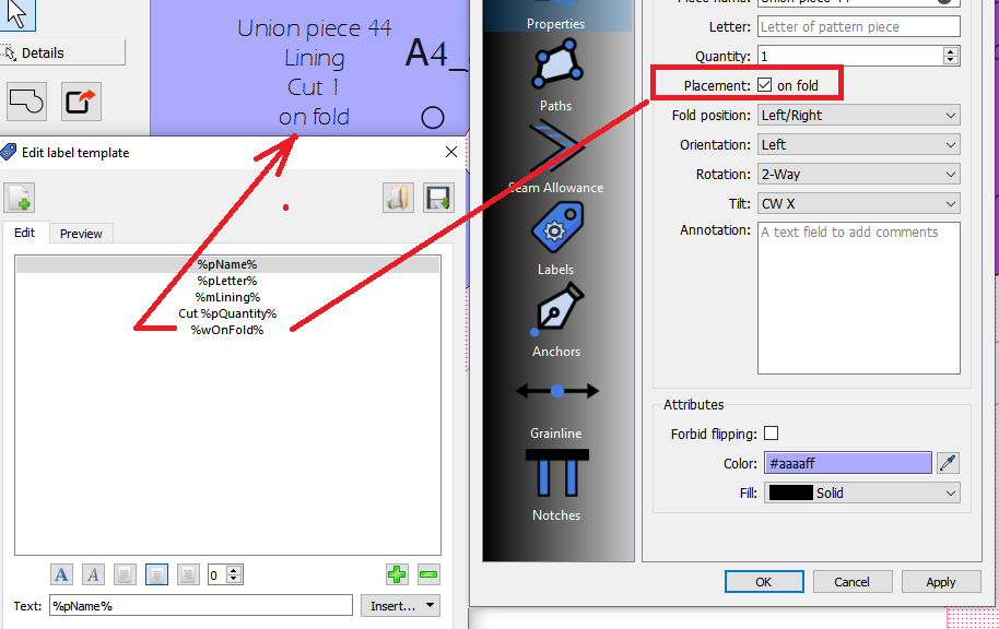

On Fold:
If the On Fold checkbox is checked, and a label template contains an On fold text placeholder… the On fold text appears in the labels. Yes, I know, it’s rather convoluted, not my doing.

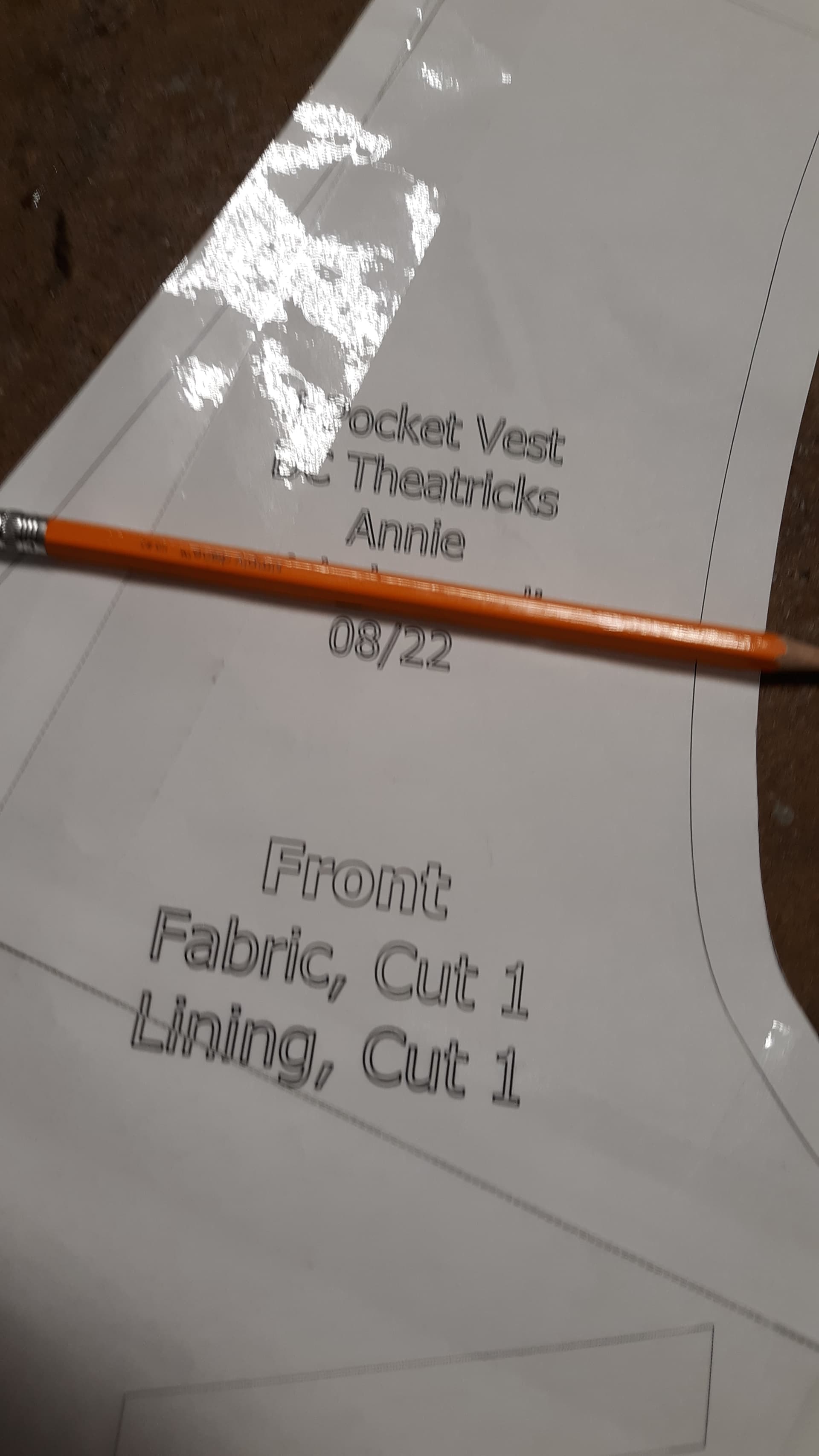

Other than zooming way out in draft mode, I don’t have any issue with seeing or exporting the lines.? I haven’t changed the line settings since I implemented the line attributes, and I could see on screen just fine, and as you can see in the pic it prints fine… even though most of that project I used a plotter in which case the line weight is irrelevant as it’s dependent on the plotter pen width.
