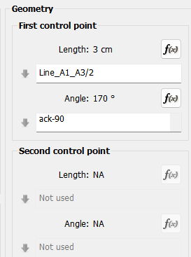

Question 2) Curve Handle : This is the square holders of which the function is modifying the curve manually on Spline Interactive and Curve Interactive Tool?

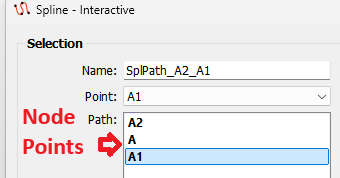

Question 3) Control Points : Guide Nodes? (So It is just a term you call the regular nodes which you can draw a curve based on It?

No. Curve handles can’t be used to add anything else to it. They are only indicators of the length and direction used in the formulas in the Properties of the curve. If there are no formulas entered, then you can drag them around anywhere.
Control Points are only points place at a certain length and direction in relation to other points connected to the curve that serve as control handles.
In Seamly we refer to them as Control Points (CP)… commonly referred to as as handles or handle points.
Yes. If you say “curve handle” we will lnow what you mean, but again in Seamly2D they will be called Control Points.
Seamly does not use the term Guide Nodes. It’s either a Node / Path → point or it’s a Control Point.
In Seamly - Curve Handles are Control Points.

What is normally called “Control Points” Seamly is calling them “Nodes” or “Path → Points.”
What is normally called “Handles” Seamly is calling them “Control Points.”
