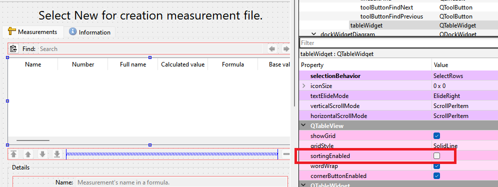

It easier than that… the sorting (in this case) is simply turned off for the SeamlyMe QTableWidget in the Creator ui form.
As a programmer you normally don’t have to worry about how to sort items - Qt handles that internally with whatever widget is being used. You simply set the sort on / off in the form or you can call the routine to sort the items in the code.
Something like this:
Altough you can programically tailor how each colum is sorted, sometimes the data does not fit the normal data model for the widget. A good example of that is how I had to subclass a sort routine to sort by color (icon) for the pattern pieces.
