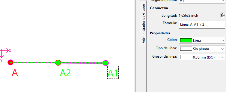

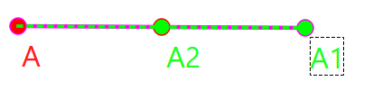

You don’t need to measure to place a Midpoint on a line (or curve). Just use the Midpoint tool (there’s also one for curves):
Click the 1st point, then the 2nd point, and it will create a point midway between the 2 points on the line.
You can then use this point to include in a piece path to use as a notch.

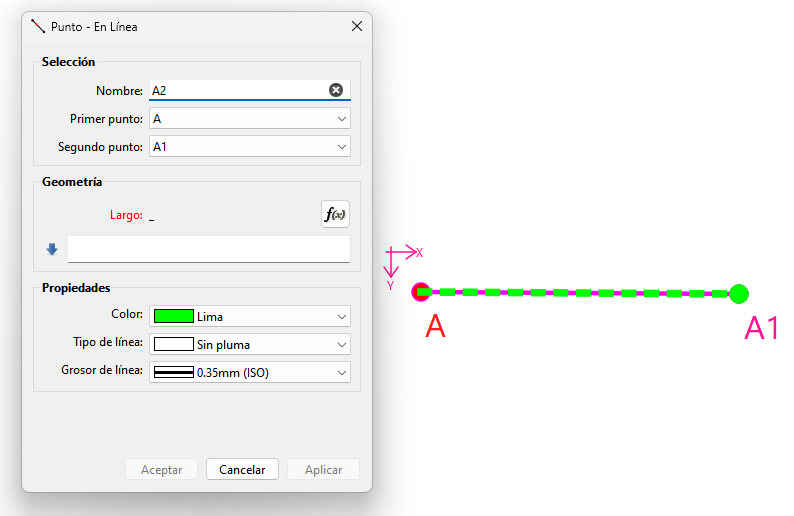

But… just so you understand how the app works… another way you can acheive the same result is to use the Point - On Line tool:
Select your 2 points:

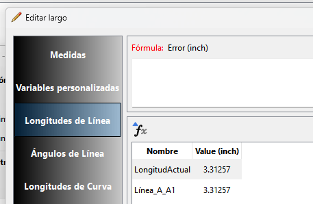

Then selecting the fx editor button for the length… select the Line length tab:
Then double click the variable for the line you want… here we want Linea_A_A1
Which places it in the formula box:

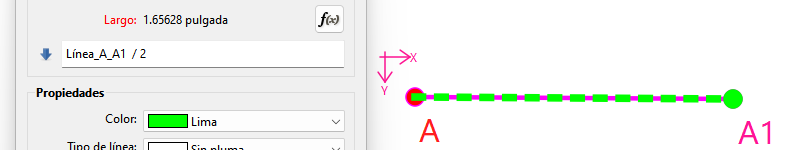

and then divide the line length by 2:

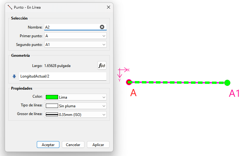

Click Accept. The formula is now the line length divided by 2:
Click Accept:
And now we have the same result.

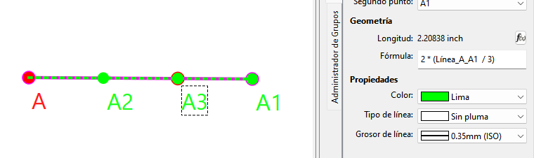

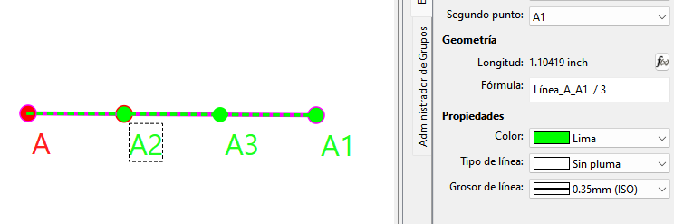

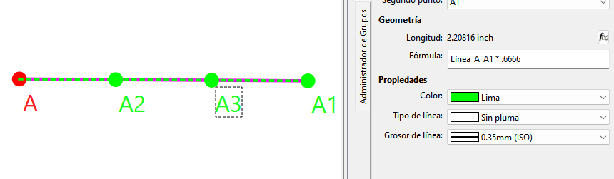

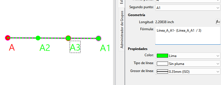

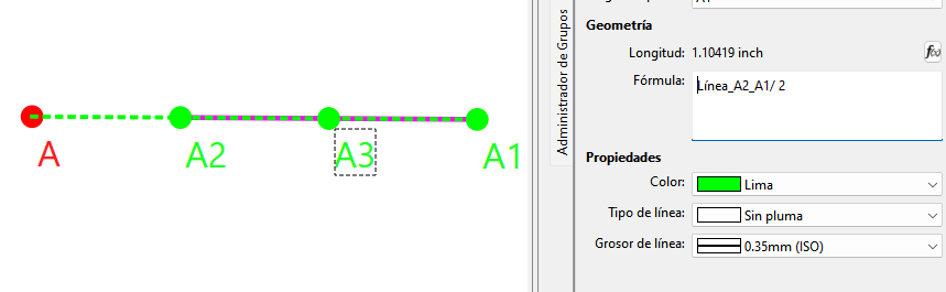

Let’s say you wanted to divide the line into 3rds:
or
or
or
As you can see you can get very creative with the formulas.
