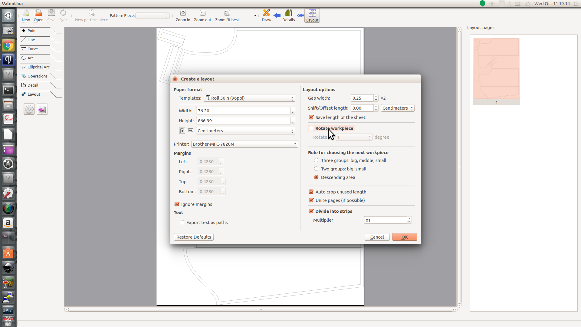

Hi @caychochang, How about trying this:
  • Check ā€˜Ignore margins’ (You can add margins in Illustrator)
  • Uncheck ā€˜Rotate workpiece’
My version of the program doesn’t look like that? I’m using version 6.0.409a is there a newer version I need to load?
Oops! My Ubuntu version is one version too far…sorry about that. Can you uncheck the Rotation box, that might reduce the number of pieces that get rotated - it doesn’t eliminate rotation, as some of the smaller pieces will be rotated to fit between the large pieces.
