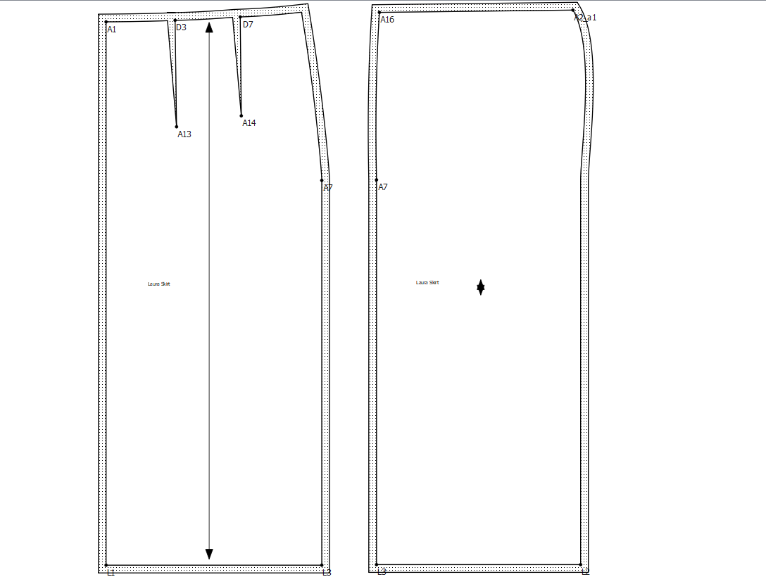

I’m nearly complete my first pattern :smiley:
When I make a new pattern piece (Seen on right), the straight of grain is super tiny and I have to zoom in to lengthen a bit, then zoom out to lengthen to desired length of pattern.
I would prefer if its just a sufficient length from the beginning, is this a bug or is there a setting for this??

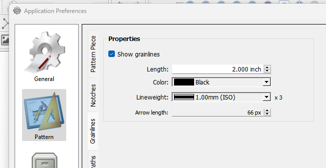

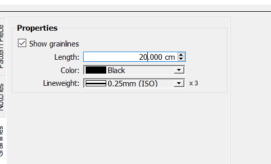

You can to set your defult preferences for the Grainlnes.

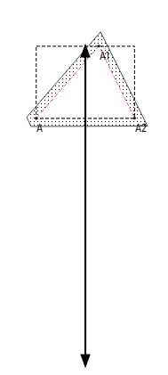

Keep in mind that at the momment - unlike the labels, a grainline will not auto resize to fit iside a pattern piece. You could end up with this if you set it too long:

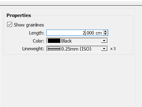

Is there a maximum that you can set? It wouldn’t let me type out anything larger than 20.
Here I am trying to type 25 but it just stays stuck at 2
Strange, I had to go & try it. Yep, it won’t take the 5 in 25. I have mine set on 15cm, so I’ve never noticed.

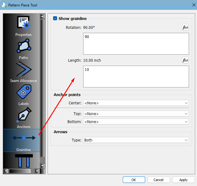

I normally open a pattern pieces property editor to lengthen or shorten the grainlines when I need to.

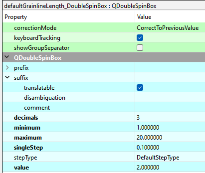

My bad. I must have figured that 20 “inches” was long enough for a max default value, not taking into account the pattern units could be “cm” or “mm”. The value of the box is currently set to 20.000 . :roll_eyes:
I’m going to make it so the spinbox dynamically sets the max based the units - like the notch prefs do.
Right… as pointed out I did not account for the units so the spinbox max is set to 20.000 regardless of the pattern units. :roll_eyes:
If course I’ll have a fix. :slight_smile:

Done. I also fixed the default label size as it had the same issue.
