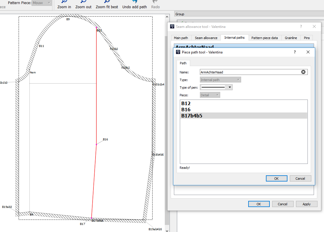

Strange line pops up in layout-mode
In Detail-mode:
In Layout-mode (And also in the print)
How can this happen?
Show your pattern file.
It looks like the program is trying to complete a closed path, from B17b4b5 back to the first point B12.
I have published fix. Should works now.
