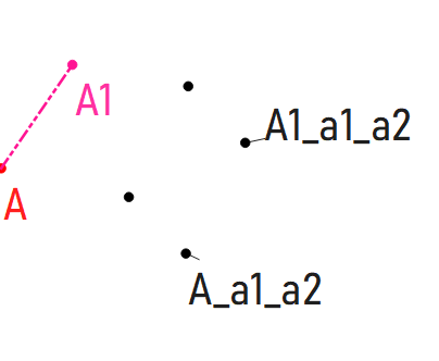

A_a1 and A1_a1 pointnames hidden:

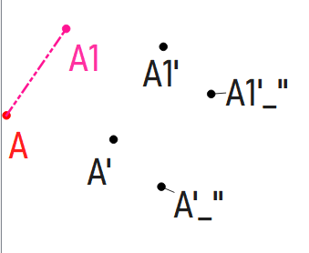

Or maybe creative suffixes to reduce the clutter:

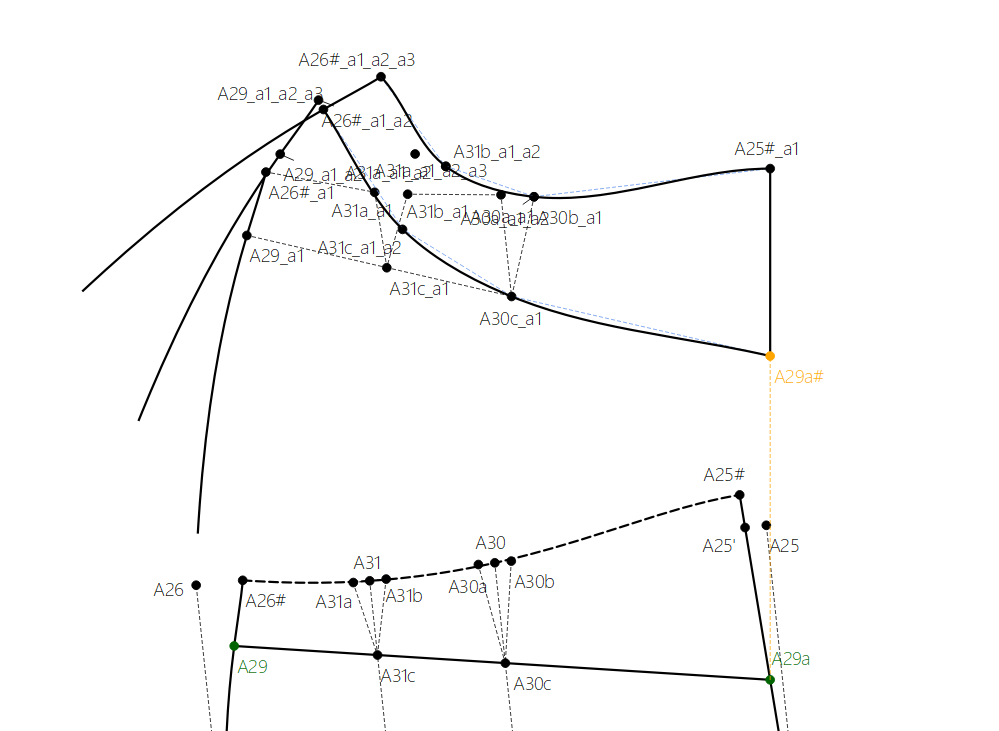

Also you can move the point names. Obviously this would be a mess:
