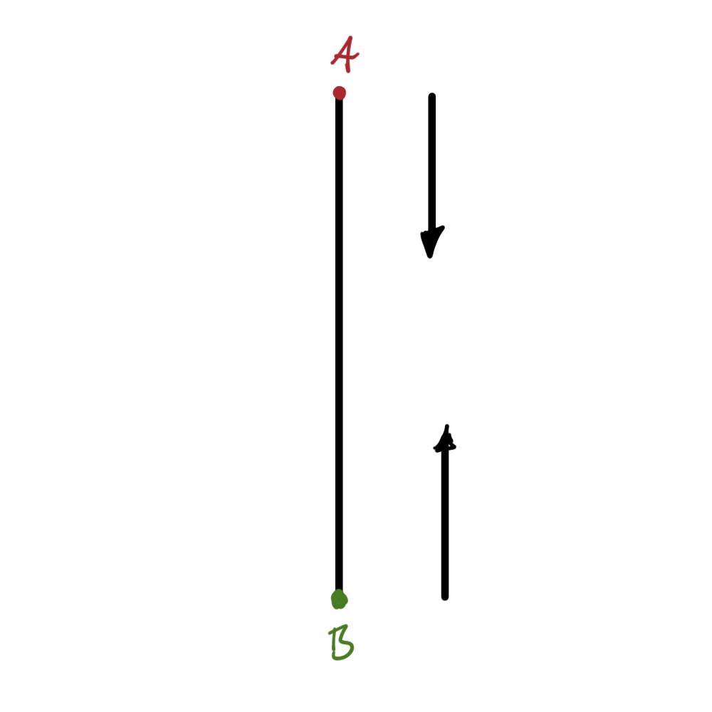

AND a nice Idea that i had, was that the order of the points in the term determin which angle you mean. Let me explain with a picture:
When you go from A-B the degree would be „0“ but if you go from B-A, the degree is 90. this could reflect on the term: for example here it yould be „ds:a-b“ = 0 or „ds:b-a“ = 90 And since a line could also be described as a curve , changing the order just adds/removes 180

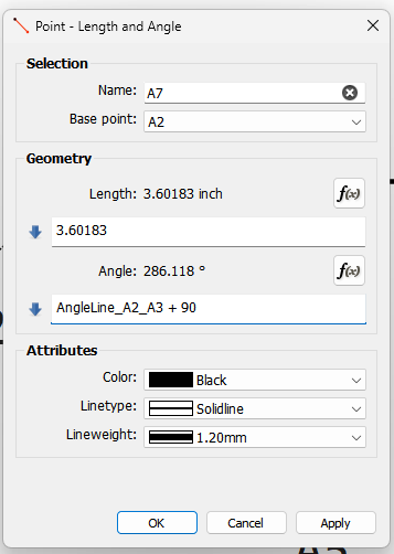

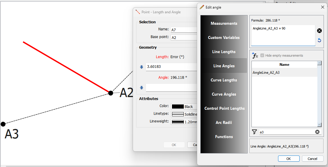

Or you can just use the FX editor… To add a new line with an angle based on Line_A2_A3 click the FX button for the Angle formula. Select the Line Angles menu item to display and add line angles to the formula. You can filter the list… I filtered by A3:
I added the Angleline_A2_A3… then edited the formula with “+ 90”. pressing OK adds the formula to the formula in the dialog.
No pasting required. And it’s translatable:

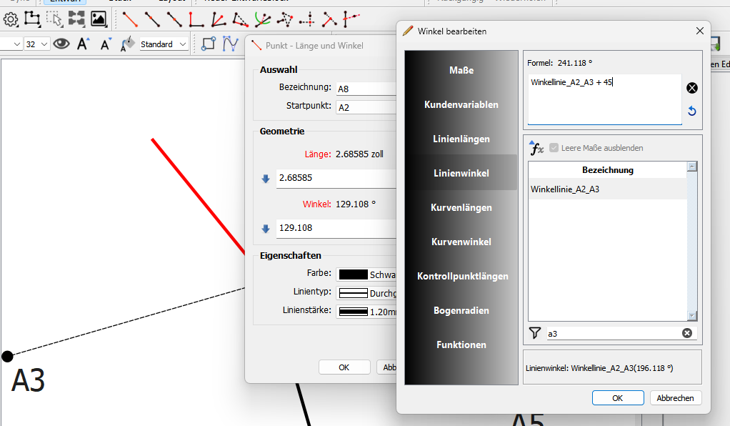

Maybe this is a translation thing but in your picture you can see how in “AngleLine” both “Angle” and “Line” is capitalized. And in german “Winkelllinie” is only capitalized in the beginning, even though when I want to copy the name of that line it is “Linie” with a capital “L”, so I have to go back and change that every time. This is not a huge problem I know, but a frequent one. The easiest sollution might be to make “Winkellinie” to “WinkelLinie”.

“Linie” being the correct translation was not the issue. The issue is that it is written not capitalized. In english you can just write “Angle” in front and youd have the Angle but in german you first need to decapitalize “Linie” to “linie” beforehand. That was my issue
Ok, I was wrong in my earlier description because it only applies when 2 words are joined to make 1 word. In the case of German, the 2 words are actually 1 word already, so it doesn’t get the capital L in the translations. So because the correct translation is being used, yes, you will need to change the capital L to a lower case l.
It is… I don’t see your point. The translation used IS "Winkellinie”. Here’s the source text in the seamly2d_de_DE.ts translation file.

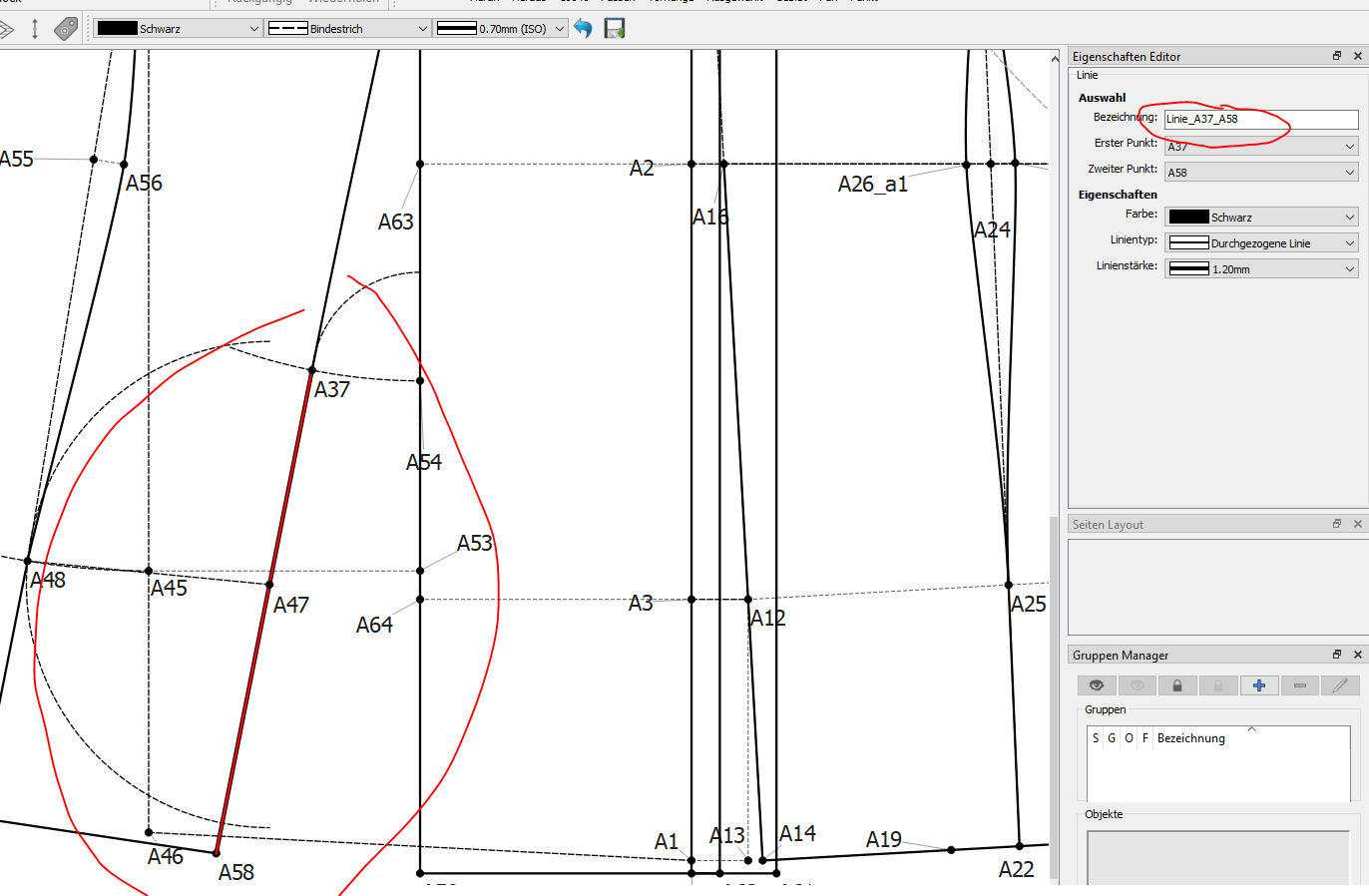

As I said, I usually copy the name of a selected line by copying it from the description.
But here you can see just selecting/hovering over an object can tell the program what it is called. Nameauspoup
