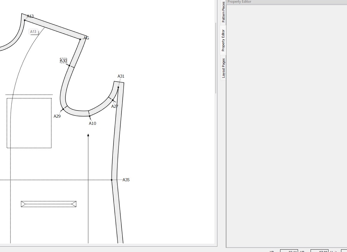

seam alloance1
My suggestion for seam allowance is that when I select the node, the property editor at the side will automatically show the usual seam allowance option for the selected node. Currently the property editor remains blank when I select any node.
Thinking back, you most probably mean the check box is not to specify the SA dimension, but to automatically show the SA that I already specified so that I don’t have to manually add the marking using external app.

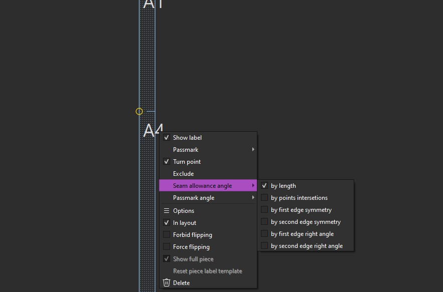

I’ve also added a context menu item to change the seam allowance angle type:
Screenshot 2025-02-27 211603
and just to be complete I’m working on items for Excluded and Delete… even though these would more likely be done from the Pattern Piece properties Seam Allowance->Paths as you’re looking at the path nodes list.
6 tykkäystä
Both are working now.
Just need to go back and have the SA Angle menu checkmark the current angle property.
