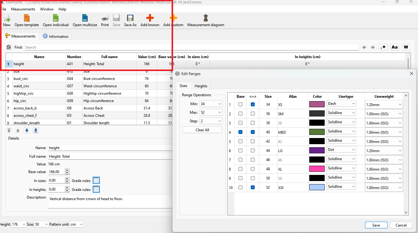

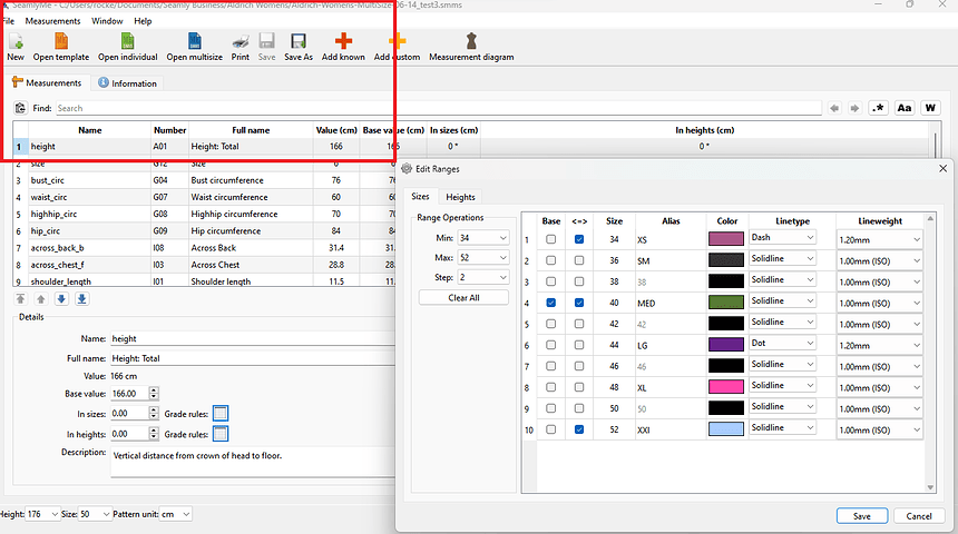

And that’s why the Qt default for Dialogs and Message boxes is the center of the screen. You have to jump through code hoops to get them to open elsewhere. Actually they ALWAYS open at the center… you have to code to move them to place them somewhere else… while making sure they stay on the screen. Opening at the mouse is even more problematic. For ex: With this dialog the only viable mouse positions to use would be within the red box. If the mouse is NOT within the box, you would have to calculate and force the position to be IN the redbox.

That said there’s is no “postion” arguments to a QDialog… it will construct a dialog centered… you can move the (as of yet hidden) dialog window… then show() it. The complexity in opening a dialog at the mouse position is having to calculate all the possible senarios to constrain the dialog to the parent window or screen, as Qt does not provide the functionality to do so like it would a context menu or drop down box. As I’ve pointed out… positioning a dialog to the mouse is generally not a thing. It’s a muscle memory thing. And chances are… as I pointed out in the screencap above… the dialog is not going to open at the mouse postion anyways once constrained.
