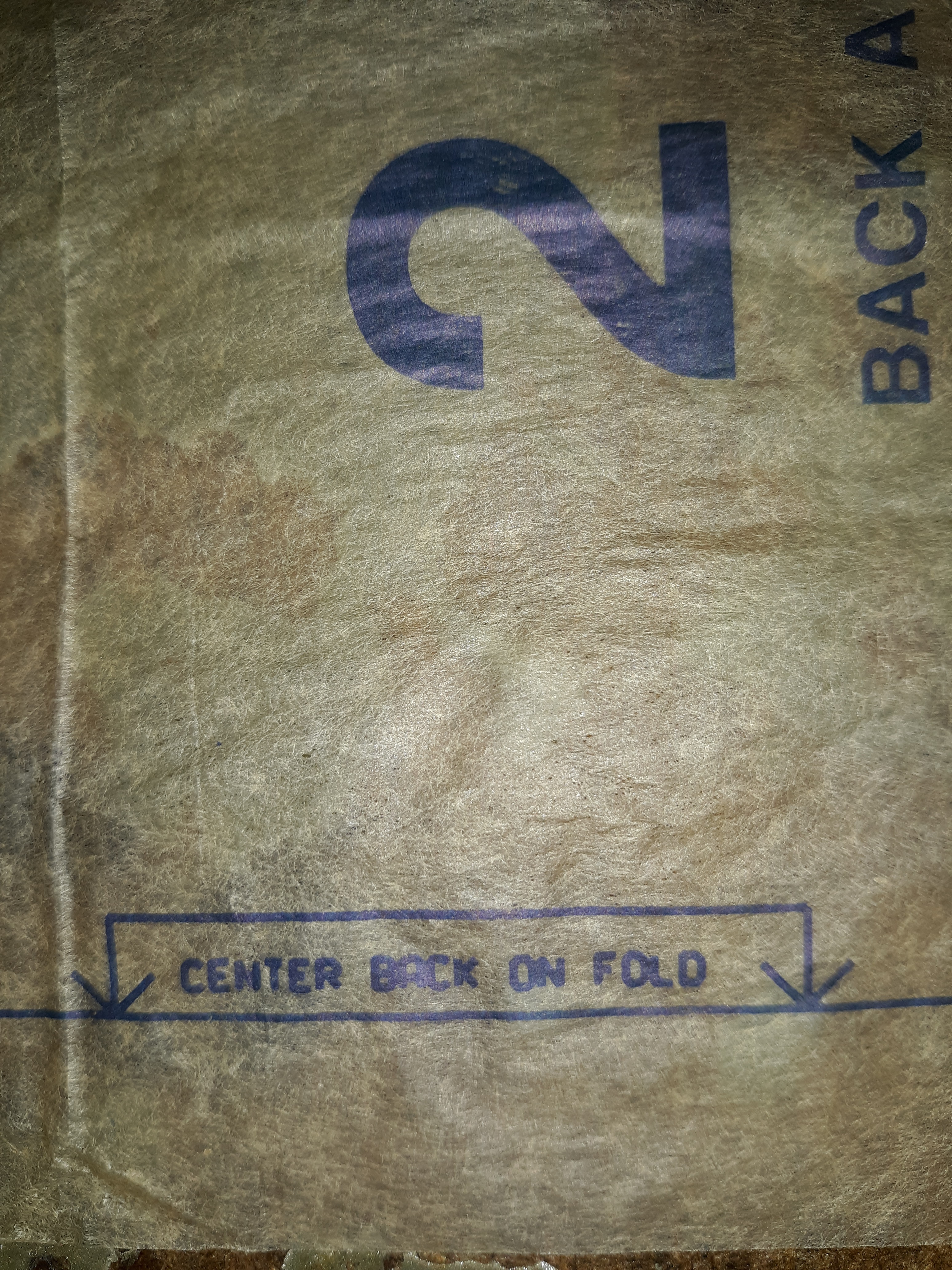

Do you think the “place on fold symbol” (with the arrows at right angles at either end) needs text to be part of it? I think it is a universally understood symbol. But maybe it isn’t🤷‍♀️
That would be great! To be able to add text where you want. Labels stay as they are but to be able to have a text box, similar to what one can do using “Mark up”to add text to photos?

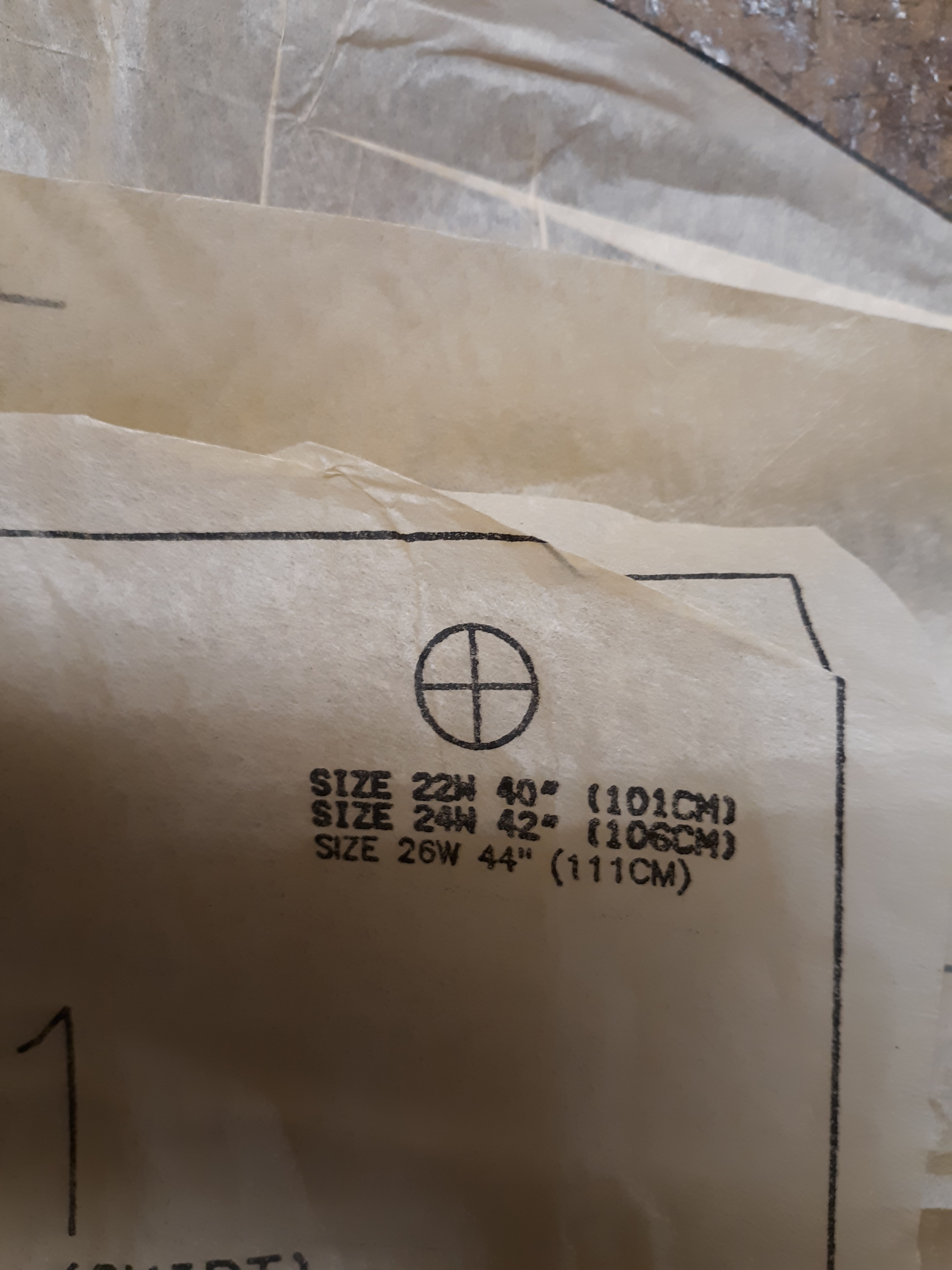

That is the universal circumference symbol used to indicate a bust, waist, or hip circumference.
This is from a Butterick medieval pattern showing the waist circumference.
But as you will note, it also has the measurement text… which is why I want to be able to attach text to symbols as well.
