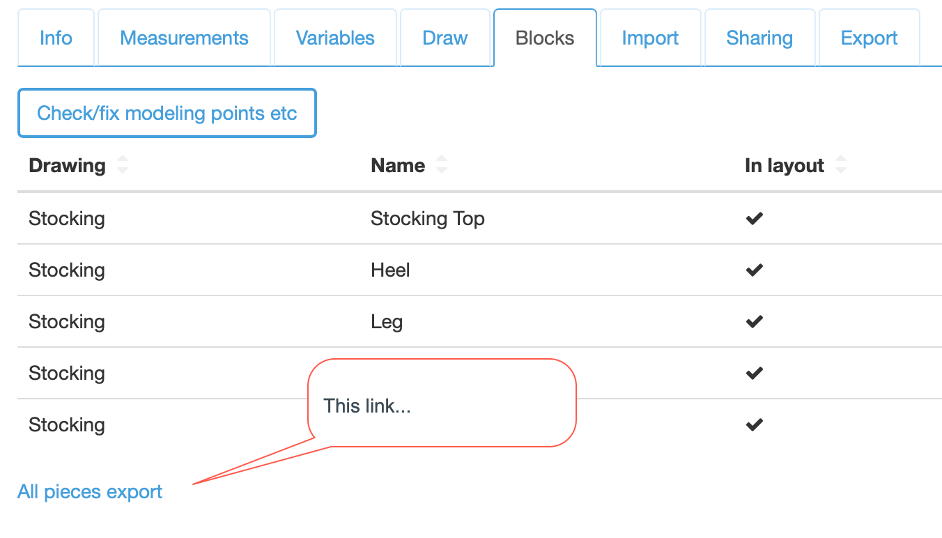

I have updated the site with the latest changes.
Currently it is still only supporting up to 0.6.1 format files. Hopefully i’ll be able to support new format files soon.
On the Blocks/Pieces tab there is now a link ‘All pieces export’’ which should render the pattern as SVG in the browser and allow a download. There are various things that need finishing. Please let me know if this doesn’t workk for you as this will help me resolve issues.
