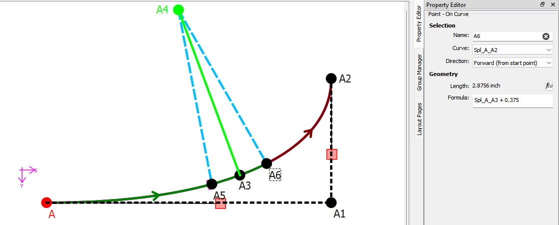

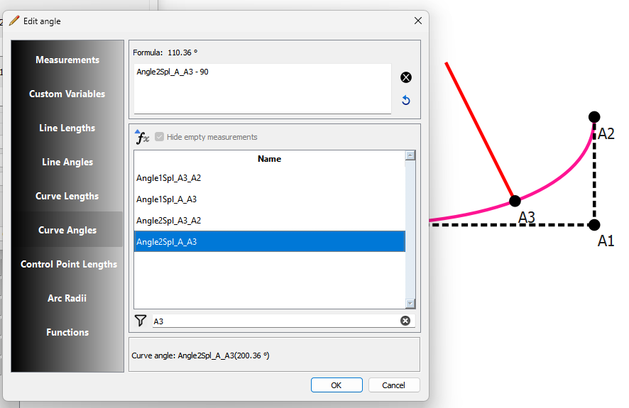

Yes there is. Here’s a simple curve spl_A_A2 with Point On Curve A3 . With a Point At Distance and Angle perpendicular to the point A3 on the curve. You simply use an angle formula using the second curve angle of the spline section minus 90 degs:
Note: You could also use the 1st angle of spl_A3_A2 + 90degs.
Note2: Internally under the hood the curves are actually a series of short lines… you can see if you zoom in real close. As such, that’s why we can determines the angle at the start and end points of a curve based on the angle of the start and end line segments. Which BTW is what the control points are also based on.

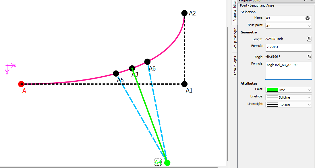

Therefore it’s easy to draw darts on a curve:
If you want the dart on the other side of the curve simply flip the Point A4:
