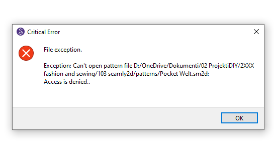

I tried that on Windows… but it prevented me from opening a pattern period. And the read only option in Seamly prevents you from saving period. No bueno either way.
It will require a new “template” attribute in the sm2d schema, and some new menu items - such as Save as Template… that will disable the save menu item when opened to only allow the Save as… option.

Confirmed same in Linux.
you are right, I was assuming :slight_smile:
we were always using this in the working environment with certain files: I see this must be a function of the program itself.
Yeah… I think Seamly is is set to implicitly try and open a file for read & write, and if it can’t it throws an exception. I think the app would have to check if it can write 1st… if not then open for read only. It would be simpler to just implement a template attribute, and Save as Template.
