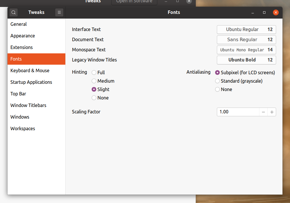

Another issue brought me back to this issue… does Linux allow to set a scale for the display of 100%, 125%, or 150% like windows does, and if so by chance are you using a larger scale factor? This would explain the larger font and elided button / label text.
Agreed, this isn’t really a code issue. It’s a desktop issue. Fractional scaling in Linux distros is a mess whether they use X11 (xorg) or Wayland. It becomes obvious that fractional scaling is an issue when dealing with HiDPI monitors, however this is an issue that’s been around for some time. The best “fix” may be to provide Linux users with a desktop icon for their distribution of the Seamly2D/ME appimage which sets the scale for running Seamly with an environment variable.
There’s a very good chance that that is something going on on my computers. I don’t remember where all I poked around while getting my computers set up, but I do like a larger form factor when it doesn’t mess up my layouts.
I’m vaguely aware of the HiDPI issues, but it’s also the (Windows) font scaling that is something I didn’t think of being concerned with. Agreed it’s a desktop issue, but something that can be dealt with now knowing that text may be scaled to 150% by the user.
