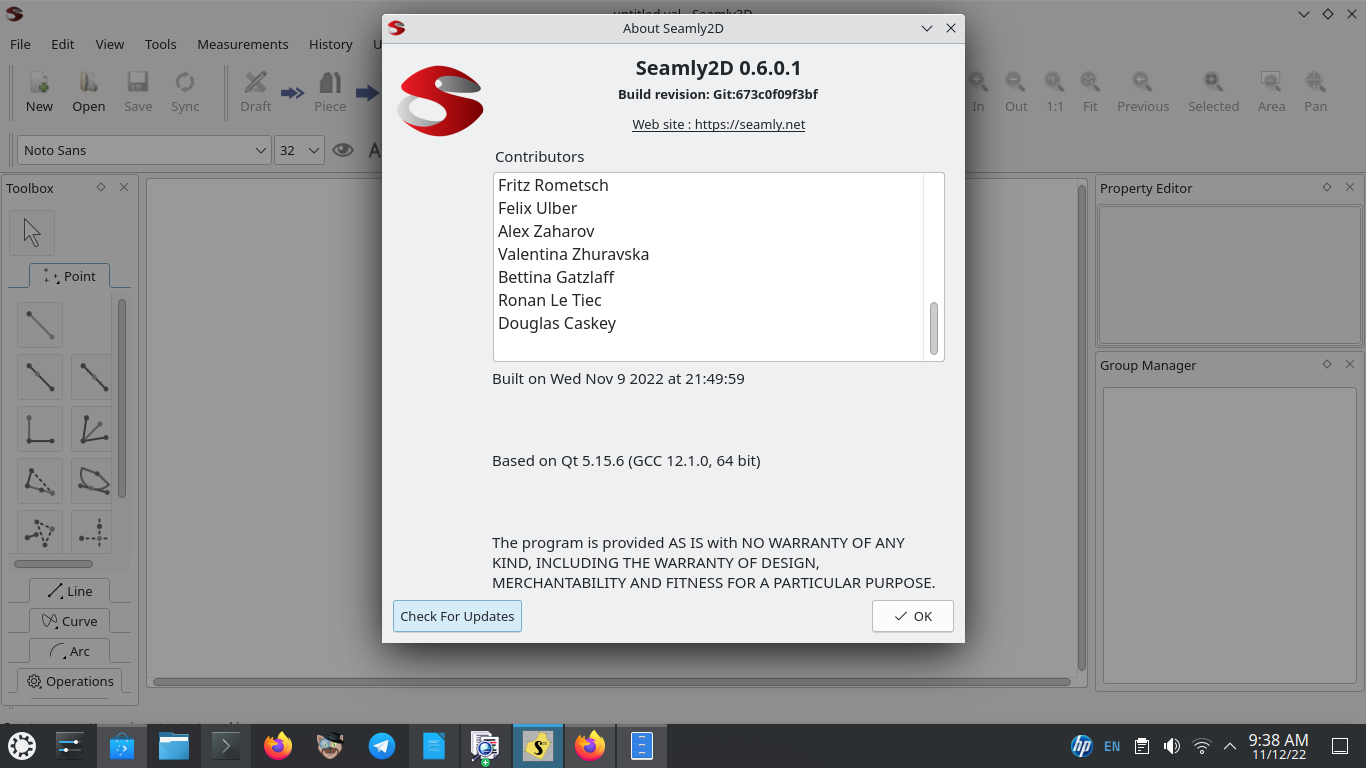

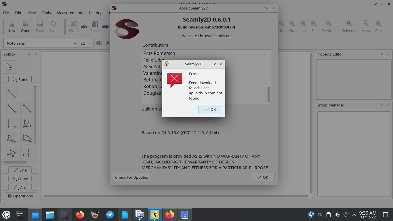

This is a screenshot showing the version.
Maintainer of the Flatpak here. Thank you for testing! Please provide your feedback here, more than happy to fix if possible.

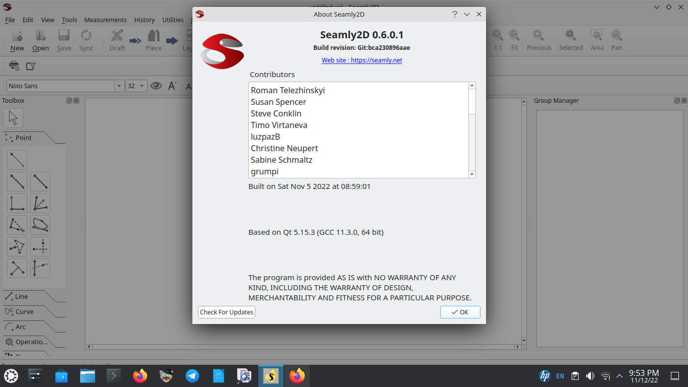

I’m curious as to what you see in the screenshot? I see qt ver 5 15.6 when the app is coded for 5.15.2?
That is one reason I included the screenshot. Clearly there is a difference in the flatpack build and the most recent appimage build I found at github in the main seamly2d repository. This screenshot is from the appimage (Nov 5). I assume there was no major difference in the code.
Shouldn’t be… but my understanding Qt 5.15.2 is the last free ver so the issue I see is IF for some reason 5.15.6 introduces any bugs, I / we have no way to debug that. In other words we’re at a max version wall unless someone is going to start paying for licenses.
I saw in the workflows the reverting from 5.15.3 to 5.15.2… but I have no idea where the 5.15.6 is coming from.
I have no idea either about 5.15.6, It is simply what showed up when I pressed the help option on the flatpack release

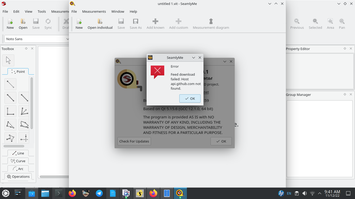

The “check for updates” under help does not work in Seamly2D. The same is true in SeamlyME.

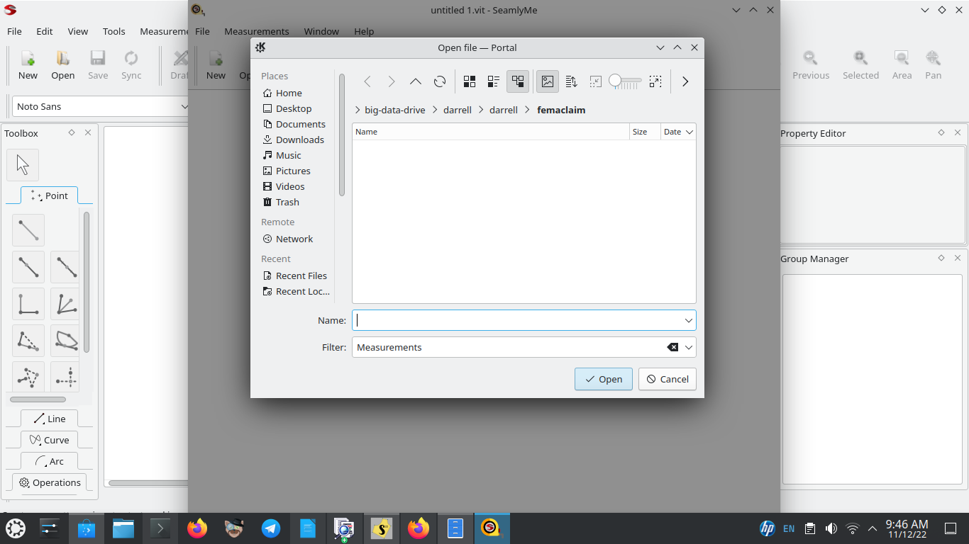

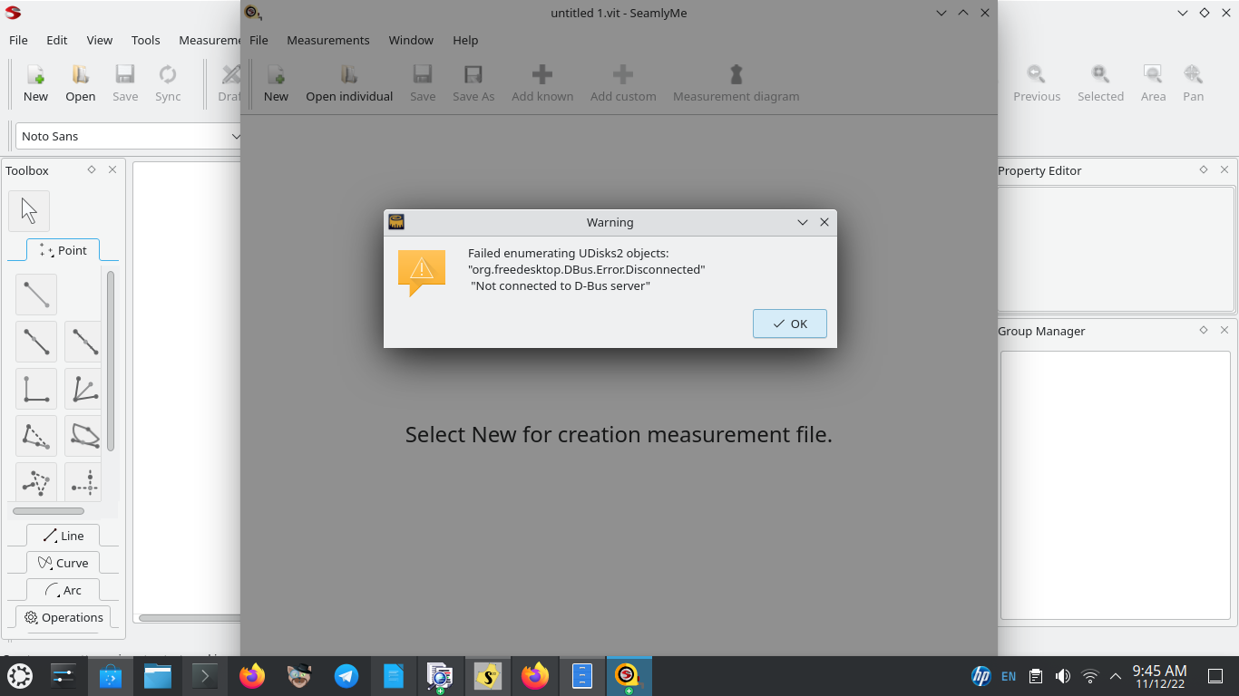

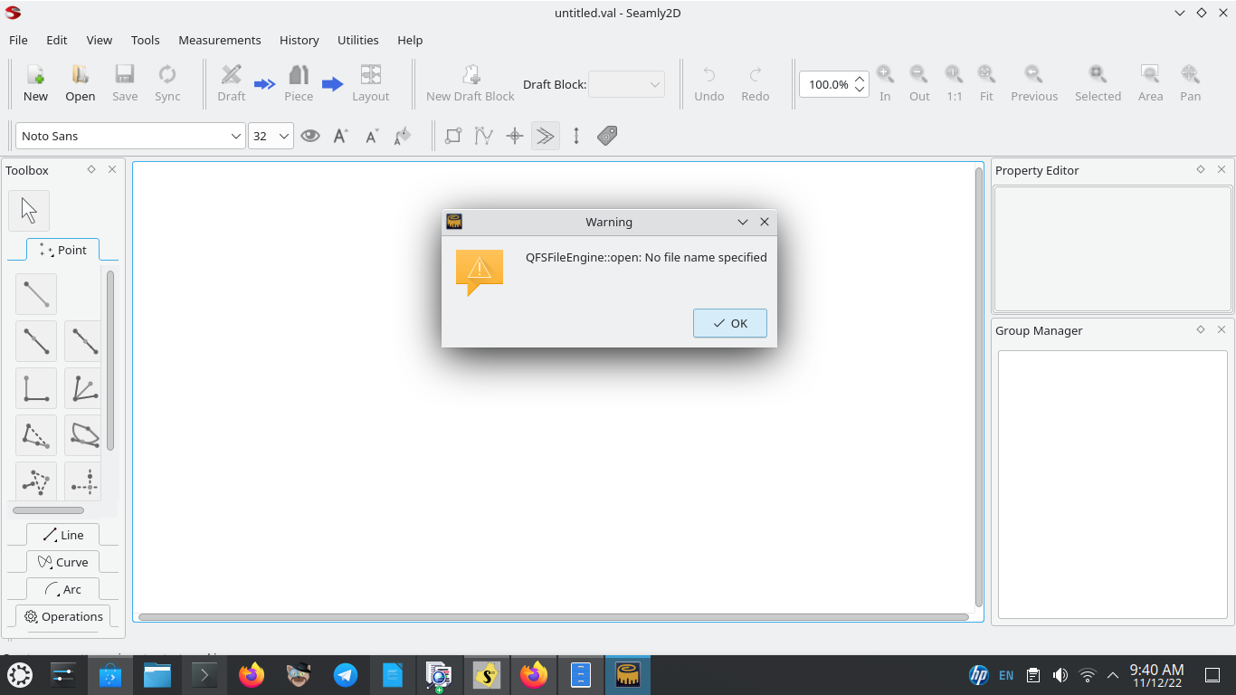

There are several minor file system related errors when opening SeamlyMe and attempting to create a new measurement file.
It appears that the file paths set in preferences in SeamlyMe are not used and that after clicking “ok” through the errors, the path is set to whatever path the user had open last. The “installation script” that I hope will be created will set environment variables and fix this.

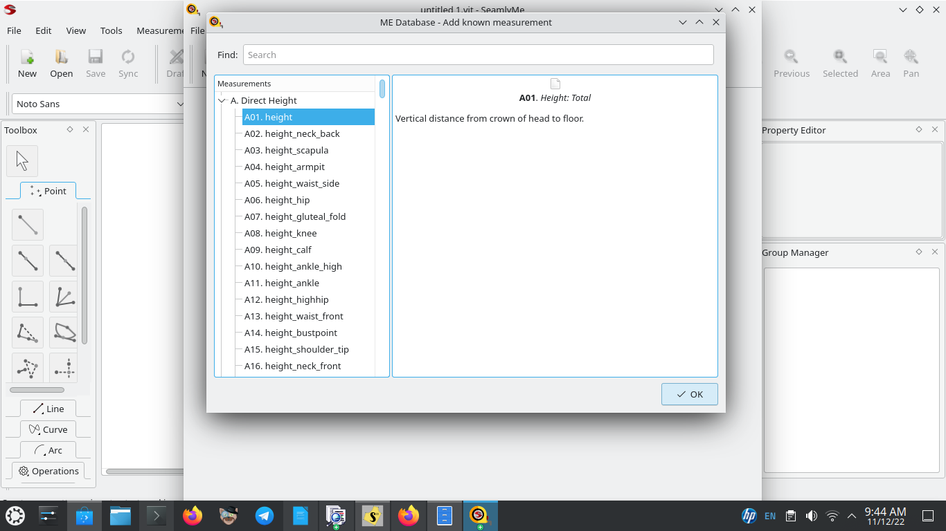

The measurement diagram is not displayed, both in the “database” option and the individual “add known” measurement menu selections. This may either mean the diagram file was not packaged into the flatpack or not opened correctly.
@AnnaFields thank you for the screenshots of the issues, I will take a look so that I can get them fixed from the flatpak. For the updates: As Flatpak itself will provides updates, the buttons can go, just need to check how.
Regarding the Qt Version, @Douglas: The flatpak uses the KDE flatpak runtime, as that also contains Qt in a relatively new version. This is built from source, thus slightly newer than 5.15.2, thus we have 5.15.6 + some patches from the KDE.
For more details, see flatpak-kde-runtime/org.kde.Sdk.json.in at qt5.15lts-22.08 · KDE/flatpak-kde-runtime · GitHub which references eg for qtbase from a kde git mirror.
I think this is a problem with the linux make files. The diagrams are certainly available in the source, but my home-build doesn’t have them either. I can’t remember when they disappeared, but there was a thread about it a while ago.

The check for updates has not worked since forking since wherever the releases were stored is no longer there. The app uses the 3rd party fvUpdater. I have updates to the About dialogs in the works, and I will either see if I can fix the updates or remove the Check updates until we can figure out where stable releases are to reside.

@Douglas - According to our buddies at Qt, we can run our code on qt v6 if we want to, on our community license. Qt v5.15.11 is the last version before the big changes to v6. Once we get our 5.15.2 builds created for all 3 OS’s, let’s update to 5.15.11, then let’s go for v6.
@Douglas - The latest stable releases reside at https://github.com/fashionfreedom/seamly2d/releases/latest
Probably the easy path forward here is to put a link to our github releases/latest URL at the 'Check for updates". When the browser opens to the github download releases page the user can click on the file they need to download it. Simple.
The latest updates to the .yml build files uses the “ubuntu-latest” server, which is now Ubuntu Jammy 22.04 LTS. The default Qt version on Jammy is 5.15.3. The latest updates also removed unneeded dependencies which makes the executable smaller. :+1: :+1: :+1:

I’ll get on the Flatpack testing later today. The Flathub build service is apparently using a different version of Qt, v 5.15.6. It’s probably not a significant change from v5.15.2 or v5.15.3.
