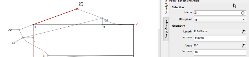

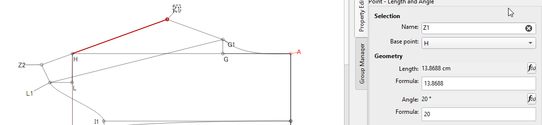

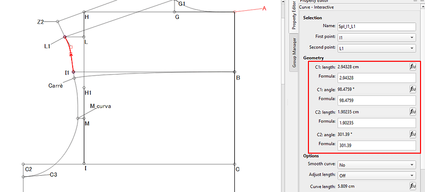

Part of your problem is this:

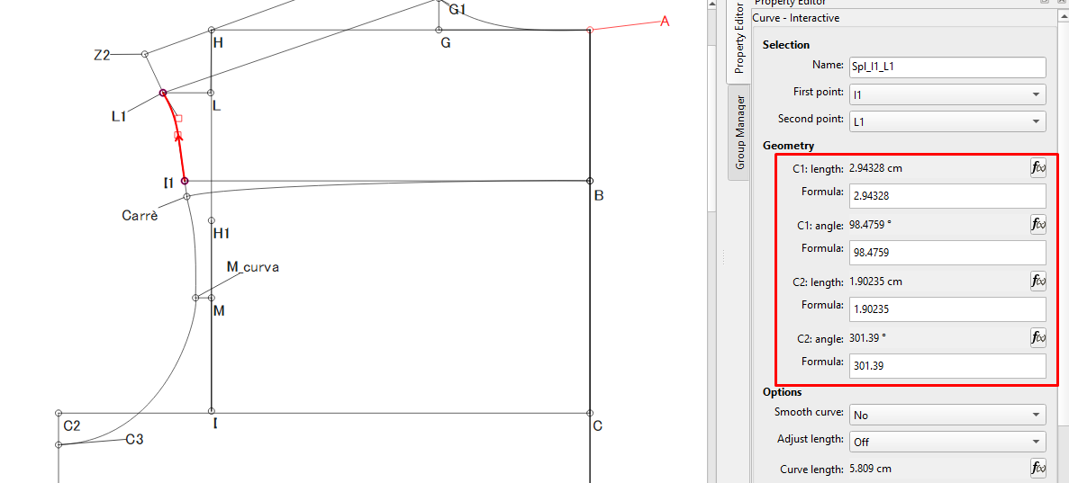

The curve handle lengths and angles are just dragged around and they look correct for your measurements. However, if you don’t connect them to actual items in your pattern, so that they resize and change angles according to the pattern, it quickly goes a bit crazy when you load other measurements.

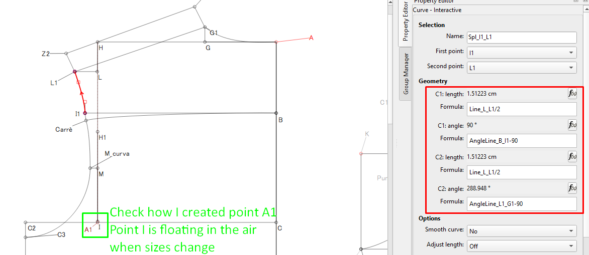

In this image, I’ve created formulas for the curves so that, regardless of the size, the curves should adjust smoothly.

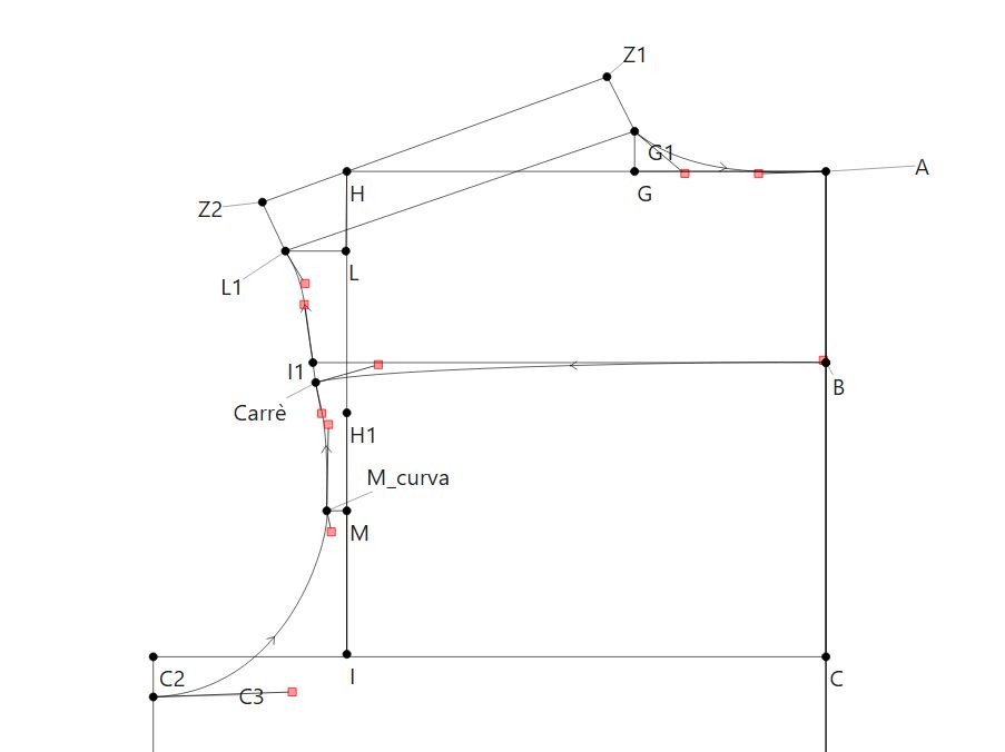

If you look at Point A1 that I created, you can see that it actually connects to the line C to C2, so when you change the size, line A to C will probably also change and point A1 will adjust, as well.

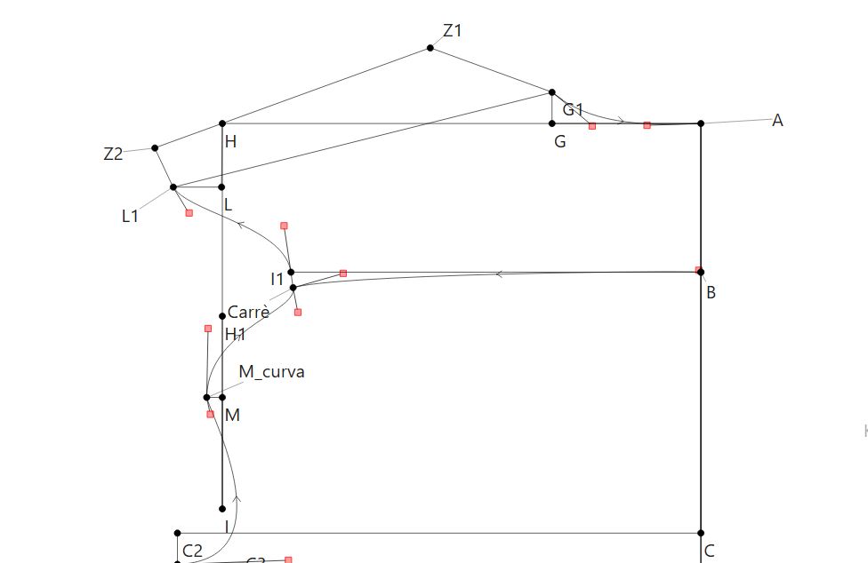

Now that I’ve changed the measurements to Riccardo’s, you can clearly see that point I is floating in the air.
This is another example of points floating around on their own:

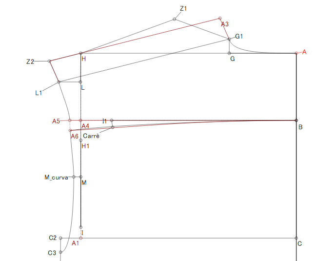

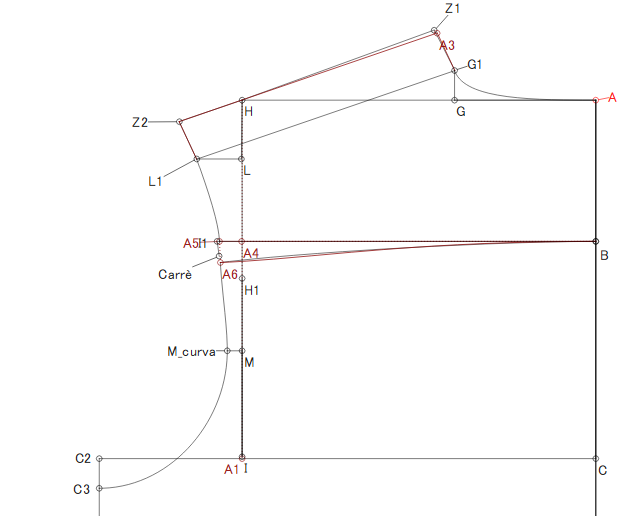

After a whole bunch of entering formulas & connecting parts, I’ve managed to come up with something reasonably respectable for Riccardo:
Here is the pattern with your measurements:
As you can see, the new lines pretty much align with what you did originally.
Here’s your file back:
Prima camicia Burdo definitiva Ultima_fixed A1.sm2d (61.8 KB)
I’d suggest that you check Riccardo’s measurements, just to make sure. And then… Have a look at all of the added items in Red and familiarize yourself with the formulas that I entered and which tools I used.
